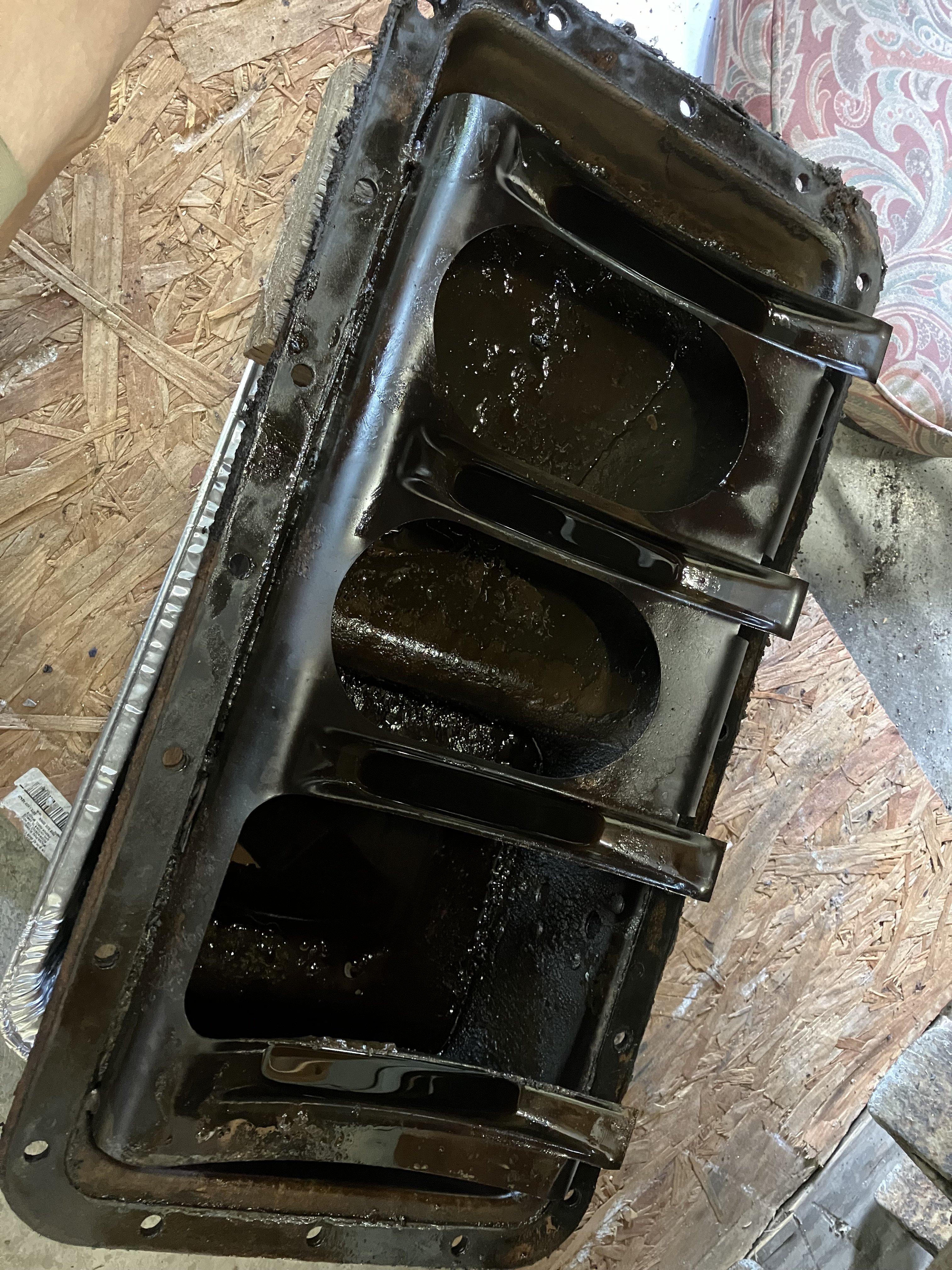

I've always used gas and then pour it into a jug and save it for making a fireLots of sludge, need to clean thoroughly before reinstalling. Was thinking rags and kerosene. Interested in hearing of any special techniques, especially to save time but get good results. I have a large plastic tub big enough to give it a bath. Thanks in advance
GerritView attachment 85431
Like was mentioned before, gas with a brush, then wash with a water hose. Last time I saw a pan like that, was on my 1934 chevy 6. The connecting rod cap had scoops to pick up oil pumped into the channel. Is that how your motor works for oiling rod bearings? StanLots of sludge, need to clean thoroughly before reinstalling. Was thinking rags and kerosene. Interested in hearing of any special techniques, especially to save time but get good results. I have a large plastic tub big enough to give it a bath. Thanks in advance

Yep, In my Model T, I call that the splash and hope oiling system.Lots of sludge, need to clean thoroughly before reinstalling. Was thinking rags and kerosene. Interested in hearing of any special techniques, especially to save time but get good results. I have a large plastic tub big enough to give it a bath. Thanks in advance

My choice would be Naptha. Sea Foam is a popular product for engine hygiene and a lot of us use it. Chemical makeup is Naptha, light mineral oil and alcohol, per the MSDS. I have used and trusted it for years. I recently bought a couple of older tractors that had been sitting for a long time. Sludge of about 3/8" had accumulated in the bottom of the pan, as measured by sticking my finger in the drain hole after I did what I said below.Lots of sludge, need to clean thoroughly before reinstalling. Was thinking rags and kerosene. Interested in hearing of any special techniques, especially to save time but get good results. I have a large plastic tub big enough to give it a bath. Thanks in advance

Thanks. Motor is a long way from starting and running.My choice would be Naptha. Sea Foam is a popular product for engine hygiene and a lot of us use it. Chemical makeup is Naptha, light mineral oil and alcohol, per the MSDS. I have used and trusted it for years. I recently bought a couple of older tractors that had been sitting for a long time. Sludge of about 3/8" had accumulated in the bottom of the pan, as measured by sticking my finger in the drain hole after I did what I said below.
Upon receipt of the equipment the first thing I did was to replace the oil and filter. Cranked up the machines and within a few minutes the oil was black again. I dumped a 16oz. can of SF into the crankcase and ran the engines for half an hour at idle. Drained the oil and stuck my finger in the drain hole again and the sludge was gone.....in suspension in the new oil. I changed the oil and filters again and the oil stays clear now. Since you already have the pan off I'd just go with straight Naptha and a paint brush.
And naphtha is reasonably cheap if you buy it as camp stove (Coleman) fuel. Not as obnoxious as gasoline and really cuts that sludge. I do all my degreasing with it, even as paint prep. steveMy choice would be Naptha. Sea Foam is a popular product for engine hygiene and a lot of us use it. Chemical makeup is Naptha, light mineral oil and alcohol, per the MSDS. I have used and trusted it for years. I recently bought a couple of older tractors that had been sitting for a long time. Sludge of about 3/8" had accumulated in the bottom of the pan, as measured by sticking my finger in the drain hole after I did what I said below.
