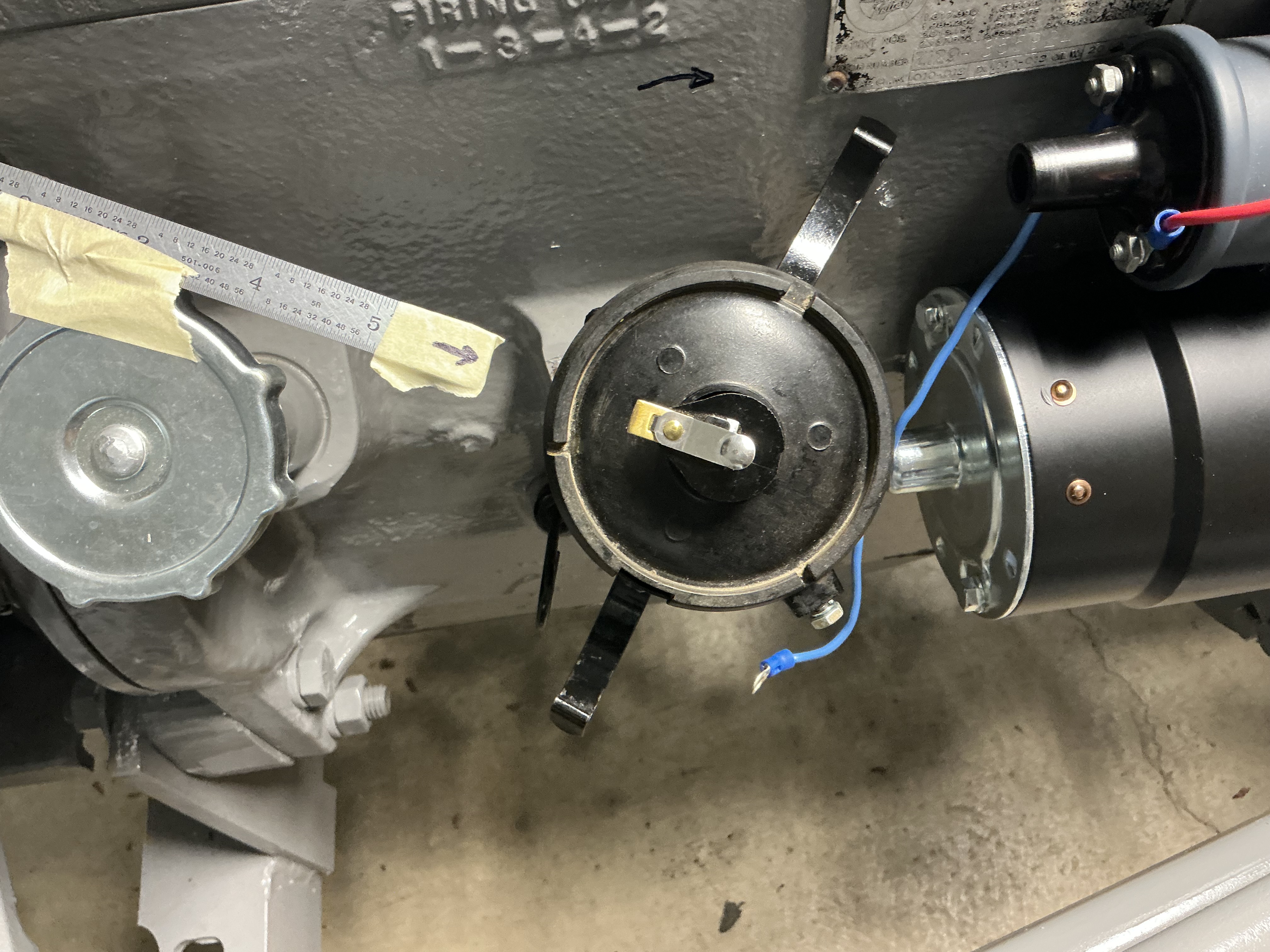

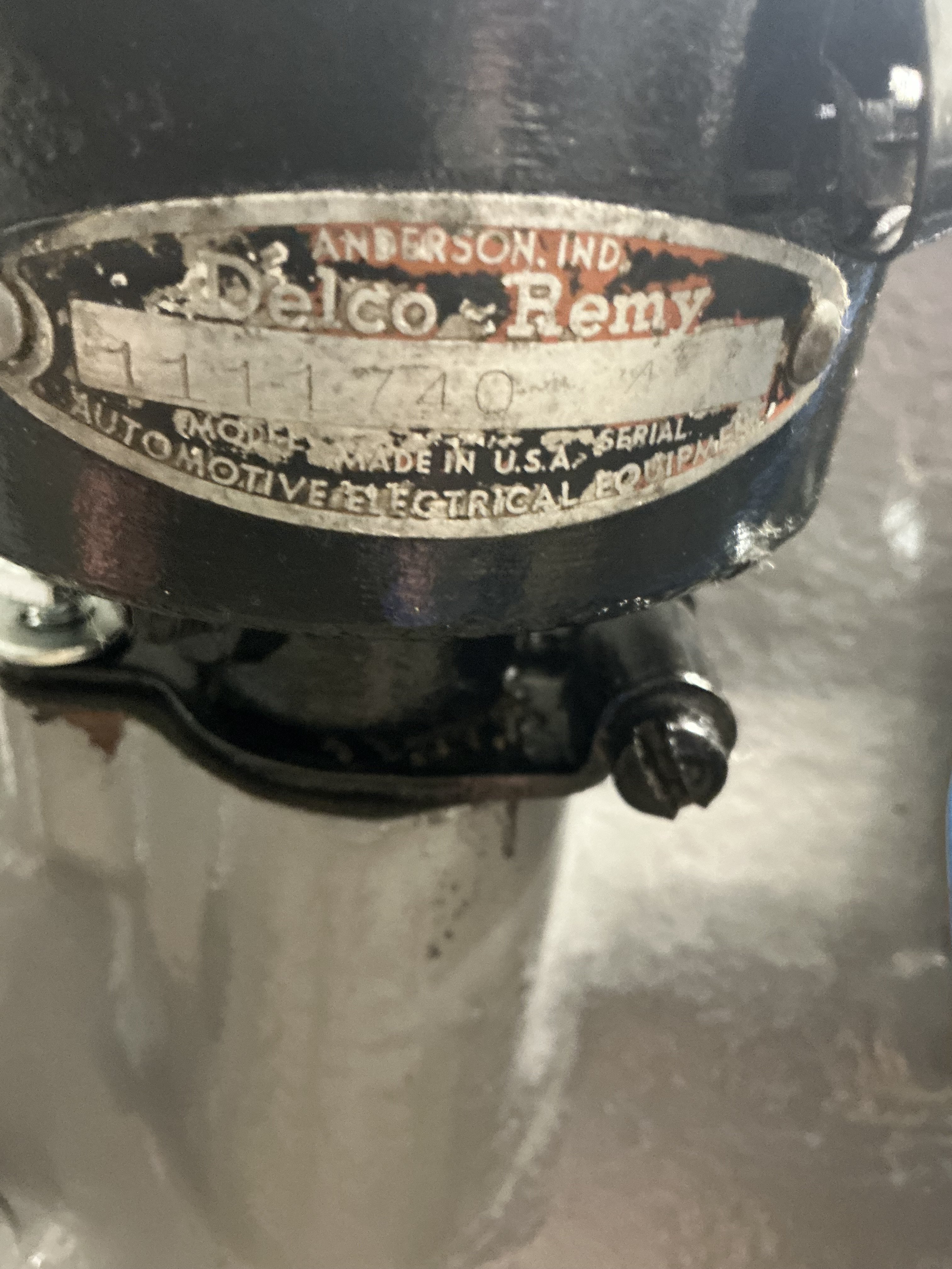

On my Ferguson TO30, likely similar to 9N, 8N and many others, I removed the Delco distributor after the tractor was running ok. On reassembly:
1. the flywheel was set to 6 deg BTDC on rhe compression stroke
2. the distributor was installed with the rotor pointing toward the #1 plug
3. the housing was rotated so the points just start to break (coil fires) on the cw side of the cam

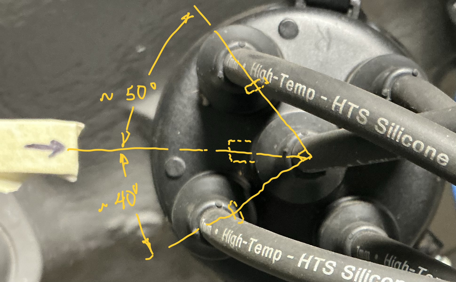

THE PROBLEM: Instead of pointing at a cap contact, the rotor points to the space 40 degrees from one and 50 degrees from the other.
The distributor wasn't disassembled
The point gap was set correctly
The centrifugal advance works smoothly
The breaker plate is on snug
The rotor key is intact

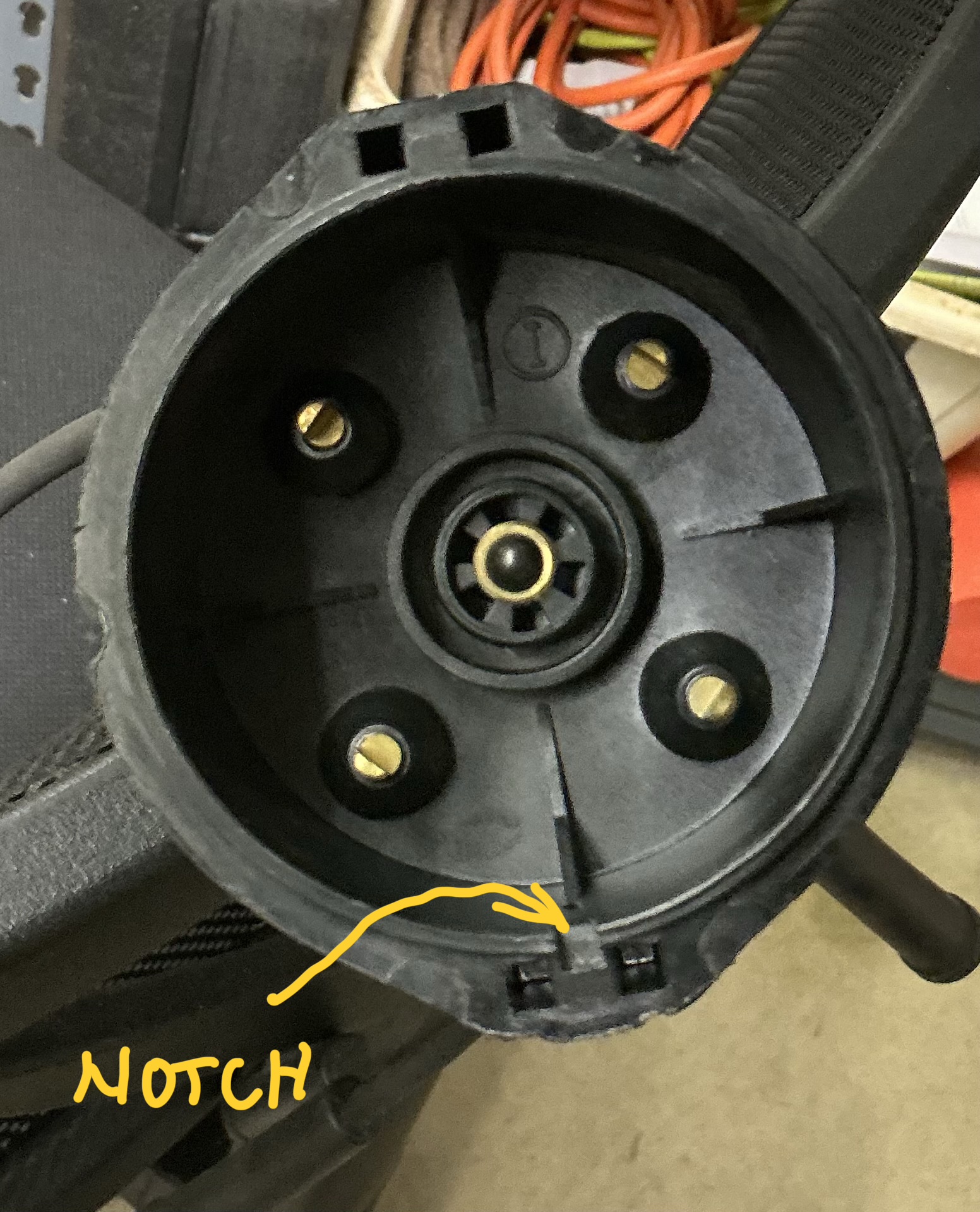

The cap only goes on one way and snaps on tight
The 6 deg BTDC setting on the compression stroke was triple checked
Since the housing locks the point and cap location together, indexing the shaft by a gear tooth simply moves the rotor so when you readjust the point break location, the cap moves with it.
Any ideas?

It was pointed to the #1 plug to put shortest wire in that general direction, really not too important since you can switch wires as needed. The internal cap contact moves slightly when you rotate the distributor to get the points into the firing position. That's when the rotor aims between the cap contacts instead of directly (or nearly) at one of them. If you rotate the distributor so the rotor points directly at a cap contact, the point cam on the shaft is about halfway between the lobes.
Sorry this may be obvious or idiotic, are you using the correct distributor rotation? The housing will be turned the opposite direction of distributor rotation to set it at the proper time of spark. At that position the points rubbing block will be rising up the progression of the cam lobe to the highest point where the points gap is set. Other wise you will have to check that all is correct in the mechanical advance, it would be odd for something to get out of position that far since you claim it was running correctly previously.
Makes sense, not idiotic at all. I've been known to overlook the obvious so I appreciate any cross checks. The crankshaft rotates clockwise and so does the distributor shaft looking down from the top. Once you install the distributor so the rotor aims at the desired cap electrode, you tighten the tie down screw. At that position, the points should be very near where they start to open. Then, loosen the swivel clamp and rotate the housing slightly clockwise off the cam, then counterclockwise until the points just start to open. The cap will move with the rotation but the rotor and cap electrode should still be pretty close. In this case, they're not.
Sounds like I agree with that methodology.
