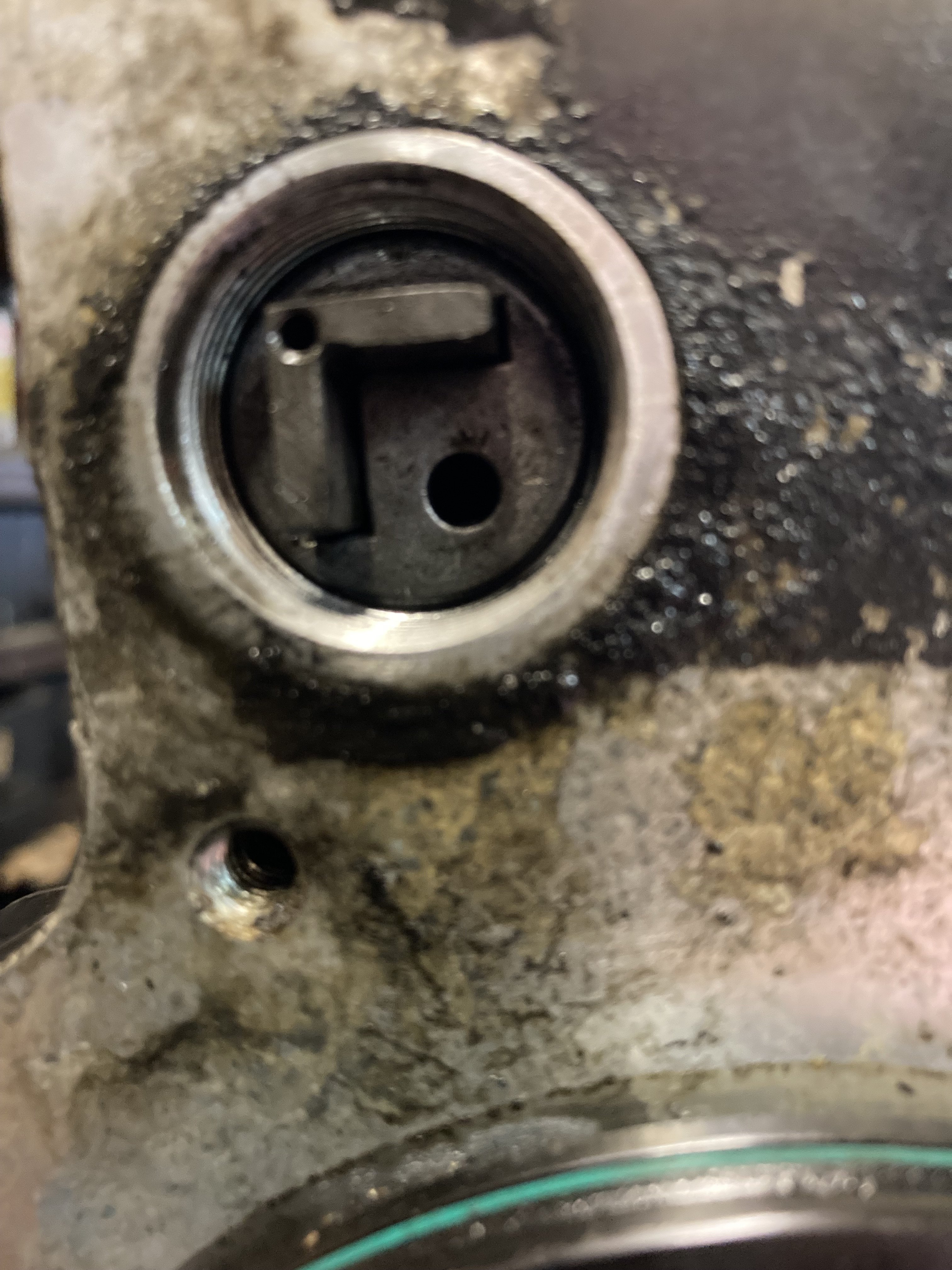

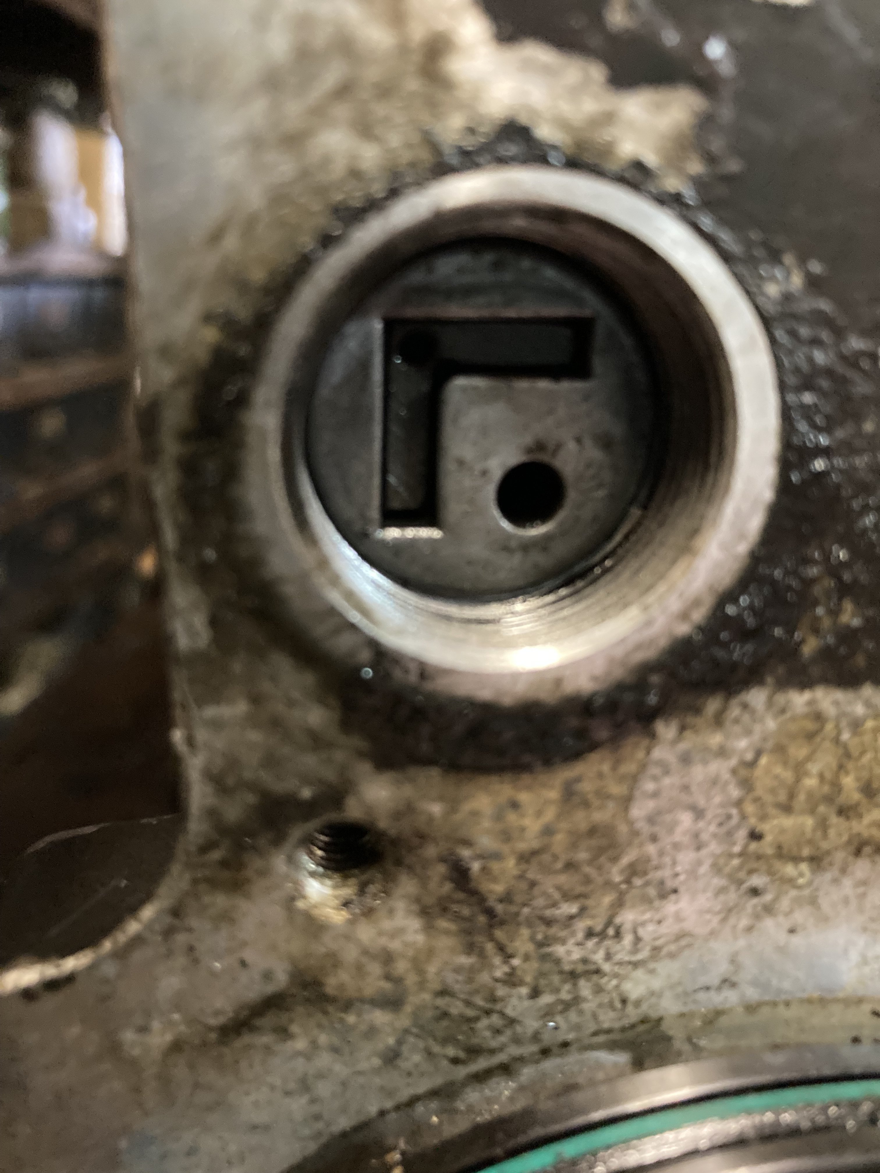

Have the pump off the engine. The rack is moving about .250” as viewed through the end plug. Pressurized the head and all six delivery valves are leaking… will not even hold 5> psi. Should they not hold at least a little bit?
The engine had been idling and just quit ( after fuel filter change). Had not been able to start since. Thank you.

The .250 is just over 6 MM rack travel, MOST Bosch pumps FULL rack travel is 20-21 MM. Depends what governor it has, RSV ag governor will allow full travel for starting, RQ and RQV won't UNLESS it's set up to do that. USUALLY delivery valves won't leak, BUT there are some that are designed to like some VE pumps have. What is engine application, and what governor is on pump?

That's the RQV governor, on most Dodge trucks the throttle MUST be bumped a bit right after starting cranking so the rack will travel forward more for easier starting. Rack needs to be AT LEAST 12 MM or more for starting, 6 MM is not enough. See if the rack will move further by moving BOTH stop and throttle levers. Rack MIGHT NOT move forward further until the starter is bumped.
Diesel tech, I posted pics of the actual rack travel. Not quite 12mm, possibly fuel ratio control holding it back? Turning the pump with both levers at maximum doesn’t make the rack move any further. The rack just passes the forward surface of the pump body maybe 1mm.

View attachment 68913View attachment 68915
I’m not sure what the issue is but the rack never extends as far as your measuring, the rack plug prevents it from coming that far forward

That is a Dodge truck and that is a hollow plug. The travel I have is coming nowhere near bottoming on that plug. Whether it’s original or not I have no idea.

The Dodge rack plug will still allow 12/14 MM travel, just not the full 21 MM like other pumps can with their longer hollow plug. The 12/14 MM is USUALLY where the full load balance check is done.
If it’s a hollow plug someone has added it
Been a member of the Cummins Diesel Forum for many years in the 12v section, been a good bit of talk about the hollow (Mack) rack plug but haven’t hear anyone claim their Dodge came with the hollow plug

If my pump had a solid plug, it would screw in right up to the rack bushing by time the gasket contacts the housing. How would it run with 6mm> of rack travel?
