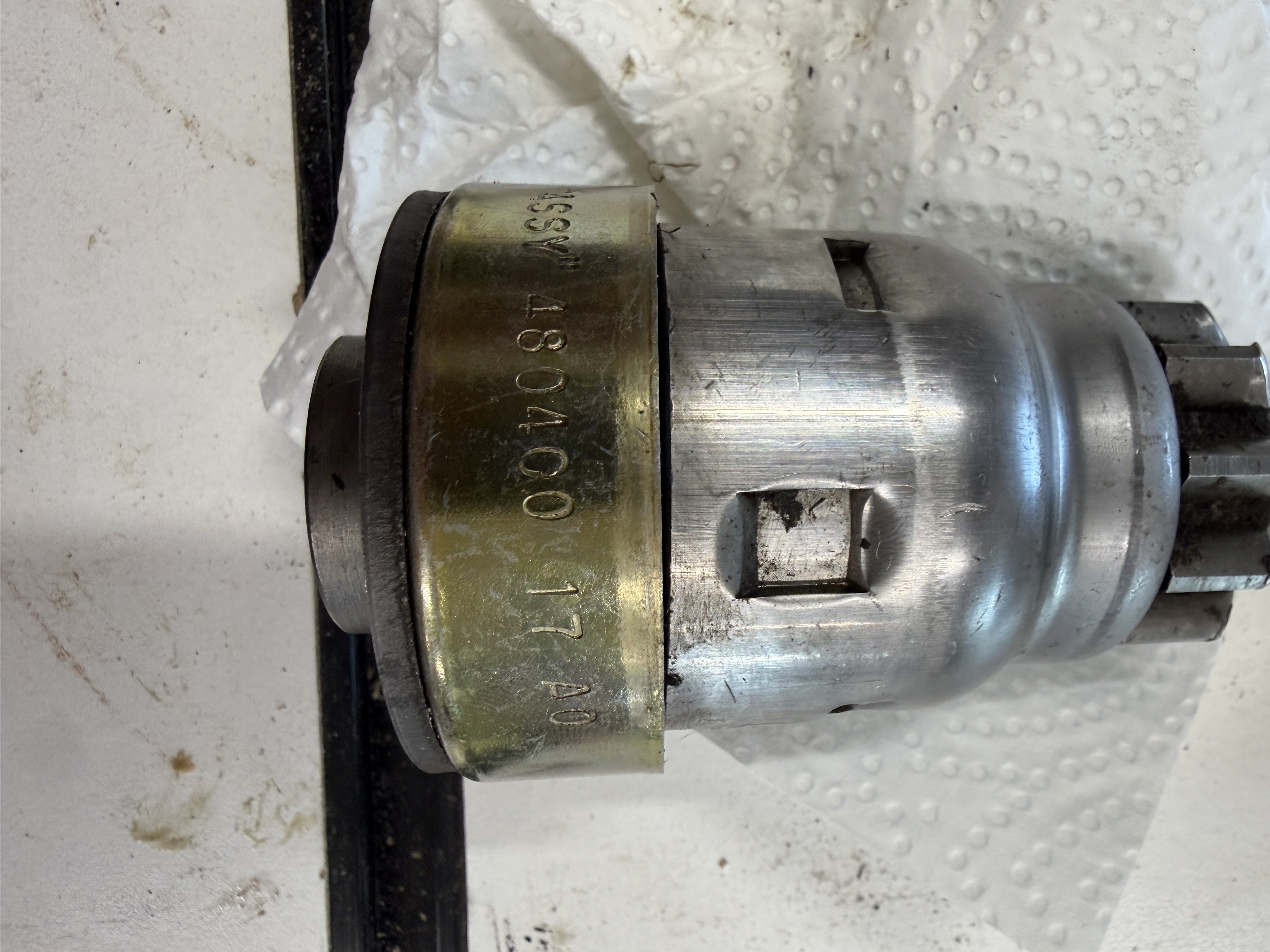

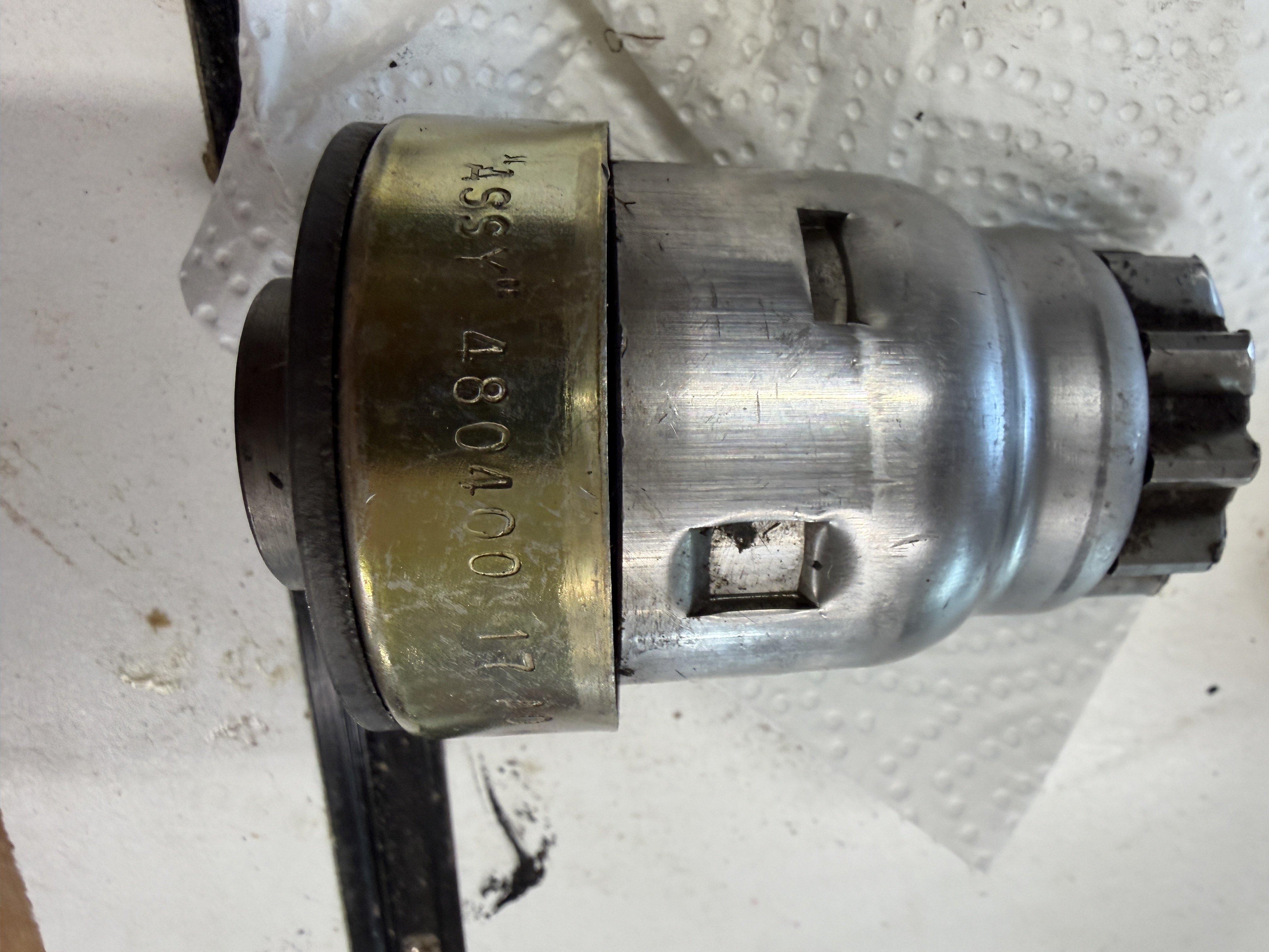

Hi all, new member here. I was recently gifted an AC D14 from a good neighbor who unfortunately can no longer use it. It’s in pretty decent shape, only real issue is he told me he has to rock it or pry the ring gear around a few teeth to get the starter to engage. Done that a few times but I want to fix it right. I pulled the starter out and both the bendix gear and ring gear are pretty thrashed. So I’ve been reading and understand the two different combinations. This is a 1958, originally a 6V, converted to 12 volt. The bendix gear that came out was a 10 tooth. Not positive yet, I will count it, but I imagine the ring gear is the 93 tooth. My question is, if I’m replacing both, should I keep with the 10/93 combo, or should I install the 9/116 gears.
Follow up question, I see a couple different types of bendix assemblies available. One looks like it has a spring that wraps around it and a shaft that extends beyond the gear. The other is more like what I pulled out where the spring is enclosed and nothing protrudes past the gear (I’ll try to post a picture of the one I removed). Both types say they are compatible with a D14.

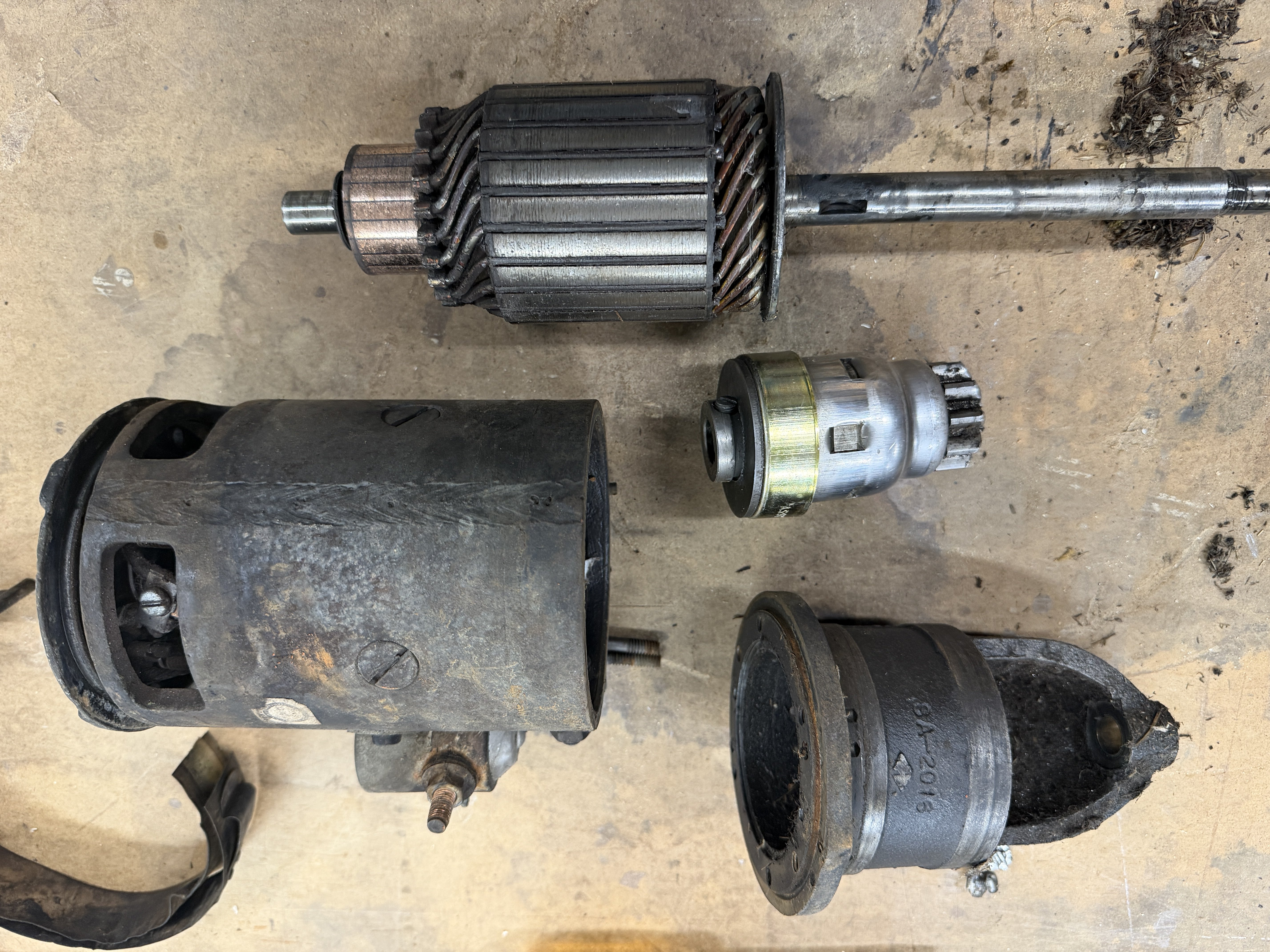

Another question if I may, I’ll attach pics of the starter - I don’t see a tag on it, but it is stamped:
CK05023103R0 then 8V NEG followed by N0225224
Wondering if this is an original starter, and then curious what the correct bendix is (not sure the one that was in it was the correct one).
Thanks again!
