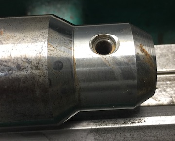

There may be different kinds of cylinder rods. I have been working on heavy equipment for many years. I have a collection of bent or otherwise damaged rods if various sizes. I have never had I piece that I could not machine. As mentioned in previous posts you need to get through the hard chrome finish. Then use good tools, cheap harbor freight drill bits will not work for very long.
Here is a photo of a bucket rod from a large 1980's vintage Ford Backhoe that I cut a piece from using a bandsaw. Notice where the chrome was removed before sawing.
This is a photo of a piece of rod turned down using a carbide cutter, then drilled using a cobalt bit.
There is GOOD STEEL under that hard chrome, It machines very nicely with good tooling and a ridged set-up

I was going to say that it depends on the quality level of the part, and/or the original manufacturer's specs. Cat or JD vs Jinma for instance. Your pics and experience say it better.
