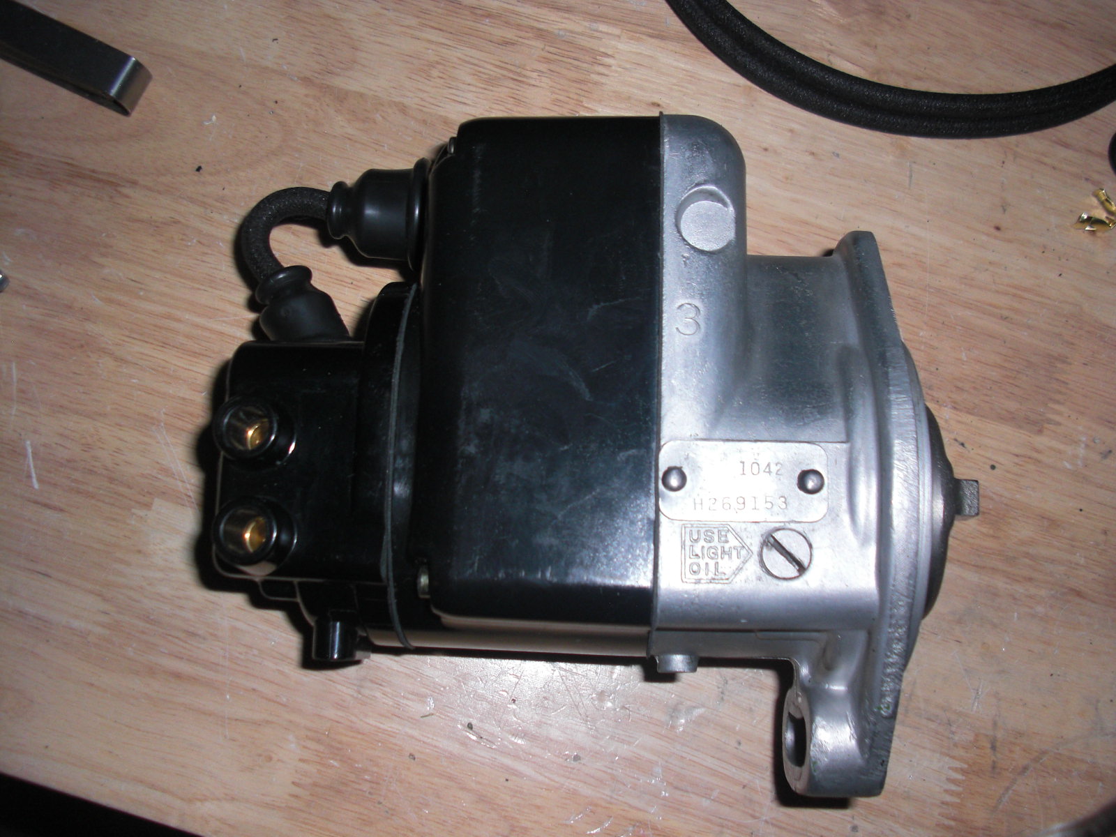

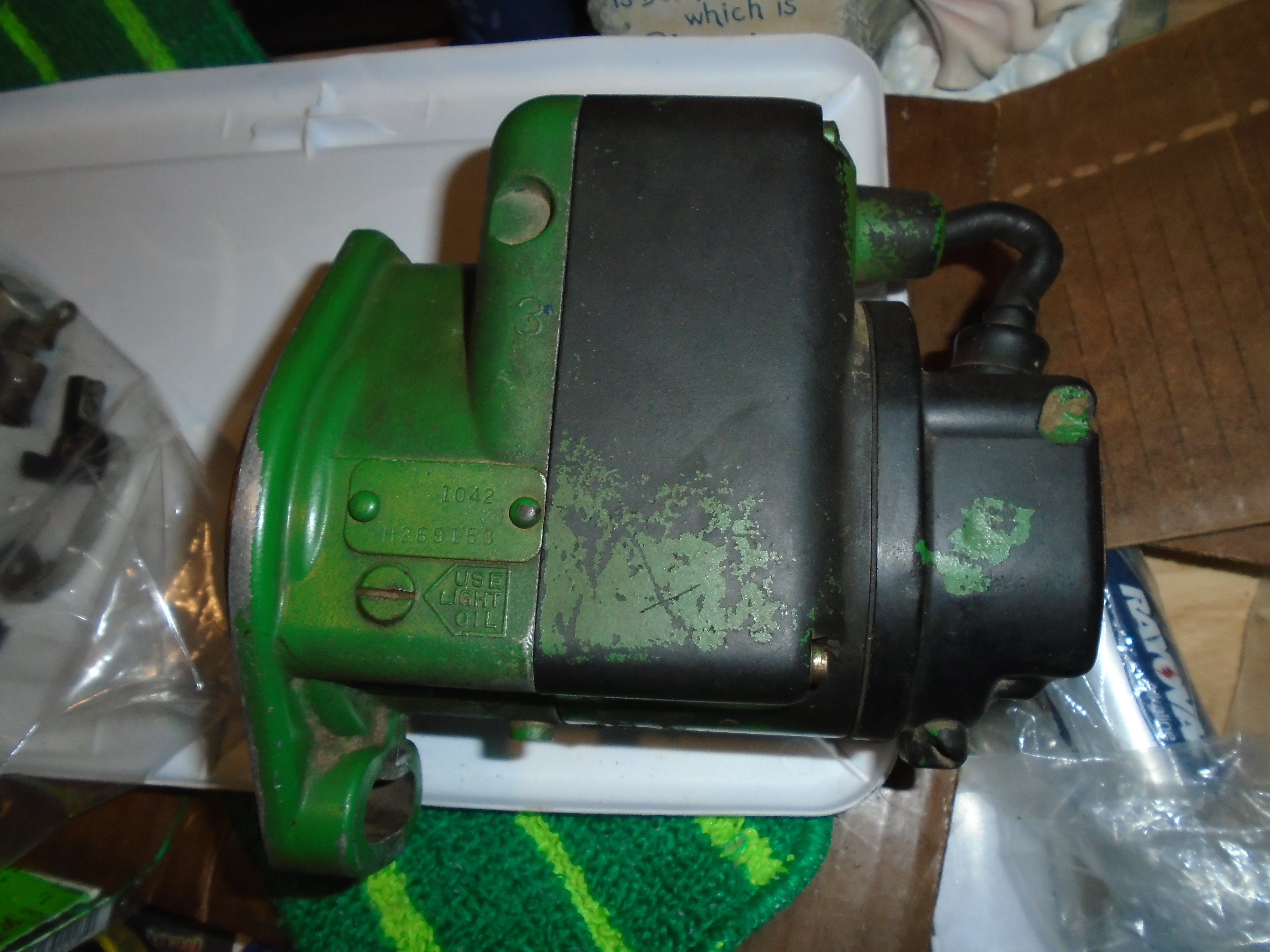

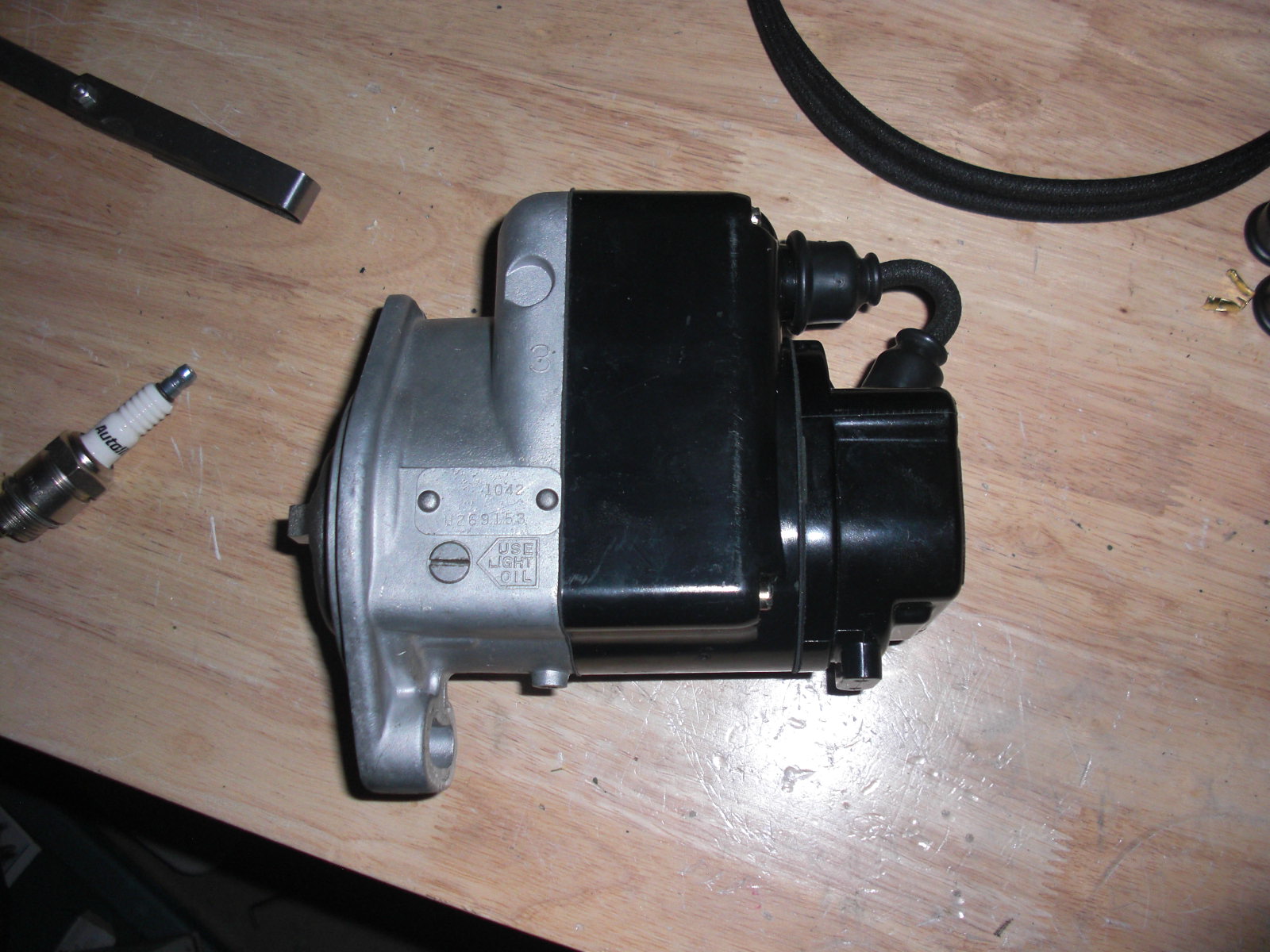

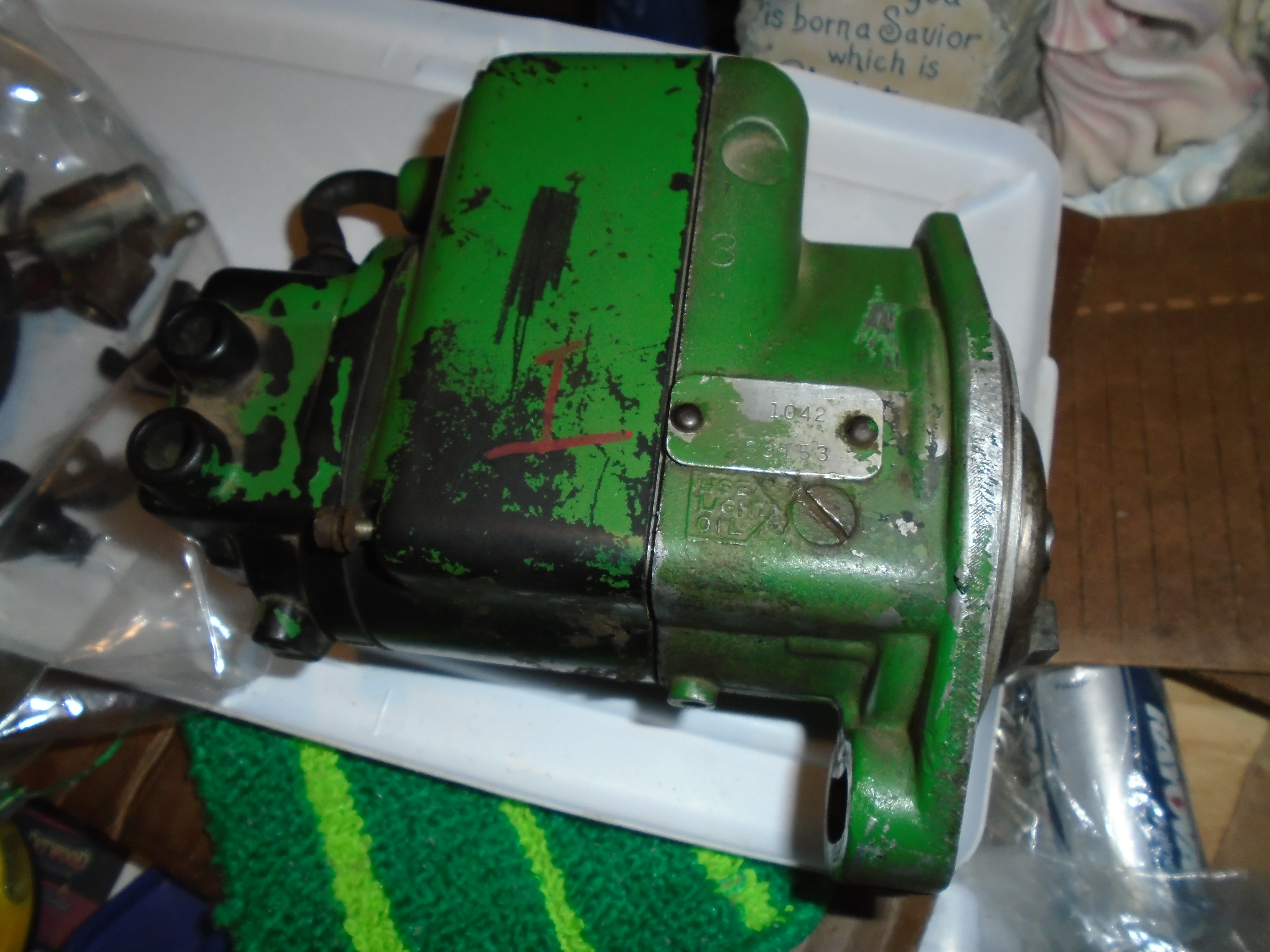

I just finished rebuilding the magneto for my JD B. I did have few issues with the bushings, but we figured it out. After getting it together, I did have an issue with not creating spark, but I fixed that and now it sparks every time. I made an attachment for my drill and ran it up to a fairly high rpm and it was functioning perfectly, so I can't help but feel a little proud. I have before and after pics below. Also, this mag is not original to my tractor, as the first one was lost to a shed fire before I got the B.

Nice and tidy. Does the impulse coupling work (snaps loud when turned slow? Jim

GREAT job!
You took on a project that many on here are scared of (and send them out) and succeeded in getting it working!

That’s probably the nicest looking wico c I’ve seen in a long time. So many of those were thrown away and had an x slapped on. Had one last year I had to toss it was so corroded myself. Great job! It might not be the original but it is the original type
Great job and congratulations on tackling it yourself! As stated, not a lot of us will try to do that on our own. My first time was when I had one go down on my 44 A and decided I needed to look into it myself. Quickly found it was a broken impulse spring, ordered a replacement and soon had it working again. I took a piece of 1/4" steel, cut a hole for the coupling to fit through and a couple of nuts welded on over drilled holes for attaching the mag and drilled another hole and welded on a collar with a set screw to hold a spark plug and I had a test stand that I can clamp in my vise to work on them. This allows me to spin them over by hand and observe the spark in the plug while doing so. Now I pick up mags at auctions whenever I can and get them working again.
