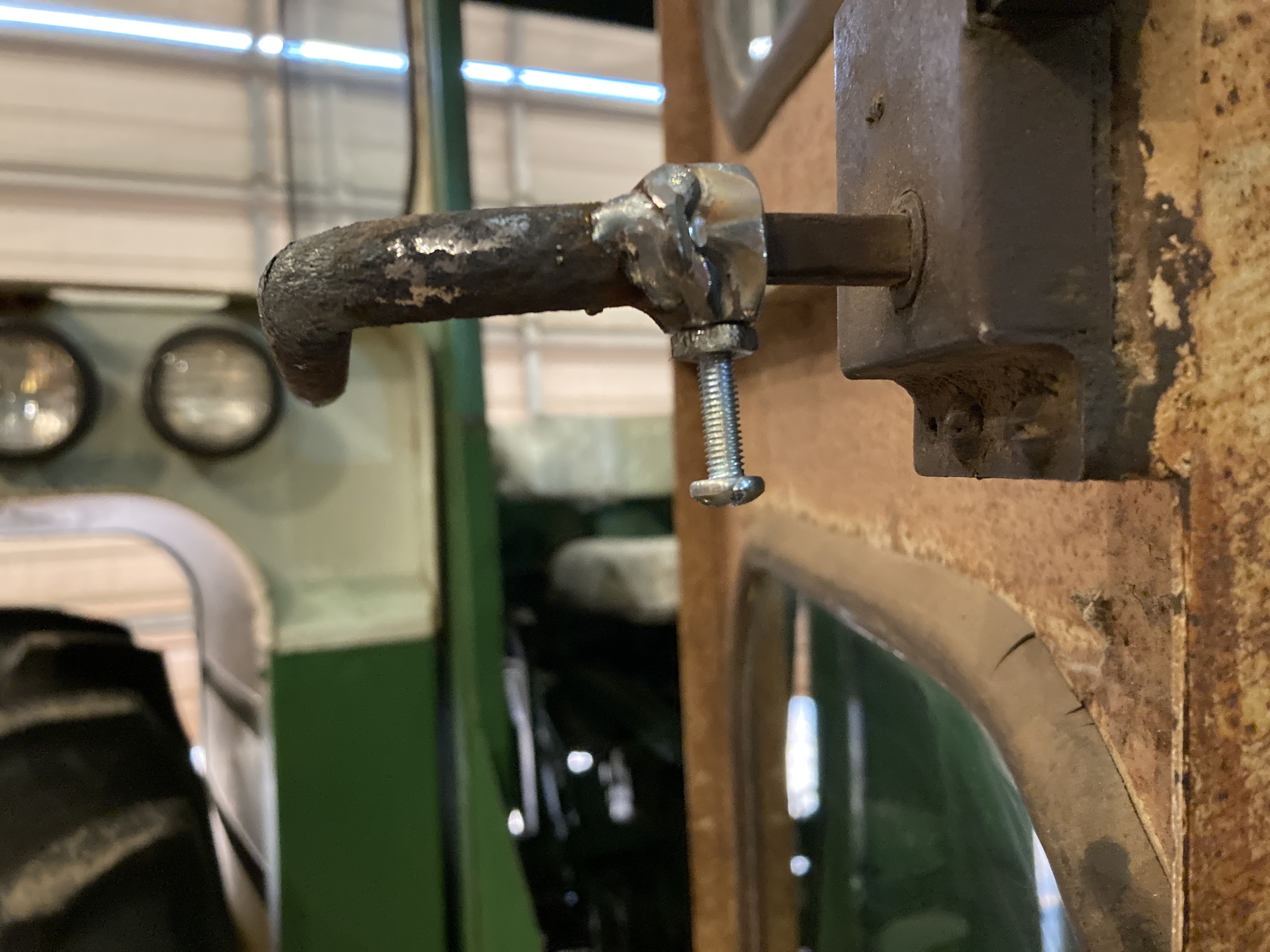

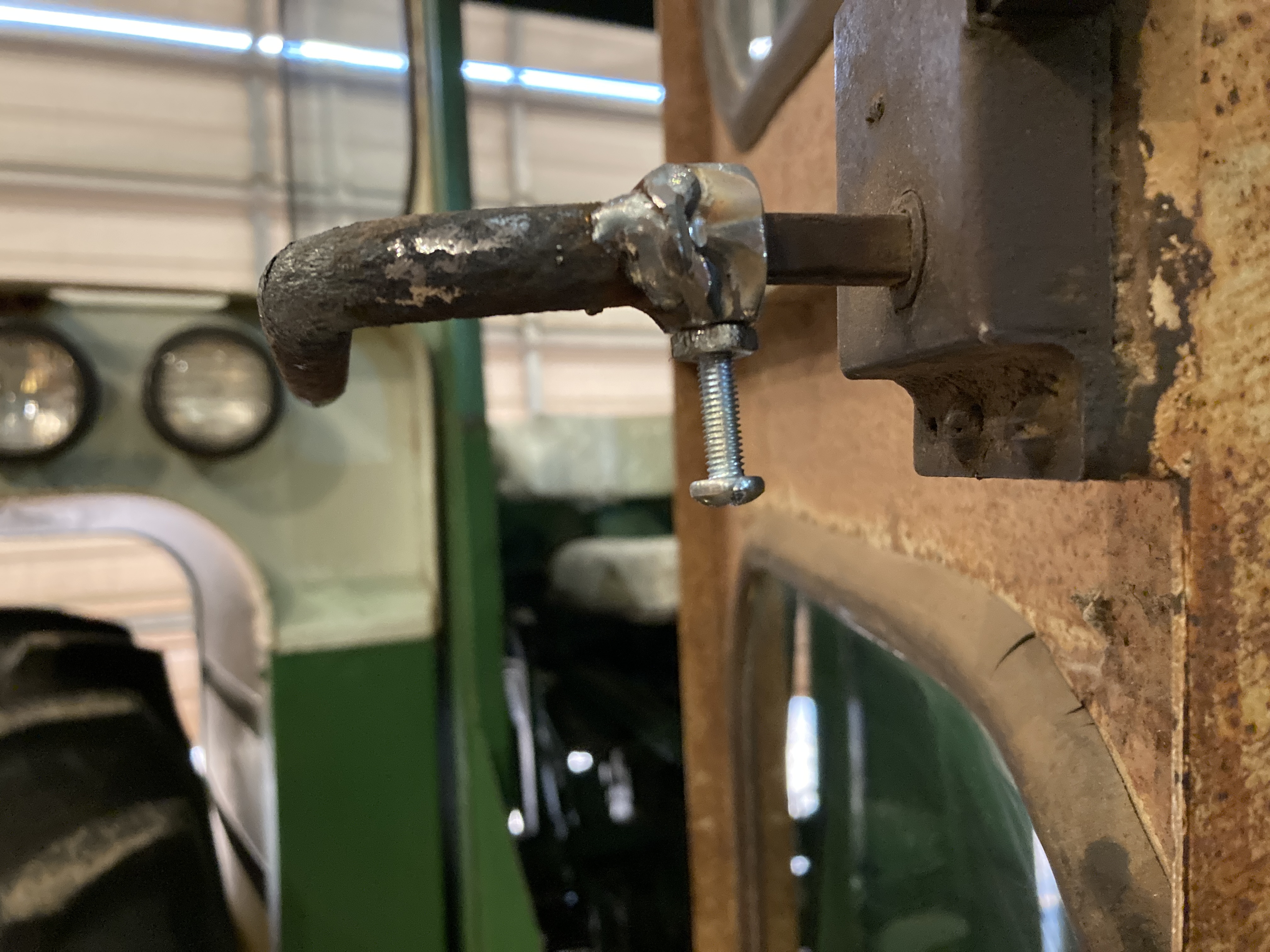

That’s what I call it when I screw up. Put the doors and windows in the tractor cab a week or so ago on a nice day, figured I’d attach the inside latches later. Today I was going to put the blade on to be ready for it to snow. I put the windows on the wrong side and they wouldn’t latch. Had to pull the 1550 and the 1655 out to have room to get to them with the rolling stairs. Got them switched okay and finally got the blade hooked up. The right door hasn’t had an inside latch handle since I owned it so I cobbled one up. 1/2 inch nut fit over the square shaft so I drilled and tapped one flat on the nut and welded a rod on to it. Seems to work okay, better than nothing I guess.

Seems good to me.
Looks good!
My 4020, "Ervin", came to me with a Vise Grip as the inside RH door handle.
I had it for probably 40 years before I finally made a custom handle similar to yours.

Just needs a little Oliver white paint and no one will know it's not factory.
