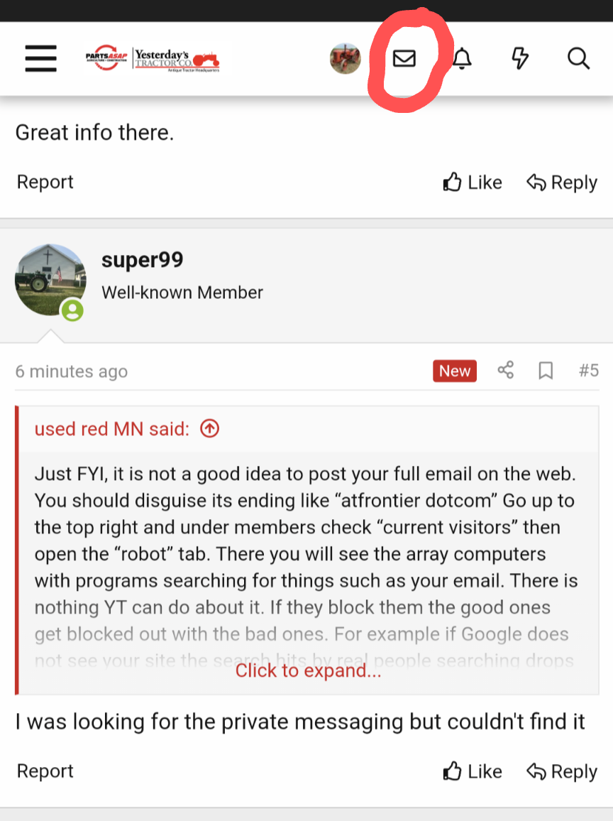

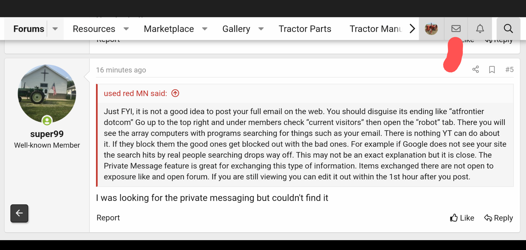

I was looking for the private messaging but couldn't find it
The private messaging is the envelope icon in the top right corner. Depends what your screen looks like. Here are a couple examples of where it is

It is actually called “Conversations” by the folks who made the software. The “mail or letter” icon at the top is the main access to it. I covered the use of it in this post in early January. PM instructions post
One thing I didn’t cover in that post is that you can start “conversations” or PMs right out of your thread. In this case if you want to contact Dieseltech on a PC hover over his username then click the “Start Conversation” and then follow the directions in the linked post. It is odd that I can’t see that option on your username. I am going to check in with support to see if you possibly disabled it some way.
