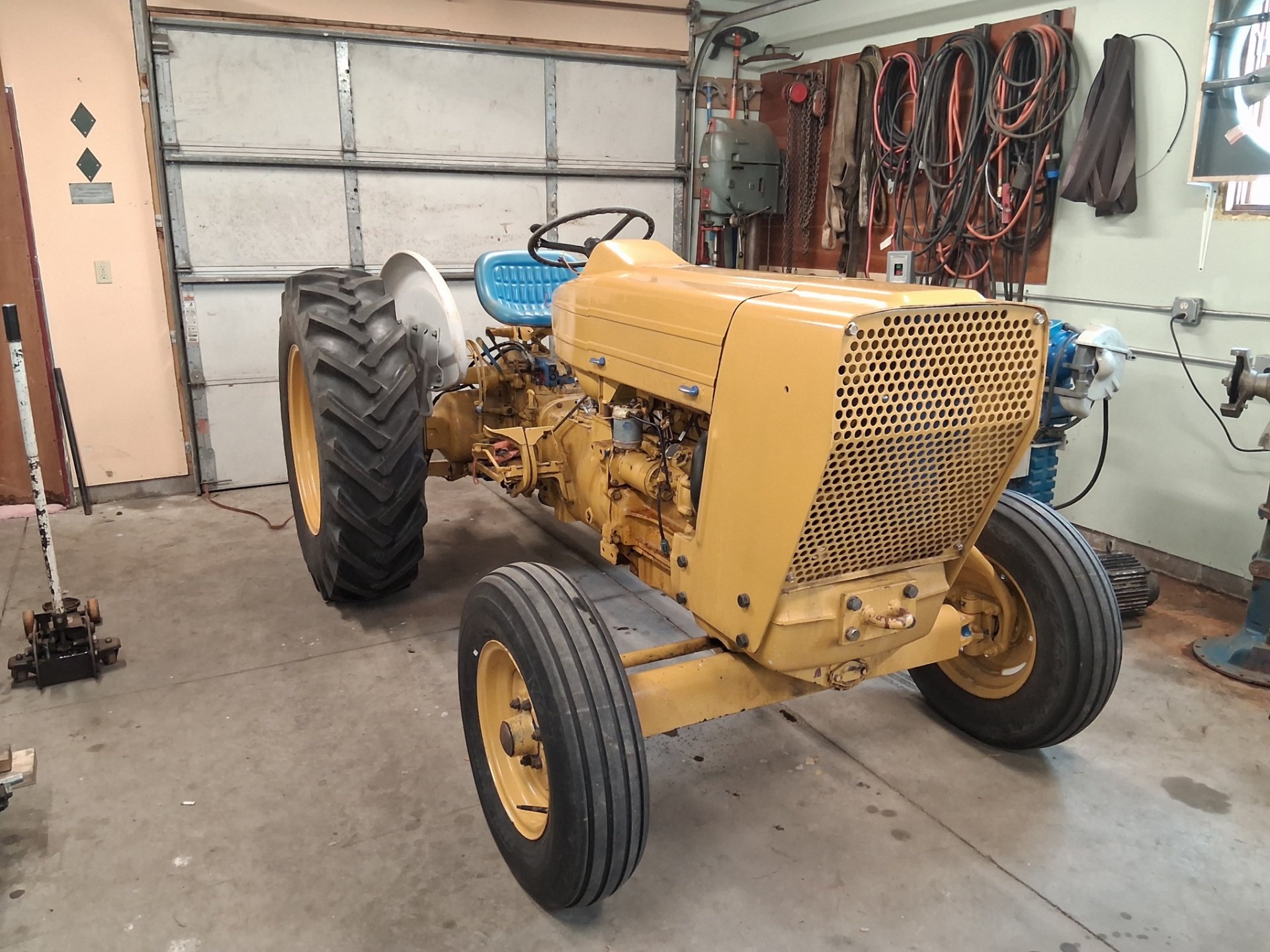

Has anyone ever come across a rear axle / transmission / engine on a heavy stand with steel wheels possibly to be used to train technicians at a dealership?
Also used at schools that had ag or tractor mechanic classes. Jerry (Ultradog) has one. He has done a great job of making a useful machine of it.

Thanks for the replies. From what I can tell, it has not been wrenched on. It looks like it came right off the line and sat in storage for 47 years.
What I would like to do is preserve and document the existing piece, but complete it using a donor tractor. I'd blast and base / clear all of the added parts, making the transition of restored vs original very apparent. I am actually considering painting the replacement parts purple (my daughter always wanted a purple tractor). This way I could show it and tell the story while preserving the original.
Now, if someone is going to tell me that this is an exceptionally rare item worth tons of $$$, then maybe I would need to reconsider. It's only going to be original once...

You're right Keith, that was and still is my point of view with regards to student training aids. As a diesel mechanics instructor for over 25 years now, I've seen students that could break an anvil with a rubber hammer! You never know what you're going to get with regards to former training aids. If it sat in a corner and collected dust for decades, it might be just fine. If it has been disassembled and reassembled multiple times, there's no way I'd put oil in it and run it. At the very least it's going to be missing a few parts, like miscellaneous fasteners, snap rings, detent springs, etc.

I’ve seen a few of the school chassis, my nephew has one. If the paint is scuffed on any of the bolts or it appears to have been repainted I’d disassemble it to check everything. Even if you have to replace all the gaskets/seals and any missing or damaged components there is still a lot of zero wear parts there to build from
