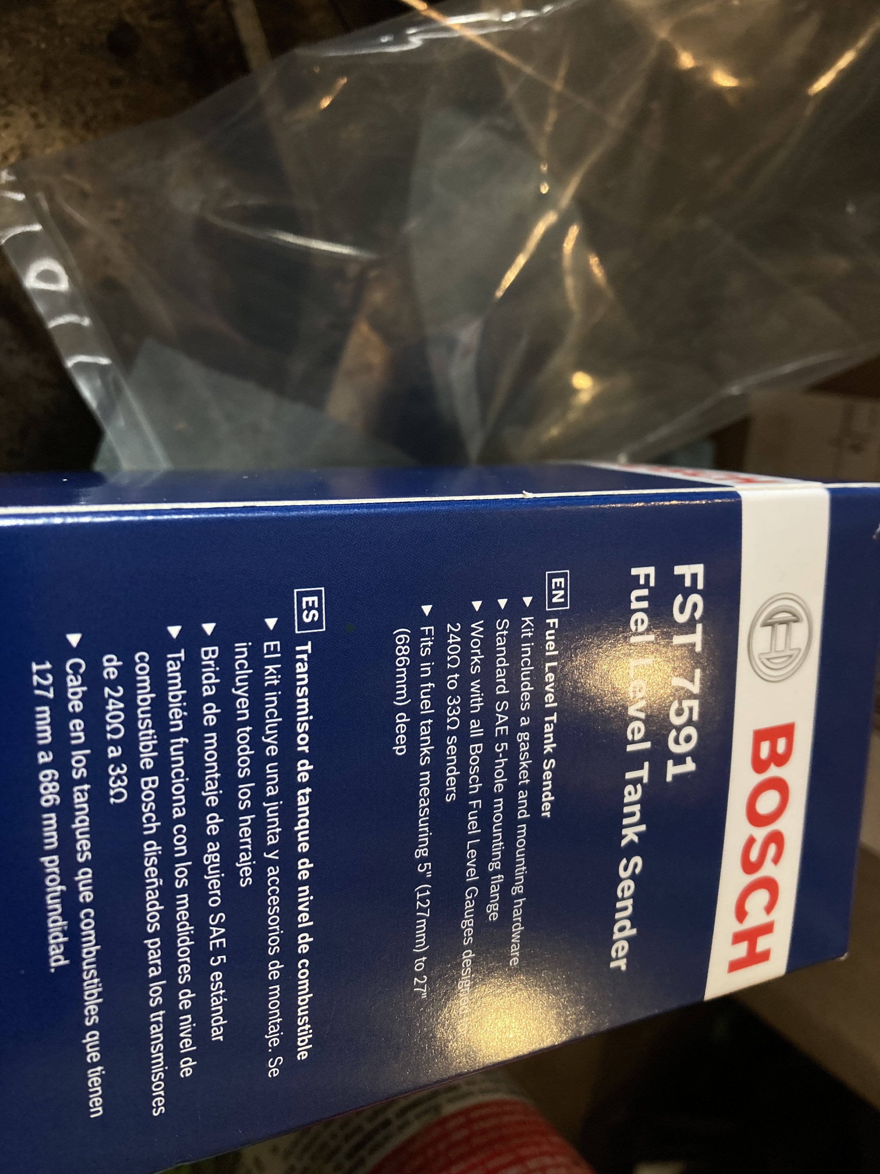

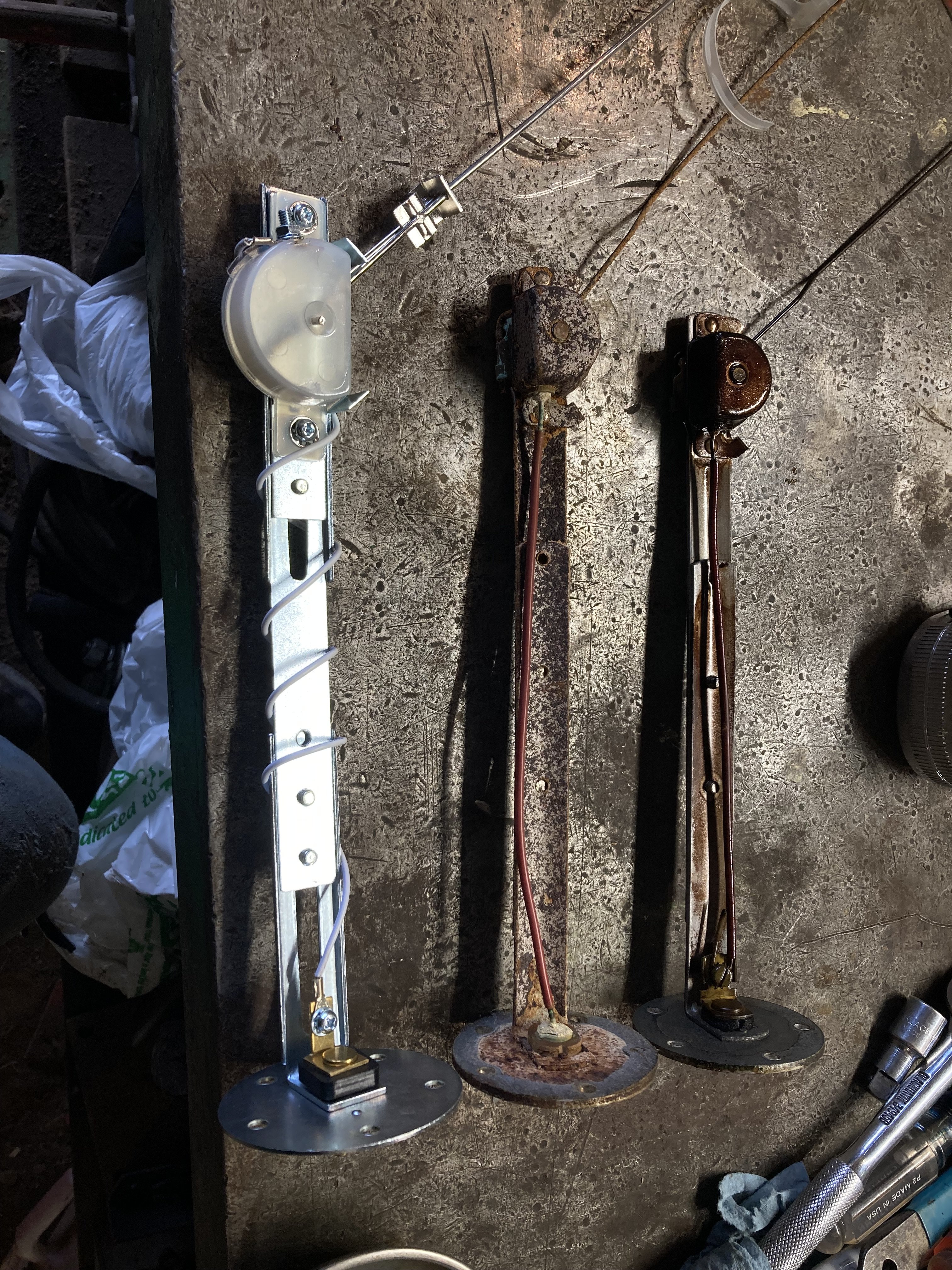

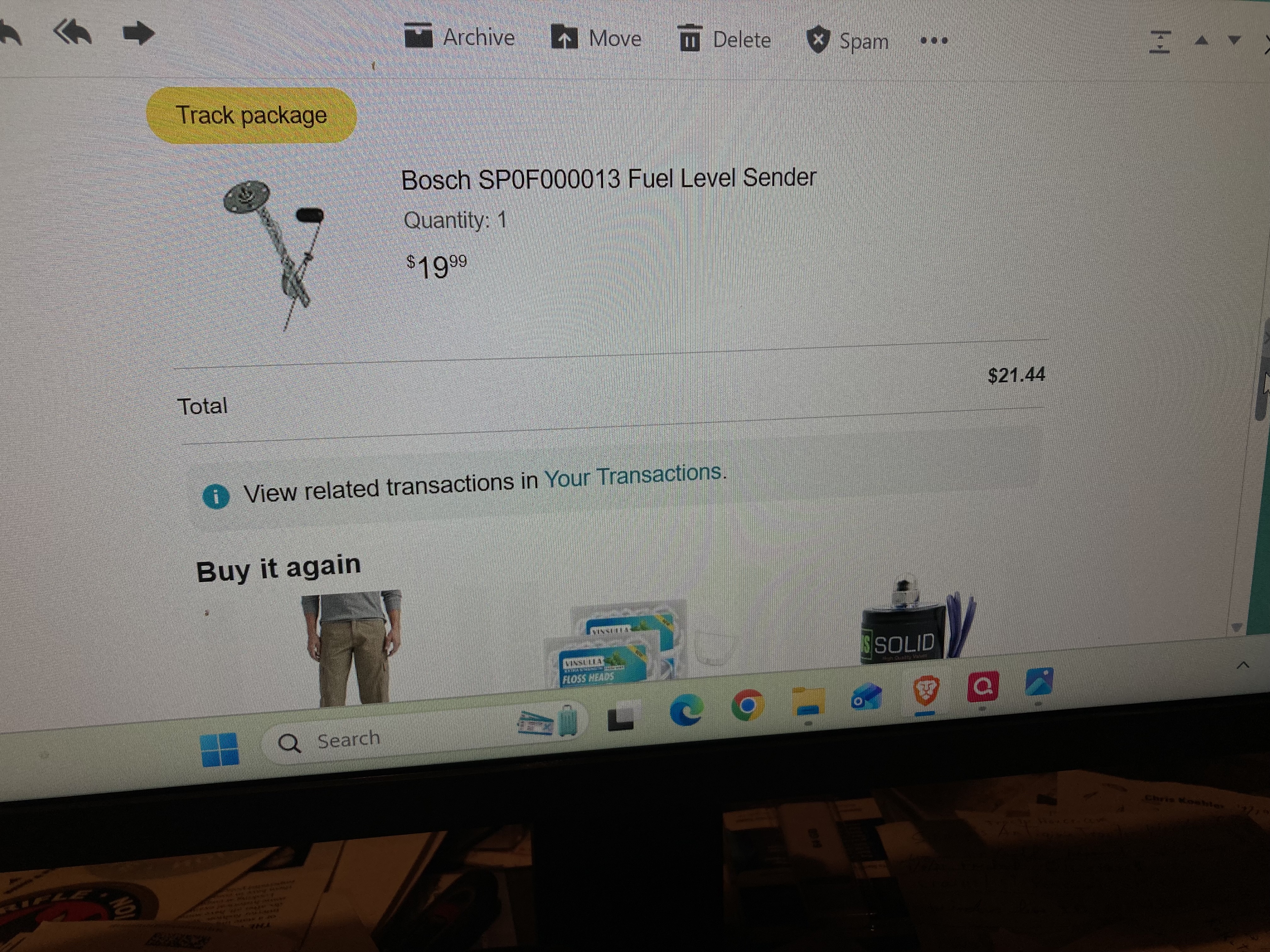

Sending units were bad in my Oliver 1850 and 1550. I ordered a new one from an Oliver parts website, it was $94 and change with shipping. I looked on Amazon and saw one that looked almost identical for $20 so I ordered it and it came today. I put it in and it works fine. We’ll see if it lasts as long as the expensive one.

Senders are a engineering marvel the body is grounded down to the float level arm. It must be the wiper has to be grounded. Most all that I have repaired somewhere the ground will be broken. Normally its between the hanger body and float arm. That ground has to flex over time it breaks.

Bolt pattern and resistance value over the scale is the biggest thing
Bolt pattern length and resistance value over the scale is the biggest thing.
And if you replace the sender and the gauge as a set you don’t even need to worry about resistance value so as long as it fits in the tank you are good to go.
With a sender a little to short the gauge will just read empty before the tank is really empty.
I checked the resistance and they were the same, bolt holes lined up, length was adjustable, had to add a ground wire.
