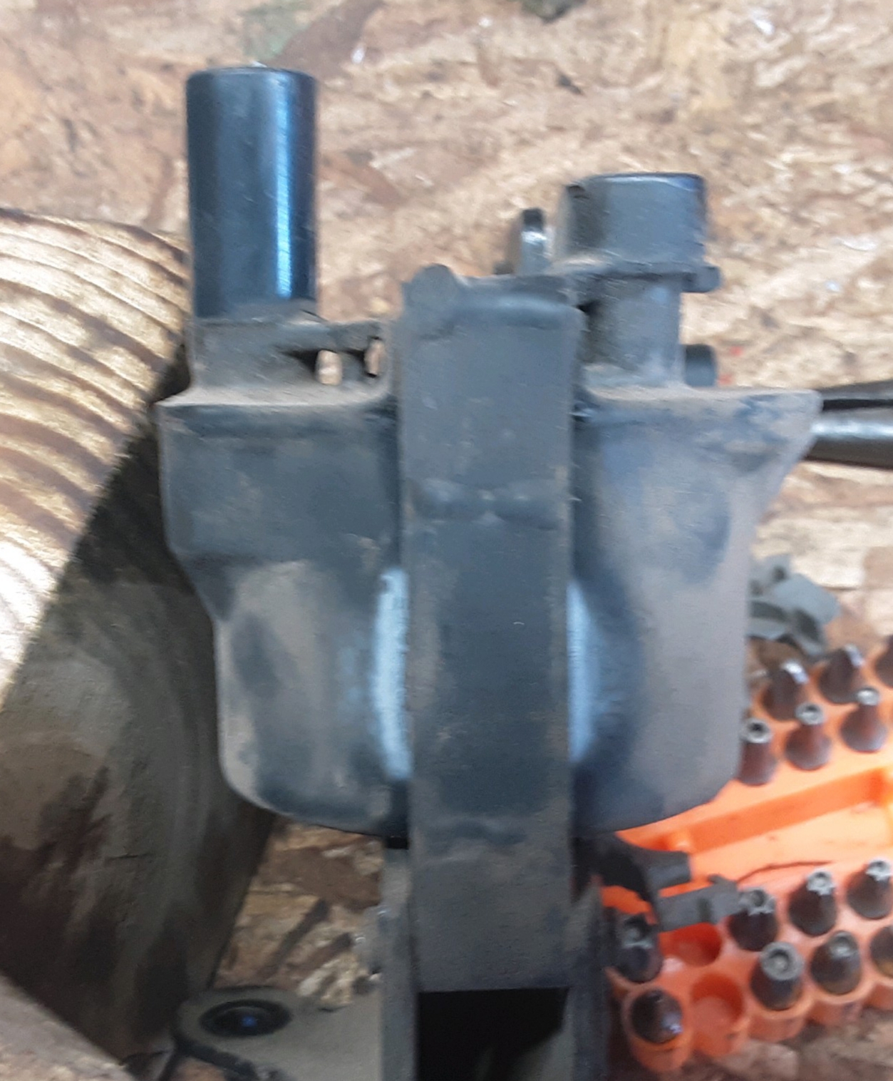

My garden tractor has a 8-HP Kohler engine, 1963 model I believe. Have had a problem for years where it would run good but then shut off after about an hour. Then recently, it would only run for a few minutes and shut down. Would not restart until you let it set for about another hour. Really frustrating. Well, yesterday I went to use it in my garden and it, of course, shut down and would not restart. Right then I tested the spark with this in-line spark tester (see picture) and it fired right up and ran all morning with the spark tester still installed. Strange, yes?
So, is the spark tester actually doing something to the spark or was this some kind of coincidence? If it is doing something to the spark that remedies the shut-down/no restart condition, what component do I need to replace to avoid having to use the spark tester? I'm weary of chasing my tail on this thing. Thank you, Michael

easier for the ignition to fire across spark plug gap than in the original positron with wire tester installed . Put spark plug wire it back where you had it and see if it stalls .out. To verify the wire is shorting to ground. Might weak insulation shorting it out to frame some where.
If it stalls the old spark plug wire is breaking down arching out to frame .
check the coil for good ground .
if coil is very hot to touch its shorted out .
make sure the condenser is grounded.
clean points reset gap .

. You can't see what goes on inside a coil, especially a 1963 coil. High voltage causes insulation to break down in coils, distributor, rotor and spark plug wires. I had a spark plug go bad after running for a few minutes. It would work when cold, but stop when it got hot.
Go figure. Sometimes the only solution is to replace parts and chase your tail.
Watch it in the dark to see if it's the plug wire as 560 suggested. I had a weed eater do that. Cut out after 10 minutes, cool down and run 5 minutes at a time. New coil, no change. It was the condenser. Adding the tester puts in another gap to jump. The coil will build to a higher voltage. I've had engines that misfired then with the wire off the plug and hanging two inches away the misfire disappeared. Could also be the coil, windings go open when it heats up.

This came in while I was typing. Coil can test OK cold. If you start throwing parts at it change the condenser first. A lot cheaper than a coil.
Jumping the spark ahead of the plug makes it hotter, which is what is occurring with your tester; will sometimes overcome a fouled plug and run the engine. However, I have never seen a fouled plug cause an intermittent failure like you are describing... I think you have more than one issue at play here. I'd change the spark plug as a first step before dinking with rest of the ignition system.

Yep, way back when it was common to see lots of lead and/or oil fouling on daily drivers. That conductive fouling causes the spark to leak off before it rises to a level high enough to jump the gap. So it never fires. Adding some resistance, like holding the wire off the plug a bit so it could jump would make them fire at idle. You could also put the wire boot on the plug, barely, so it would jump and 'solve' the miss for a while.
Try a new plug, even a resistor plug in a close heat range may help.
