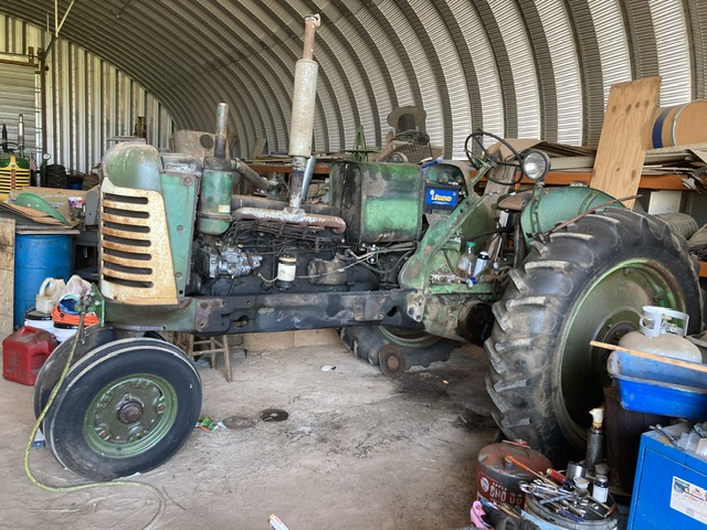

I bought a Oliver super88 diesel back in April. It had sat several years inside the guys shop when he had health problems and sold it to me. First thing I did was take the injection pump off and send it to dieseltech. It was stuck but he got it freed up and checked over and all is OK. Got it timed and back together and couldn't get any fuel thru it, old fuel turned into tar in the bottom of the tank. I tried E85 for a couple of weeks to no avail and then put a gallon of Acetone in the tank and it cleaned it right up. Working driving sprayer tender for local FS, mowing off sweet clover in CRP, tractor rides and yard mowing I haven't had any time to work on it. Today I got the fuel tank back on and hooked up fuel lines and bled and tried to start it with no luck. I took the hose off of the air cleaner and gave it a shot of starting fluid and it popped off. Ran it a couple of minutes and shut it off and hit the starter and it runs with very little cranking, sound great!! Best Fathers Day present I've gotten in years!!!plus a big half inch of rain this afternoon. Now on to replacing the brake seals and then seals in the hydraulic pump and seat bushings. Happy Fathers Day!!

Uh pictures....please
Tried to post a short video but it didn’t work
