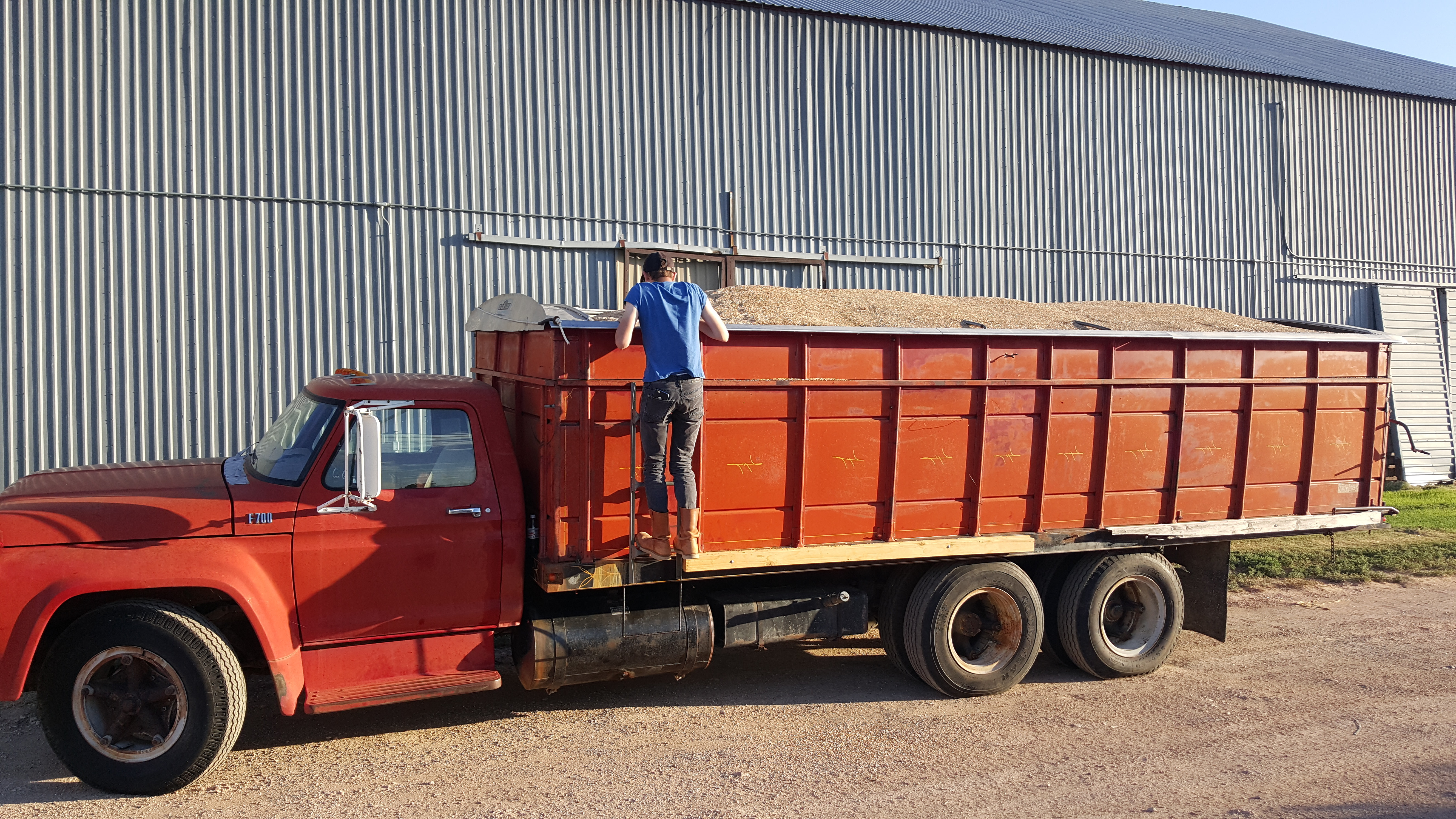

Getting my old F700 Ford grain truck (I think it’s a 360 engine) that hasn’t run in several years ready for harvest and it’s not getting fuel to the fuel pump on the engine.
The pump on the engine IS working, but I seem to not be getting fuel from the tank.
Is there an electric loading pump back on the tanks to get fuel to the engine? Or does the engine pump create suction on the tank line to pull it up?
Thanks for any advice,
Howard

You could blow back with air on the tank outlet line. Probably the gas is vanished up and stinky and that’s your problem. Even if you have to remove the tank to clean it. Hook up a rubber hose to the fuel pump and stick it in a Jerry can and see if it pumps. Should run that way.
Several possibilities. A rust hole in a steel line between the tank and pump. A failed rubber line in that position. a failed check valve (intake or exhaust) in the pump. Blockage in that line to the pump.
I would put a rubber line on the pump intake (maybe use a barbed fitting that fits the pump) into a container of fuel then see if it gets fuel.
If yes you know it is rearward from the pump. If none, it could be the pump, or plugged fuel line from the pump to the carb. Jim

I appreciate all the advice. 🙂. I suspected the old nylon fuel lines to the three tanks, but come to find out, a section of steel line inside the frame from the selector switch to the engine fuel pump had rusted a pinhole in it.
I just replaced everything and it starts like a car now! 😊
