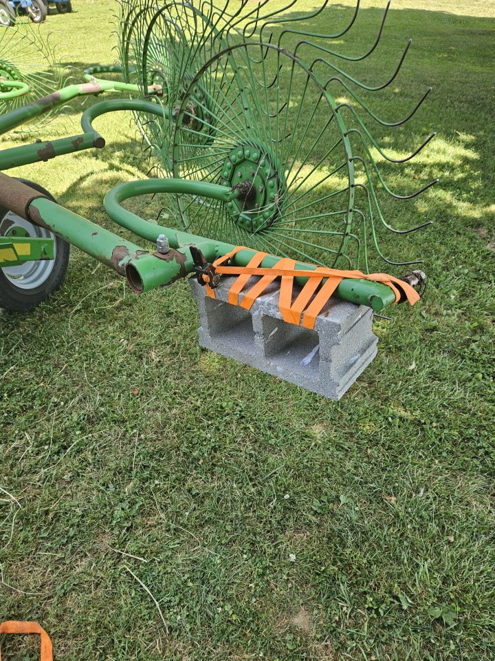

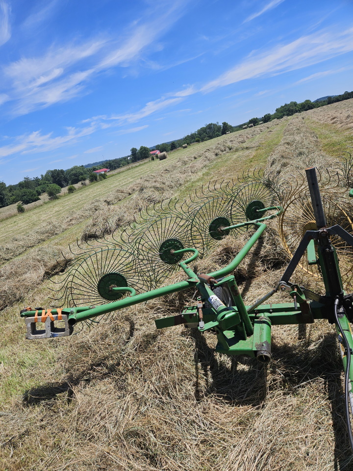

Hay is real thick, couldn't rake with the 10 wheel v-rake.
Thought, what if I take a front wheel off?
But that messed up the balance of the rake.
My solution.....still get the occasional wad, but better than it was

Wouldn't just hanging over a bit to one side so you're not raking a full swath do the same thing on all except the first swath?

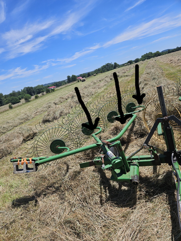

I've seen the hay wad up in the 3 places indicated with arrows. So the side that was in the thick stuff would still wad up on me.
Seems to me if a guy was to fill in those spots with sheet metal, with a lip bent up on the leading edge, it would guide the hay underneath to flow on through rather than pop up and wad.
I've never used that kind of rake. My first thought on a fix for wadding is the angle of the rake wheels. Can you change the angle? Have you ever compared the angle of that rake vs some of the other brands of wheel rakes? I would think there is a continuum on that style of rake where a steeper angle would work better on thicker hay vs a wider angle for thinner hay and covering more of the field on each pass.
Changing the angle on these affects the windrow width.
I've got it as steep as I can make it, the windrow is as wide as my baler pickup now.
Round balers and the big square balers like a big windrow of hay. The newer small square balers also can eat a big windrow compared to the older small square balers.
I want to have a good sized windrow going into my baler. Itr simply enables it to put out a better more consistent bale, and means fewer times around the field. In a dry year and for second cut I often double or even triple the windrows. If one rake pass makes me a good sized windrow then that is it.
