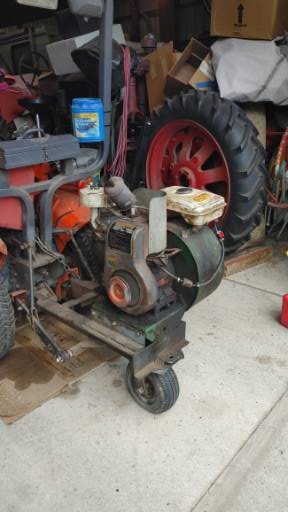

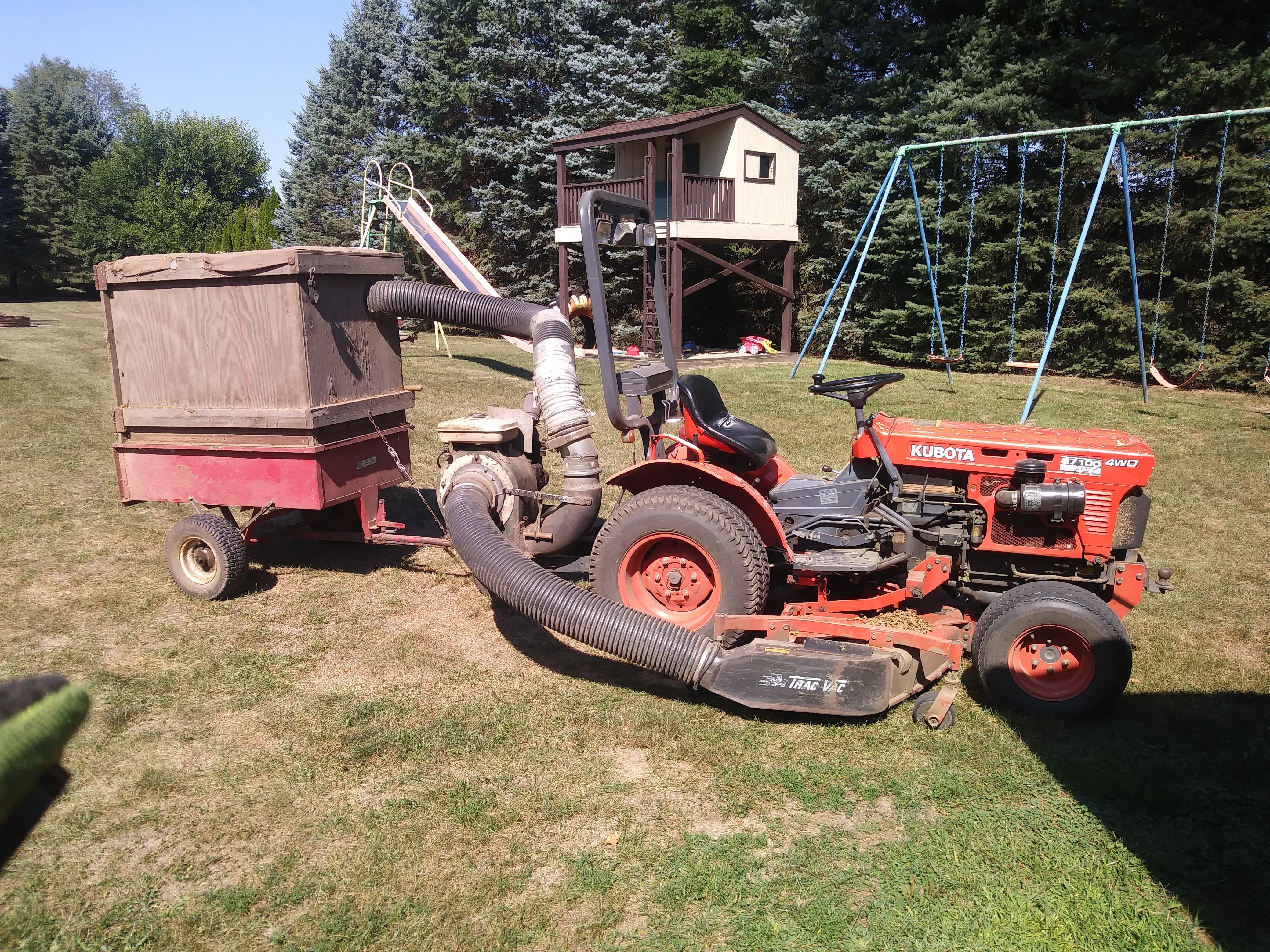

The 60s Wisconsin on this leaf machine has been using about a pint of oil every 4/5 gallons of gas ever since I built it 40 years ago. Smokes a little at start up, but very little once warm. Run as good today as 40 years ago. I got 150 gallons of 20w50 Kendall for free 30 years ago. I Just keep it full. Agree with others about quality of Hondas. As long as it's not leaking, I would just run it.
