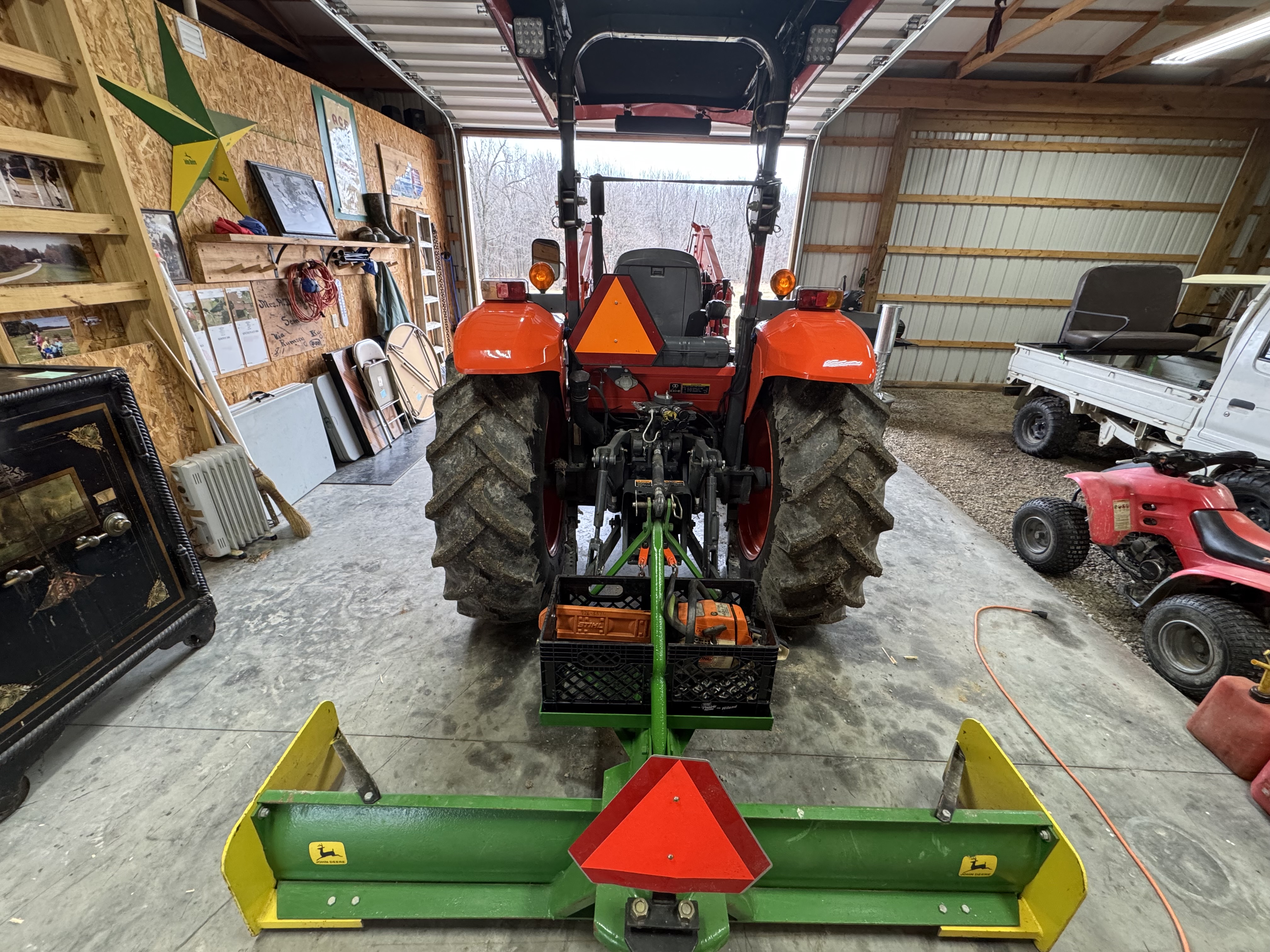

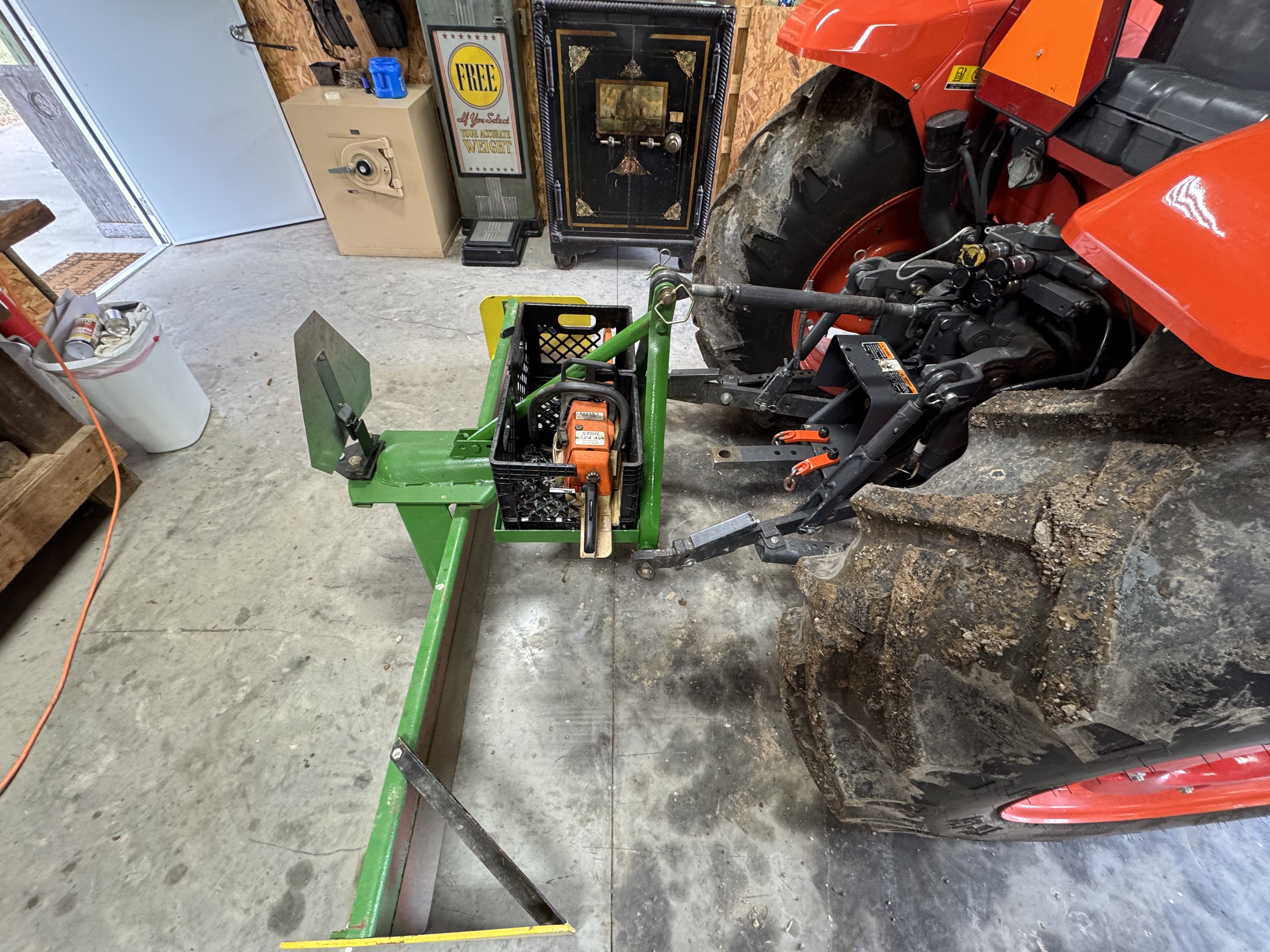

Add removable plates fore and aft on a 6ft heavy blade. photo of a medium duty 7’ unit
Get a six foot. A five foot will be narrower than your rear wheels. With our six foot we could grade dirt right next to a foundation or other obstacle. This can save a lot of shovel work.
