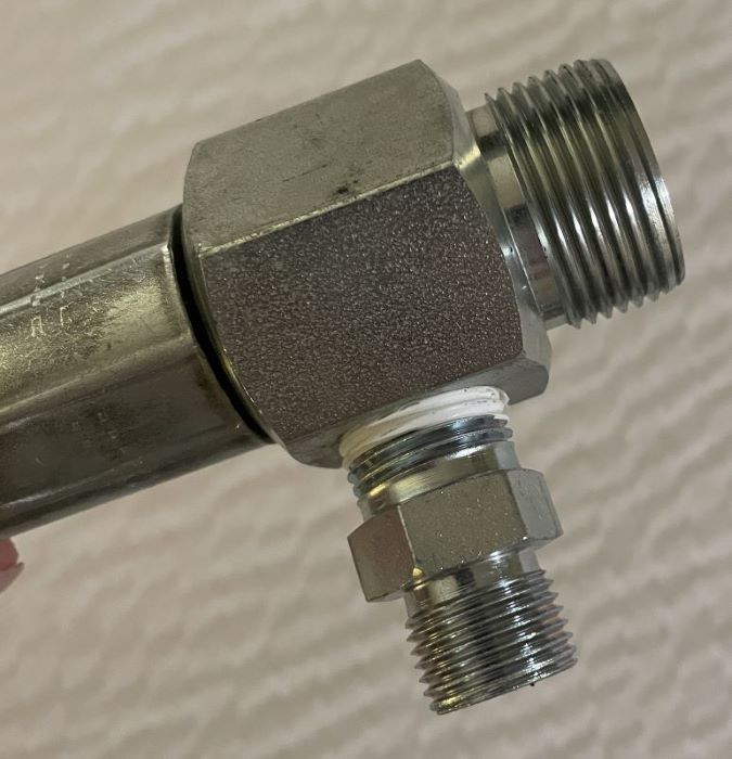

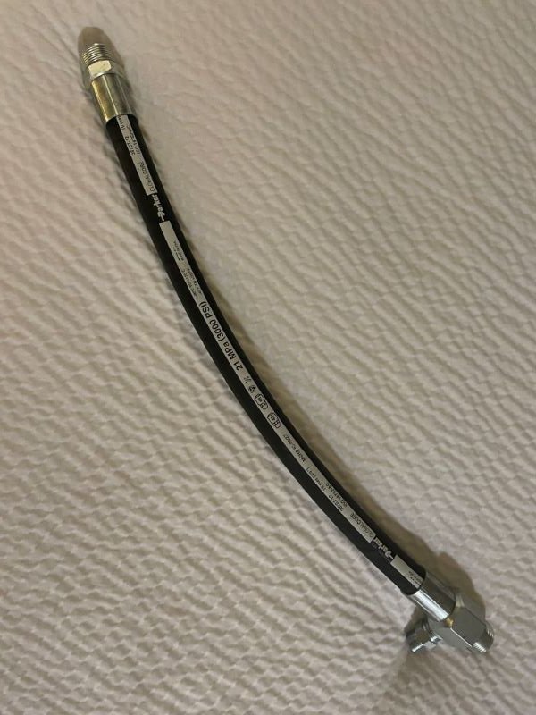

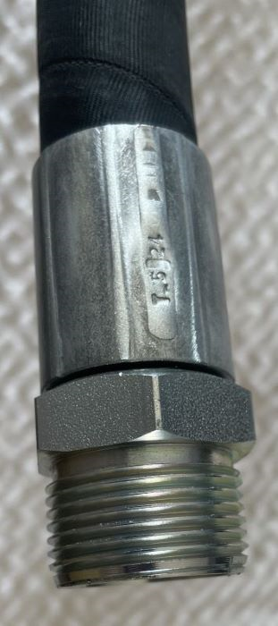

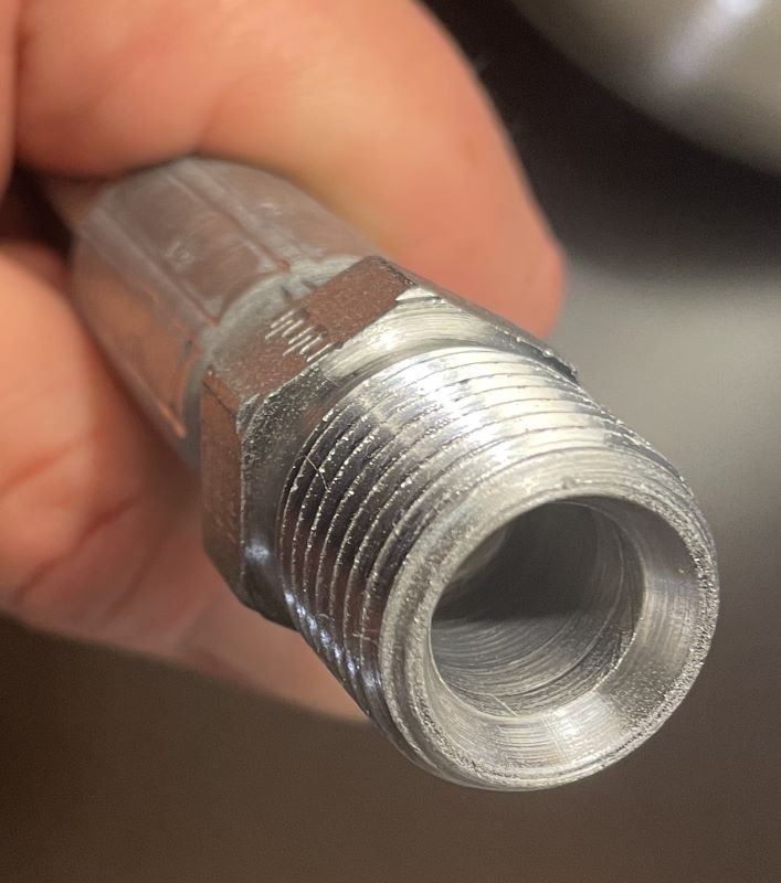

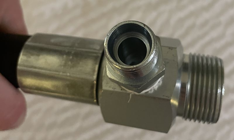

Hi, I am trying to identify two hoses. I bought these as assembled products but I want to be able to call around hose shops and get prices to have a bunch made. That means I need to be able to describe them.
Hose A
Parker 387ST-12 19mm (3/4") hose. Total length is 26 3/4"
End 1 has a male threaded fitting.
  • I can't see any useful markings
  • Diameter across the threads is 1 1/4", no o-ring, no flare
End 2 has a tee with two male threaded fittings.
  • Large connector is the same as end 1: 1 1/4" diameter, no o-ring, no flare
  • Small connector is a nipple with two different diameters. 3/4" to the outside world and 7/8" into the tee, no o-ring, no flare

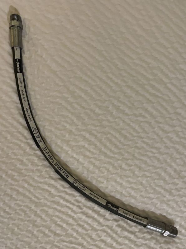

Hose B
Parker 321ST-6 10mm (3/8") hose. Total length is 22".
End 1 has a male thread fitting.
  • Marked with 1014186, EC4H, 22MM
  • Flared, no o-ring
  • 3/4" across the threads
  • I can't find 10141-X-X fittings from Parker, only 10143-X-X?
End 2 has a male thread fitting
  • Marked with ZJ11N4186, EB4S1, 22MM
  • Not flared, no o-ring
  • 11/16" across the threads
  • That part number doesn't seem to exist for Parker? I tried putting ZJ at the end, didn't come up with anything
Any help would be appreciated! Hose fittings are a mystery to me! Thanks, Andy

Talk to a hose repair place or try contacting a parker store for information and availablity on hose ends. As for the TEE end It looks to me like it was either made to be that way on site or the fitting has been used on site to make a fitting work for what ever is needed. Either way ?I would try a hydraulic shop for the information and then price around it is not going to be cheap if you have to find that specific fitting .

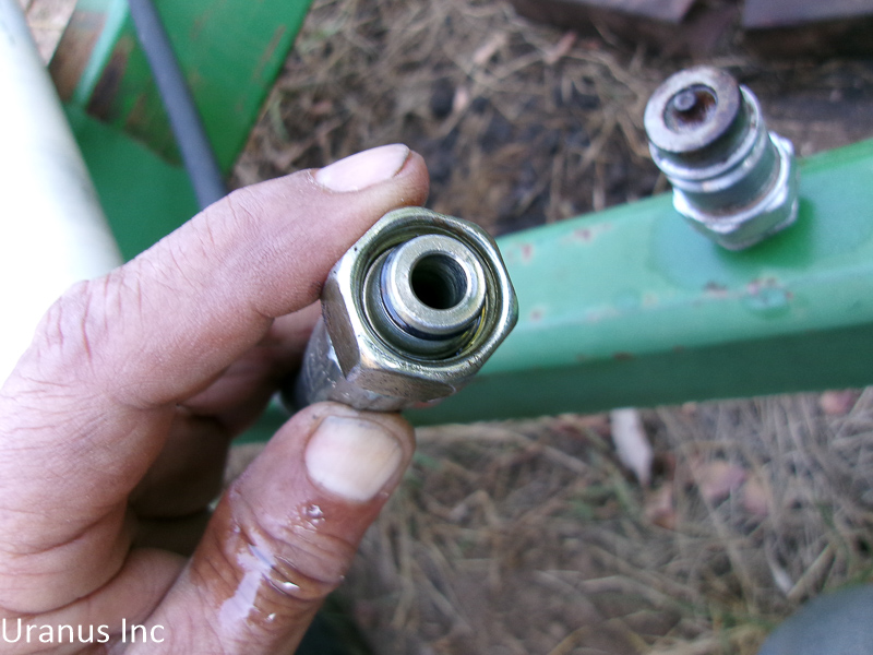

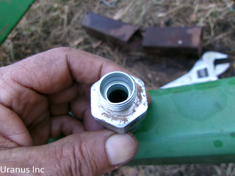

One looks close to a JIC fitting. The other looks close to an ORB fitting..........but it might not be.
Slight taper, but not a JIC taper.
The corresponding end.
These were on my Krone mower. Had to go to my Parker dealer to get a match.

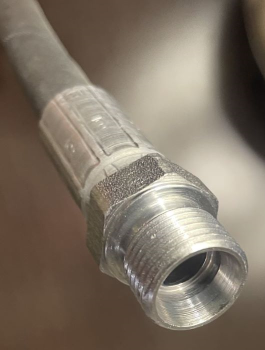

Your first hose has male DIN fittings. Metric tube fittings. Typically will mate to a steel tube with a compression sleeve and nut, but there is a female hose end version of it. There are two different styles of DIN fittings I don’t have enough information to tell which you have. As far as the end with the double connection, don’t waste your time looking for it anywhere but the OEM.
The second hose looks to be male DIN one end and 1/2 NPT on the other end. Hydraulic NPT fittings have a taper seat on the inside to mate with swivel nuts on adapters. This one you could likely source the hose ends for.

I’ve never seen anything like that ‘tee’ fitting you show. Did they custom drill out and tap a crimp fitting to create that? Can’t see it being a part you could order! Cool, but not something I would want to depend on. Hoses age and need replaced, I would not want that setup. I would want a hose end, a screw on tee fitting, and go from there. There is no reason for that odd configuration.

It made the OEM bean counters happy. When you order parts by the thousands, you can get anything you want.
Not like a JIC or ORB. More like the DIN or a metric of some type. What these hoses are on and where it was built may lend some clues. A good hydraulic shop is his best bet.
If at all possible I’d switch to jic hose fittings and keep the tee a separate piece that would lower the expense immensely im sure
