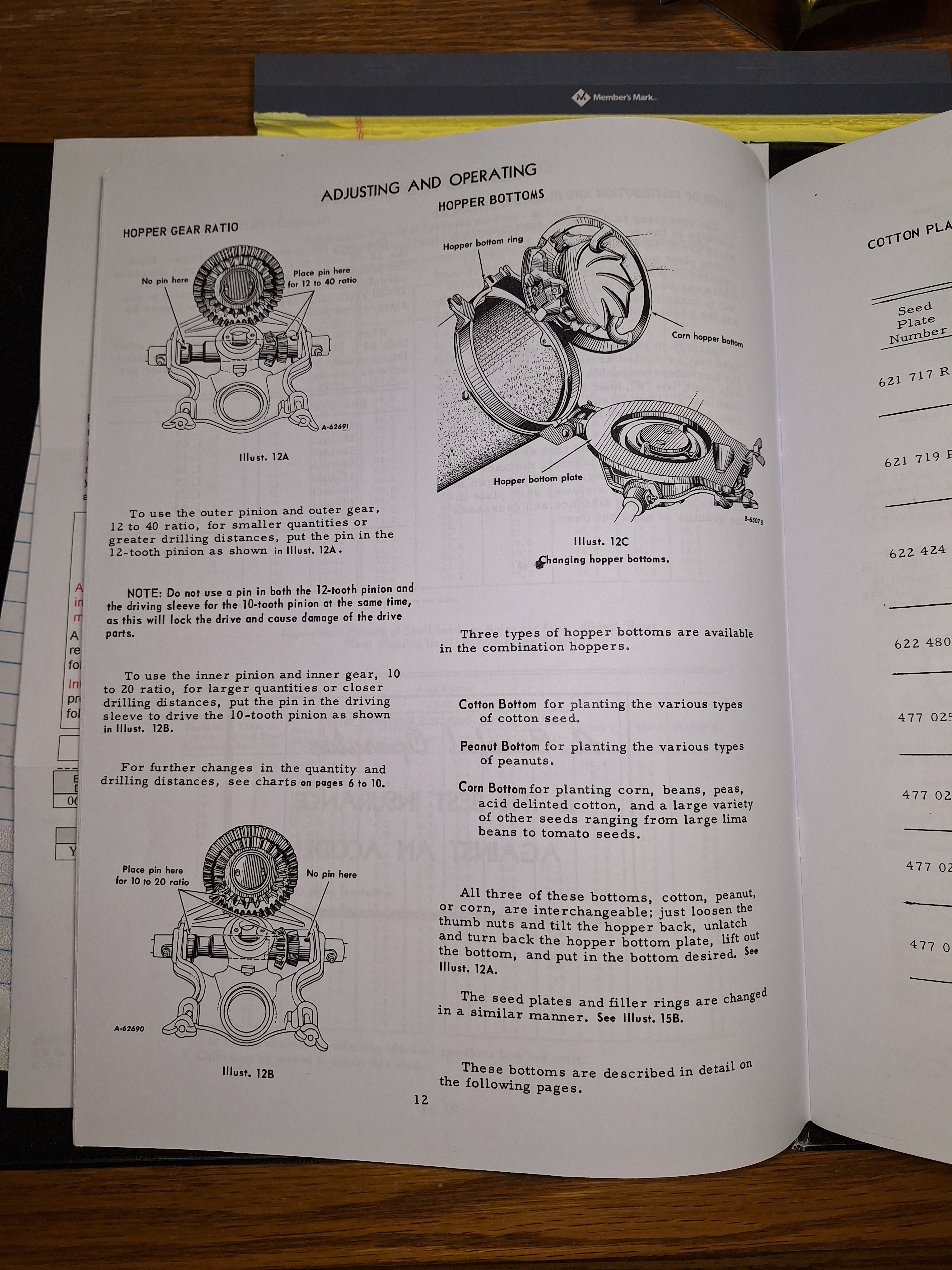

I picked this planter up years ago I never used it as I have a Cole planter and a push planter. Its a fast hitch I assume a IHC. It came with two plates, the metal one marked Medium with 8 slots and the plastic about the same size seed slots with 16 slots. I know its seed spacing my question are the plates for corn.

The best I can tell, you have an IH 184 planter like we have. There are 2 different sizes of press wheels. One is 16 inch diameter and the other is 20 inch diameter. Most that I have seen for 1 row use is of the 20" diameter variety. The seed spacing is adjusted by several factors. The first one being the placement of the pinion gear pin under the hopper for the hopper gear ratio. There is 2 choices. The 12 to 40 ratio or the 10 to 20 ratio. The second thing is the chain sprocket combination on the hopper and the press wheel. Finally, the seed plate cell count will heavily regulate what it does. If you look at the bottom of the calibration chart in the 2nd picture, there is fine print to dictate what plate cell counts not listed in the actual chart will do. In some cases like with the 8 cell plate, it will cut the seeding population in half compared to the 16 cell plate. Both plates you have appear to be for corn use. I'd have to look to see what's in ours for sweet corn use.

Thanks much when I get time I will get back to it, worst case I will just have to try it and see how it works. This will be for my own use 4 four 100 ft rows. Years ago I planted more and used the Cole planter it did ok. Neighbors are asking me to plant their corn for their use, I like doing it but pushing a planter gets old. The plates seam to be a little large for corn, can you still buy the plates ?

I found a manual for it online and printed it off. Richard are Jim NC wanted it they may be out of luck. Jim has my number I sent you a conversation thru YT. Thanks much. I coach Ball some times 3 teams at a time and will be tied up till June, I am at a ball field every night and do some instructions from home. This time of year that eats my time up.
