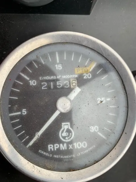

An exact original tach may not be available for this model. It's an "oddball" at the time. The only one out of the entire 84 series built in Bradford, based on the B250, B275, B414 lineage. The larger 84 series were built in Doncaster based on a different design. Best place to look is on old auction and tractorhouse listings, such as this: https://www.proxibid.com/lotinformation/60413826/international-384-tractor
It shows a simple tach:

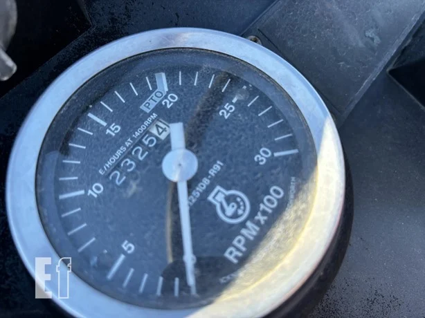

Another one from another listing:

Barnyard, you have jogged my old memory and I believe your photos of tachometers is correct for a 384. It was different than the B414 and 434.
