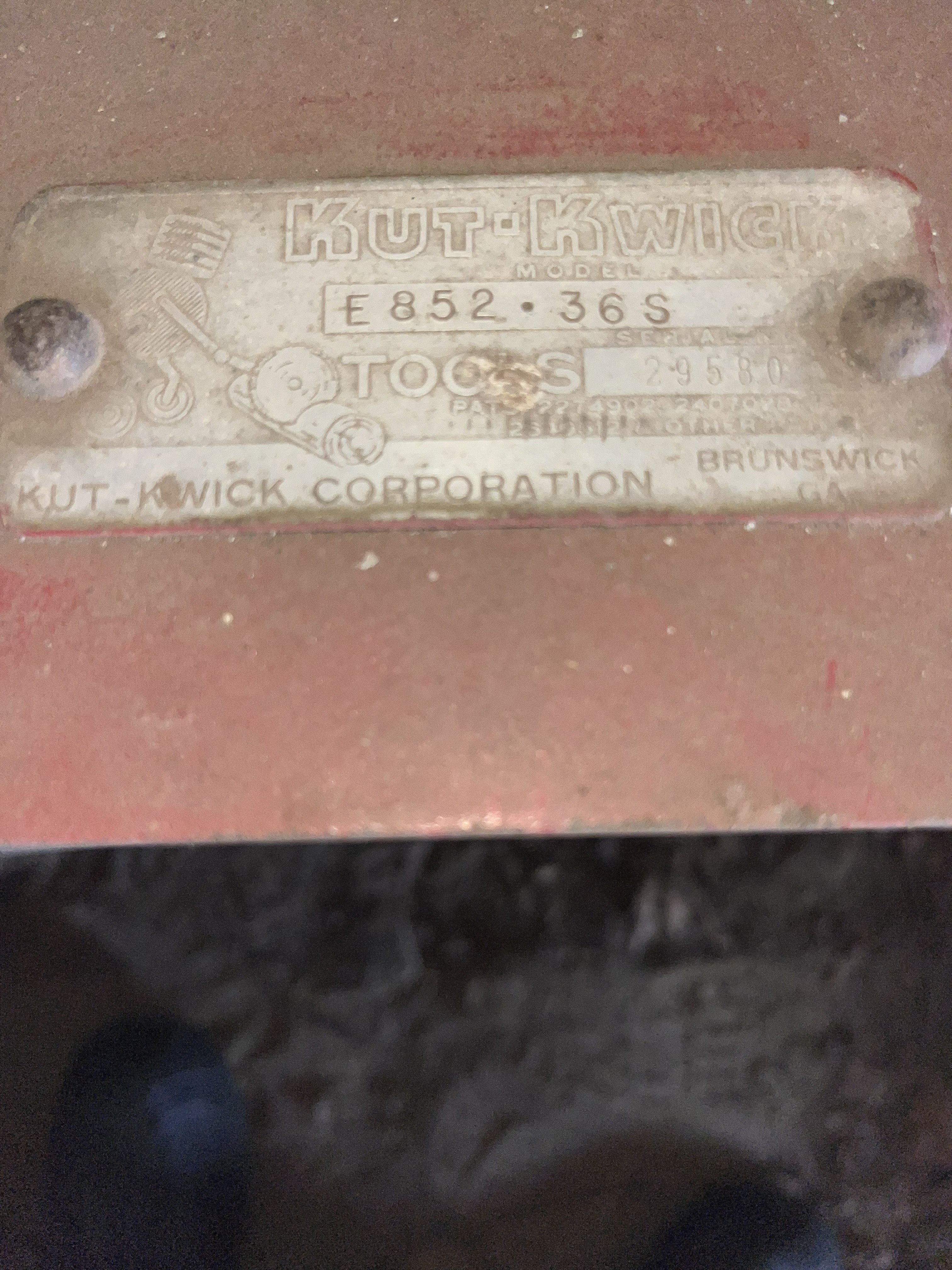

Also, the data plates have been painted over; how to I clean them without obliterating the lettering underneath?

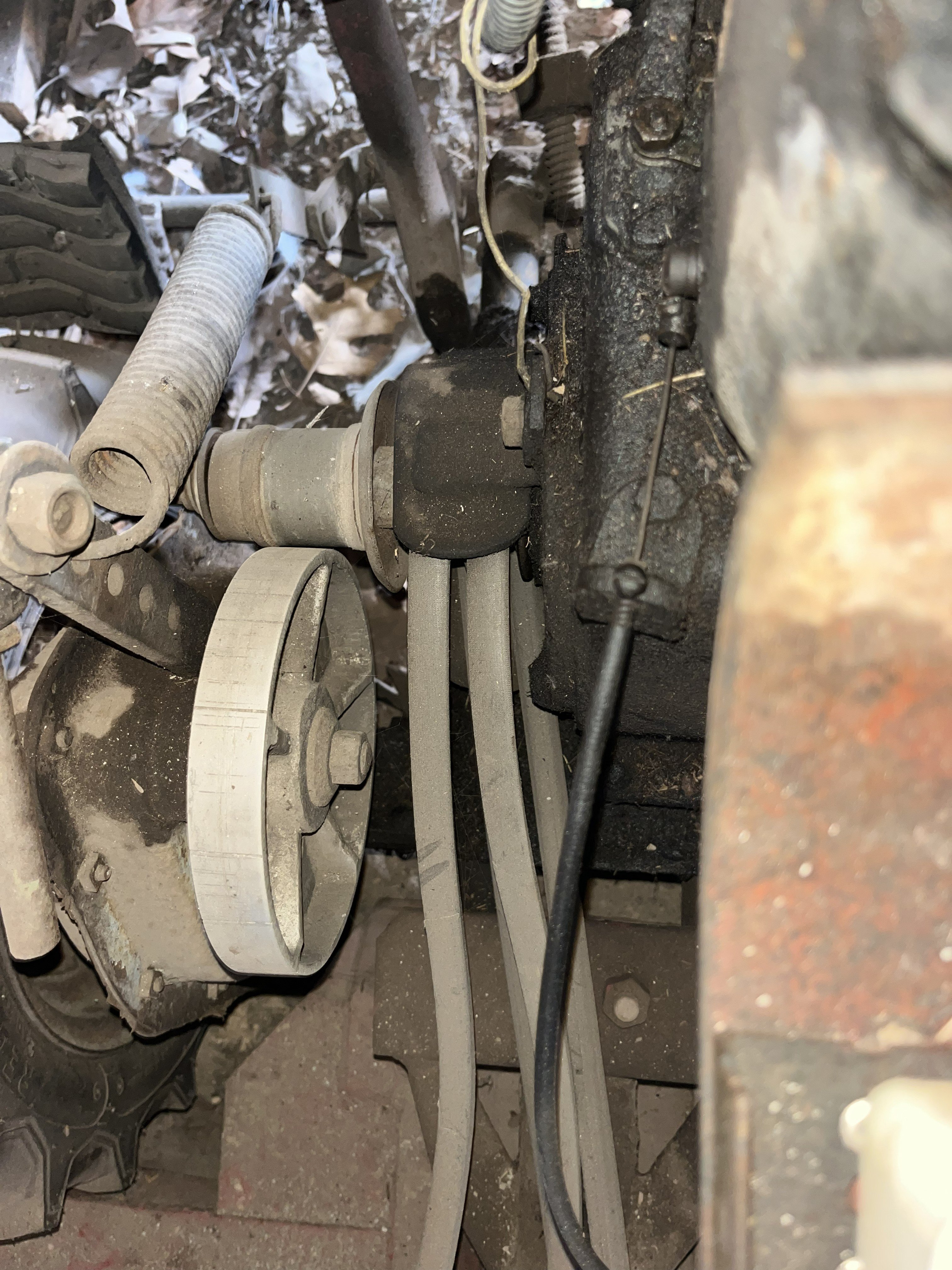

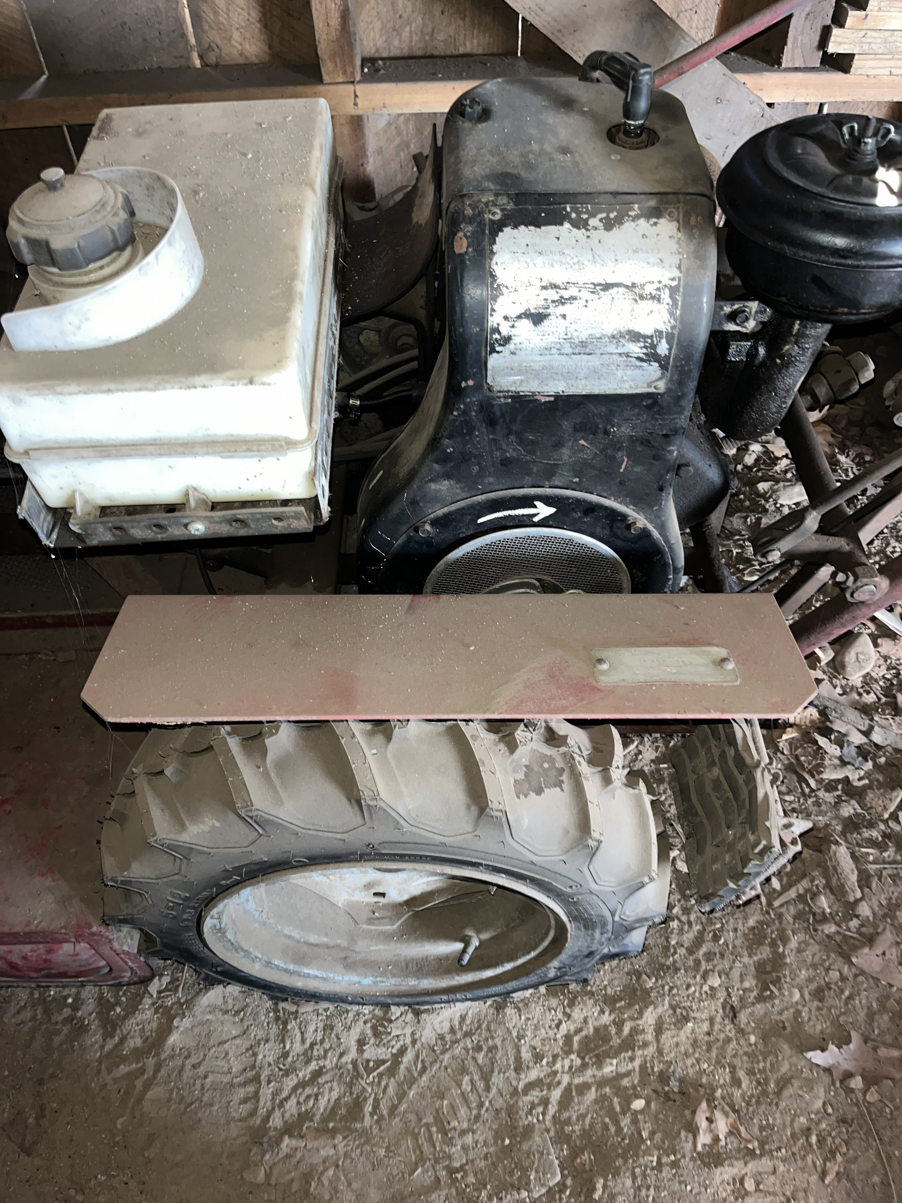

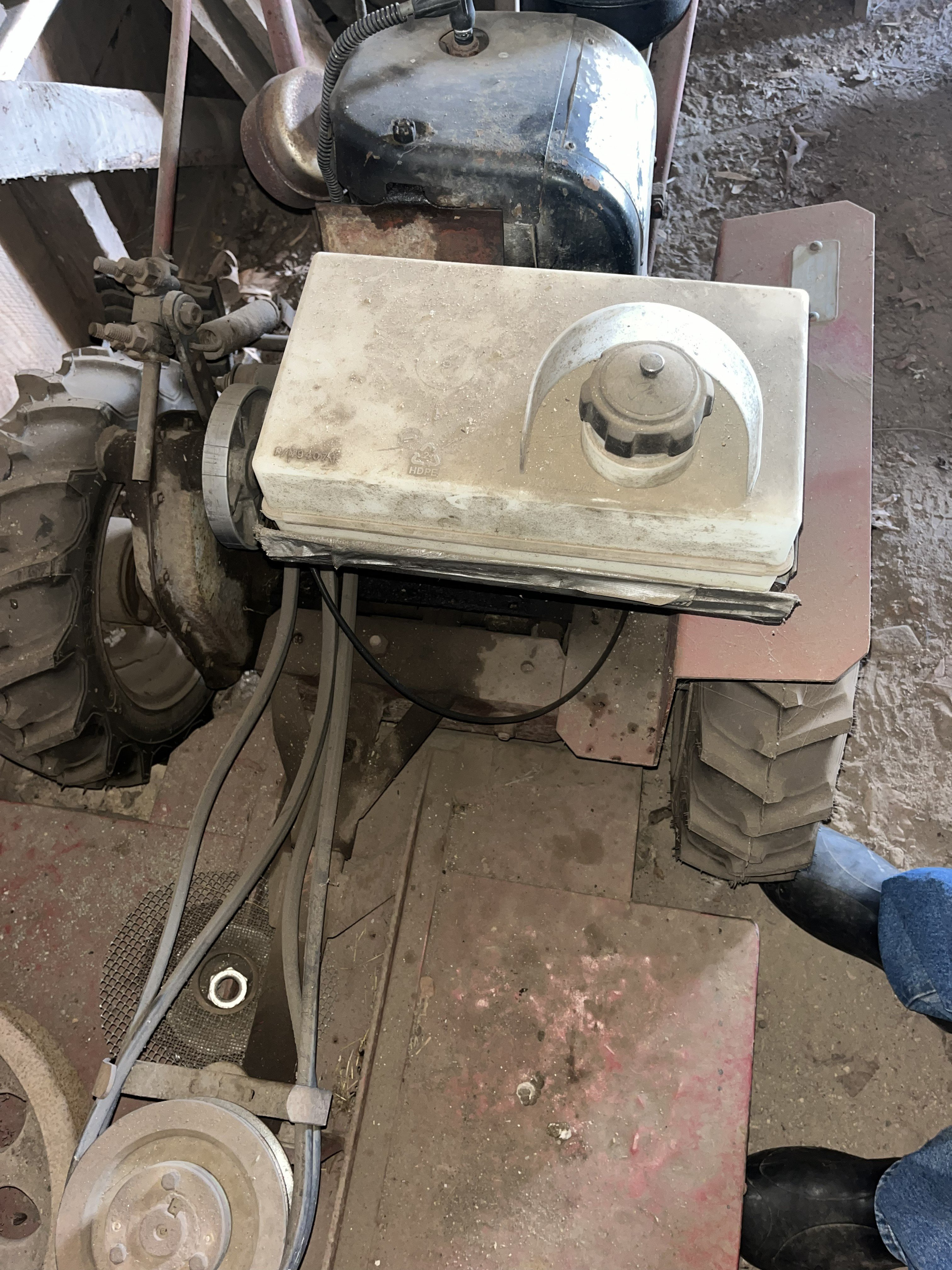

This machine is still a mystery to me especially the drive mechanisim. Still looking for any documentation. I'm attaching some pichures but it is parked in the shed so hopefully they are good nuff for the moment. The engine is single cylinder Wisconsin and began misbehaving last summer with a bad knock so I parked it. It apparently has been modified a lot by the shop people who were responsible for it. It belonged to the C&O canal in Maryland. The way it is right now, it has no brakes at all not even engine braking, constant posi-traction forward which makes hard to steer, no reverse, no variable speed and no sulky. I think it should have all of that but I'm not sure. Without brakes and reverse it is almost useless to me so I'd like to resolve those then I might think it worth looking into the engine. I appreciate any insight on this machine. If I need to I can drag it out into sunlight for better view. Thanks, Michael

I am [email protected] and you have a usual old single cylinder Kut Kwick (KK). That has the usual Wisconsin like 7.9 Hp engine that is marvelous and almost bullet proof. Sorry I only accidentally came here to find your note and photos. The main problem your machine has is the friction disks are almost completely wore out. They are supposed to be about 5 inches in diameter new and yours are all worn to 2 inches. Sadly these are no longer available so alternatives must be found. since I have been last on these machined some 9 years ago I can not be sure but that is likely why you can NOT pull back the drive handle and reverse the machine. Do write to me and I will share more information. [email protected] and happy to help.
