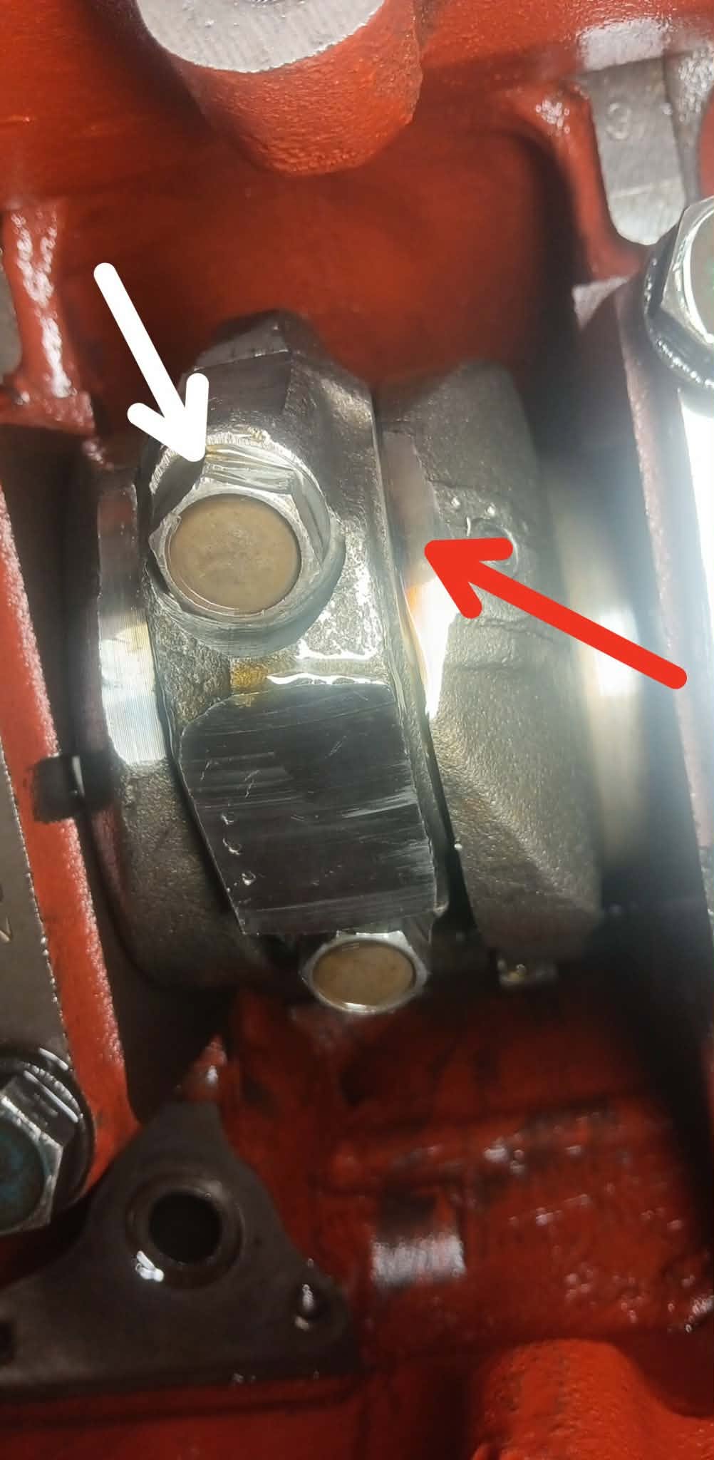

Long 610 4 cylinder 102mm. Full engine rebuild: new pistons/rings, cylinders honed, new rod bearings, and a complete gasket set. Before the rebuild, I had the injection pump and all the injectors rebuilt. But it sounds like it's knocking, and it gets worse when rpms go up. It's not the valves or the injection pump timing. Note: At idle, oil pressure is 25psi, revved up it's over 50psi. I've got about 2 hours total of run time, and I don't think
the knocking has gotten any worse.....

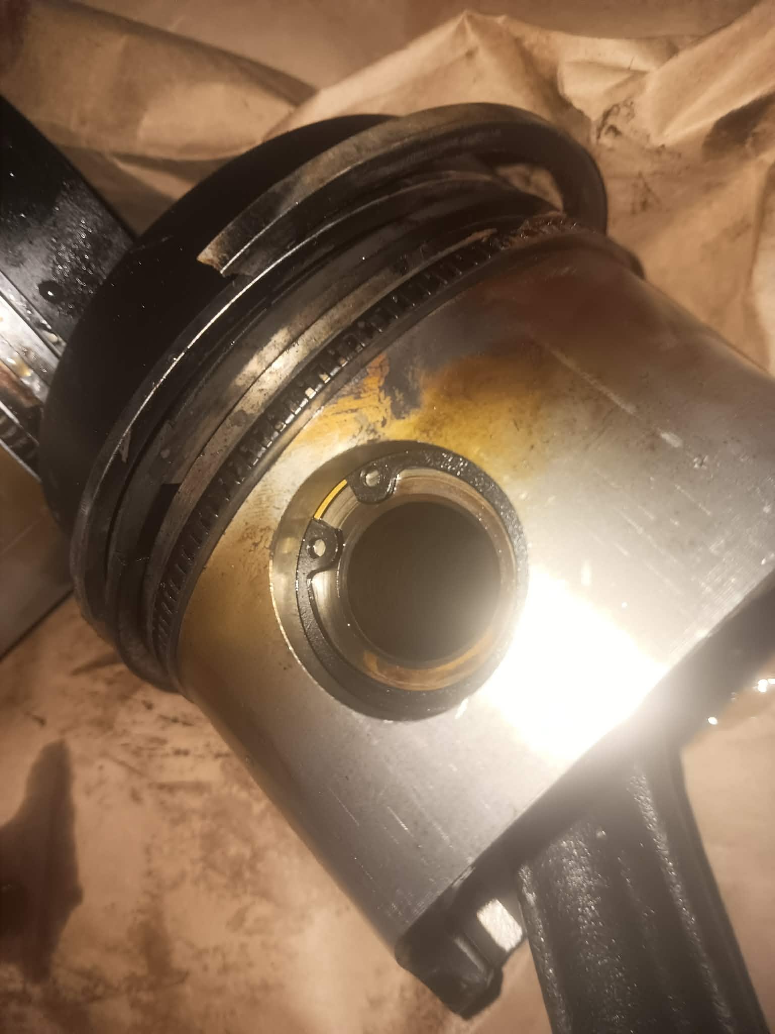

and found 2-3 little pieces of aluminum (old piston -2nd pic- pieces I missed when I flushed it out?)

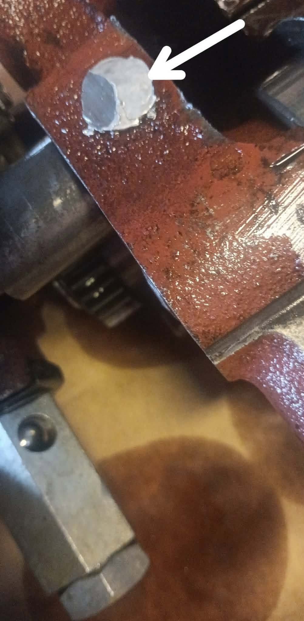

3rd & 4th pic: It's the top side of the counter-balancer/oil pump (what are those 2....spots? I can't tell what they're for)
5th pic:
if you look closely, it looks like fresh rub marks on that spot
6th pic: rod bolt idk if it's got fresh rub marks on it -white arrow- but I can feel a burr when I run my finger across it. Red arrow, it looks like it's got hot at some point

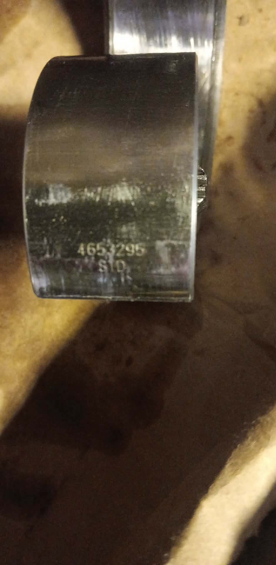

last 3 pics: rod bearing
