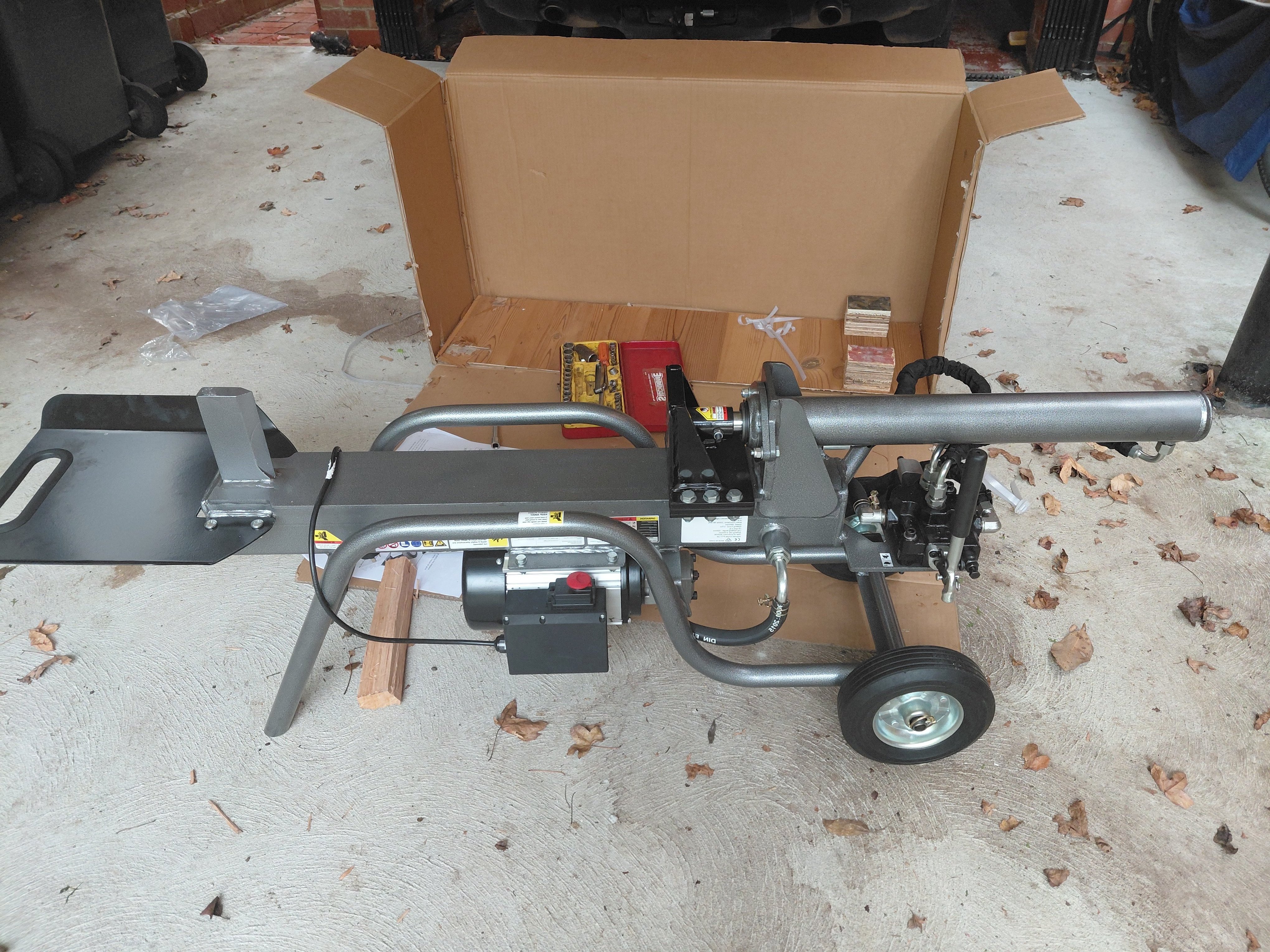

I would like to confirm the claims that the wood splitter I've just bought has 14 tonnes of force . Rather than hydraulic pressure it is the power developed by the ram I need to measure .
Is there a straightforward way of doing this I could try ? Either mechanically by direct method or theoretically by calculation .
I suspect that they are over inflating capacity , either this or calculating the ram power against the thin edge of the splitting wedge .

If you know the max pressure of the pump and the size of the piston in the cylinder, it's simple math: Pump PSI times Area of Cylinder.
Example: 2500 PSI at the pump, 2.5 inch cylinder. Area of the piston is Pi x radius squared or 3.14 x 1.5625 or (rounded off) 5 square inches, times 2500 = 12,500 pounds. Divide that by 2000 to get tons or 6.25 tons.
EDIT to correct formula (Thanks, Daniel)

Not quite. Area of the cylinder is pi *r^2 [or (pi * D^2)/4].
Pi * D is circumference, not area.
I think the best way would be to measure the hydraulic pressure with a gauge, then use that to calculate the force. 100 percent of the fluid pressure will be converted to linear force, which you calculate by multiplying the pressure times the cross-sectional area of the cylinder.
In order to directly measure the linear force you would need some sort of load cell, and load cells that can measure 14 metric tons are not cheap.

No specifications listed on the pump at all . The only information on the splitter itself is the 2200W rating of the electric motor .
The distributor is going to ask the manufacturer for the specifications, if i get these i will report back .
Put a load cell on it if your handy .we have them in our high presses attached to the columns , stopping that baby on a dime (actually better) at 200 strokes a minute , , Got to have it, the money we’re talking about losing making muti hits on our dies sets.
