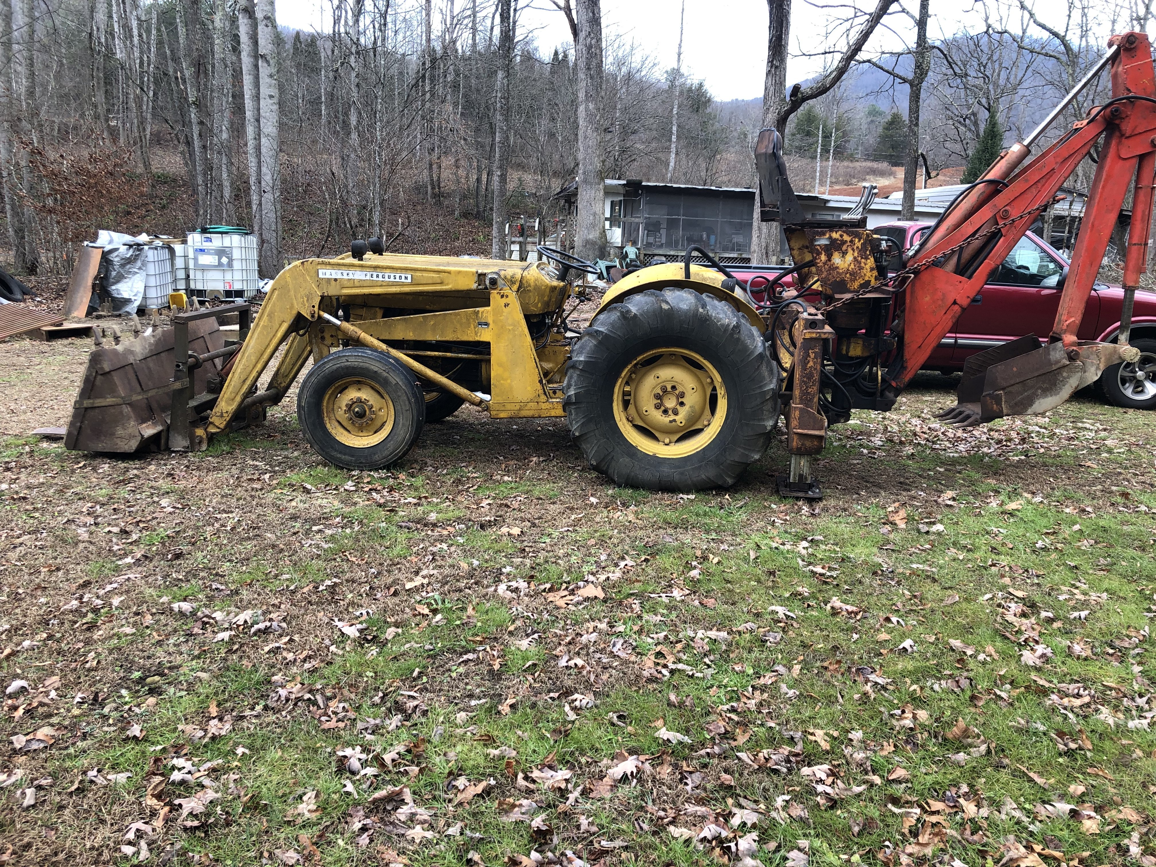

I purchased an older MF 2135, gas tractor 4 cylinder with MF loader and an off brand looks like attachment backhoe. The backhoe is welded the the undercarriage bracket of the loader.
My question is on hydraulics, there’s a front pump. It feeds both attachments.
Neither work without putting a spooler lever fully released (return mode) on the opposite attachment.
Ie to use the backhoe the loader bucket control lever has to be locked or pinned in the up position. And all backhoe controls in neutral position, Then the backhoe works.
Conversely for the loader to work the backhoes right side outrigger needs to be pinned held in release down position.
There’s got to be a better solution.

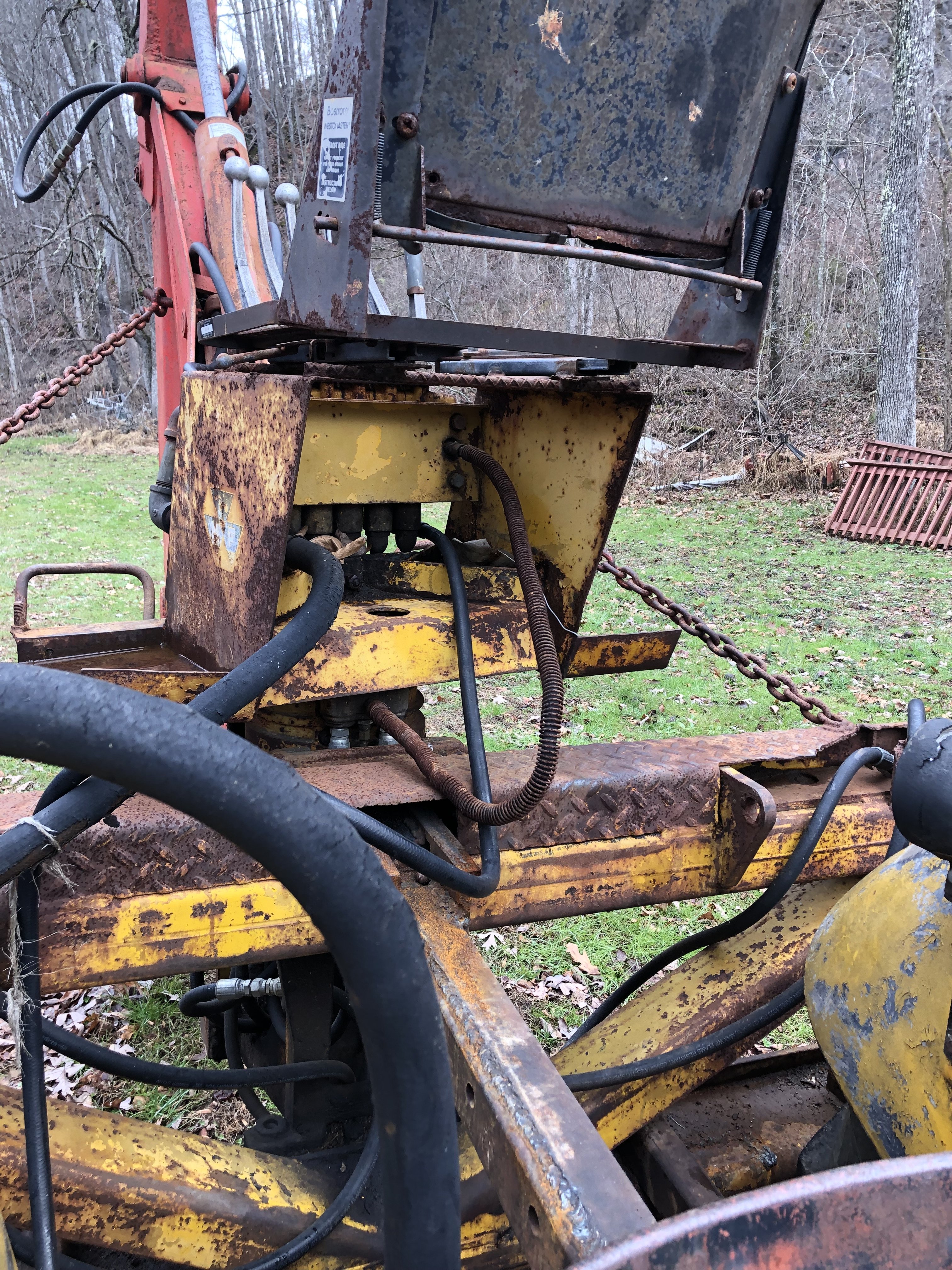

It sounds like your machine is set up with a diverter valve to swap the hydraulics between the loader and backhoe. I believe it would likely take some major plumbing and at least one control valve replacement to properly set it up with power beyond hydraulics which would eliminate that diverter valve.
Post some pictures of your complete machine and the valves and piping to give a better idea of the set up and that might get your loader and backhoe identified.

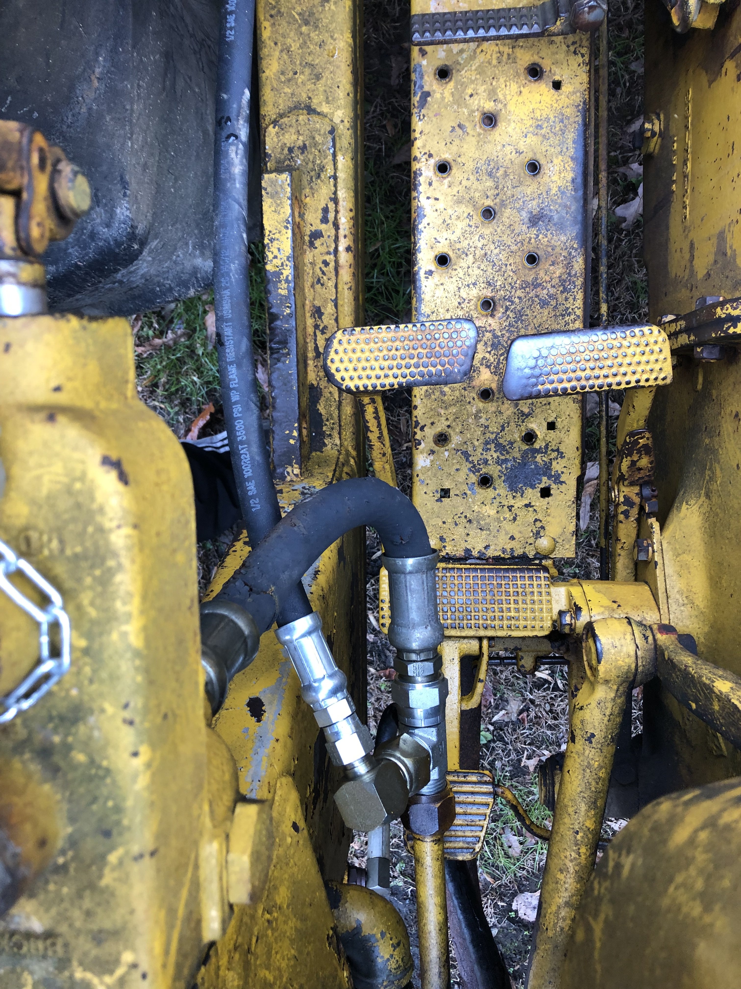

From what I’ve visually seen the pumps supply line come to a tee one feeds the loader controller, the other to the hoe controller.

That answers my question, it is connected as I guessed and is confirmed by you saying the two are supplied by a tee.
You need a diverter valve like #906154 the 6th one in this linked list. Possible valve Unless the piping is 3/4”
You would either mount it at an accessible location for the operator or mount it where an extension rod would be used to change the control knob in or out.
There is a possibility that the loader valve could be capable of a series connection but for that it needs a 2nd return to the reservoir to allow discharge fluid from the spools a path back to the reservoir. Photos might give enough information to assess if that is possible.
