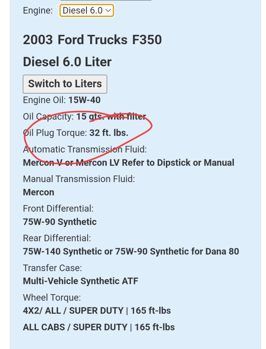

Both type torque to 18-20 ft lb.

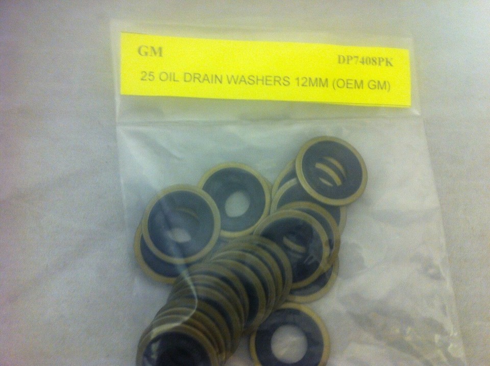

I will try to make it clearer. It still has what I believe is the same plug or at least one that takes a copper crush washer so no groove for an O-ring, or an O-ring. It is the type of plug that takes a copper or aluminum crush washer, but instead of a crush washer, it has a steel washer that has rubber bonded to BOTH sides. The rubber is about 1/16 thick and the diameter of the rubber is about 1/4" less than the OD of the steel. It seems to me that with the rubber taking the full torque it would not take as much as a crush or aluminum washer.
This type.
They are actually better than solid or crush washers. The rubber seals while the metal keeps the rubber from getting crushed or damaged.
Edited to add... I just pick a random model year to show.
