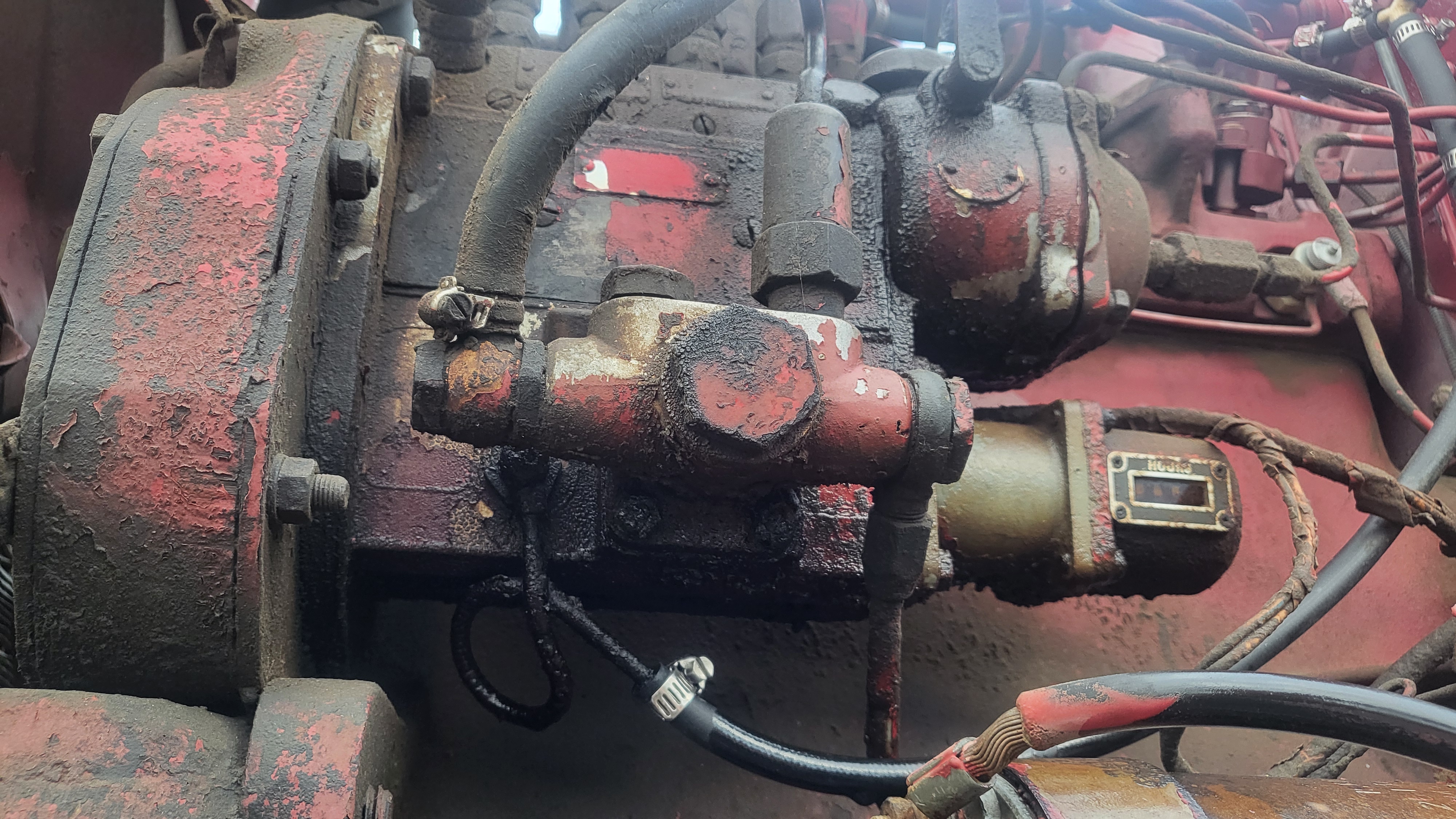

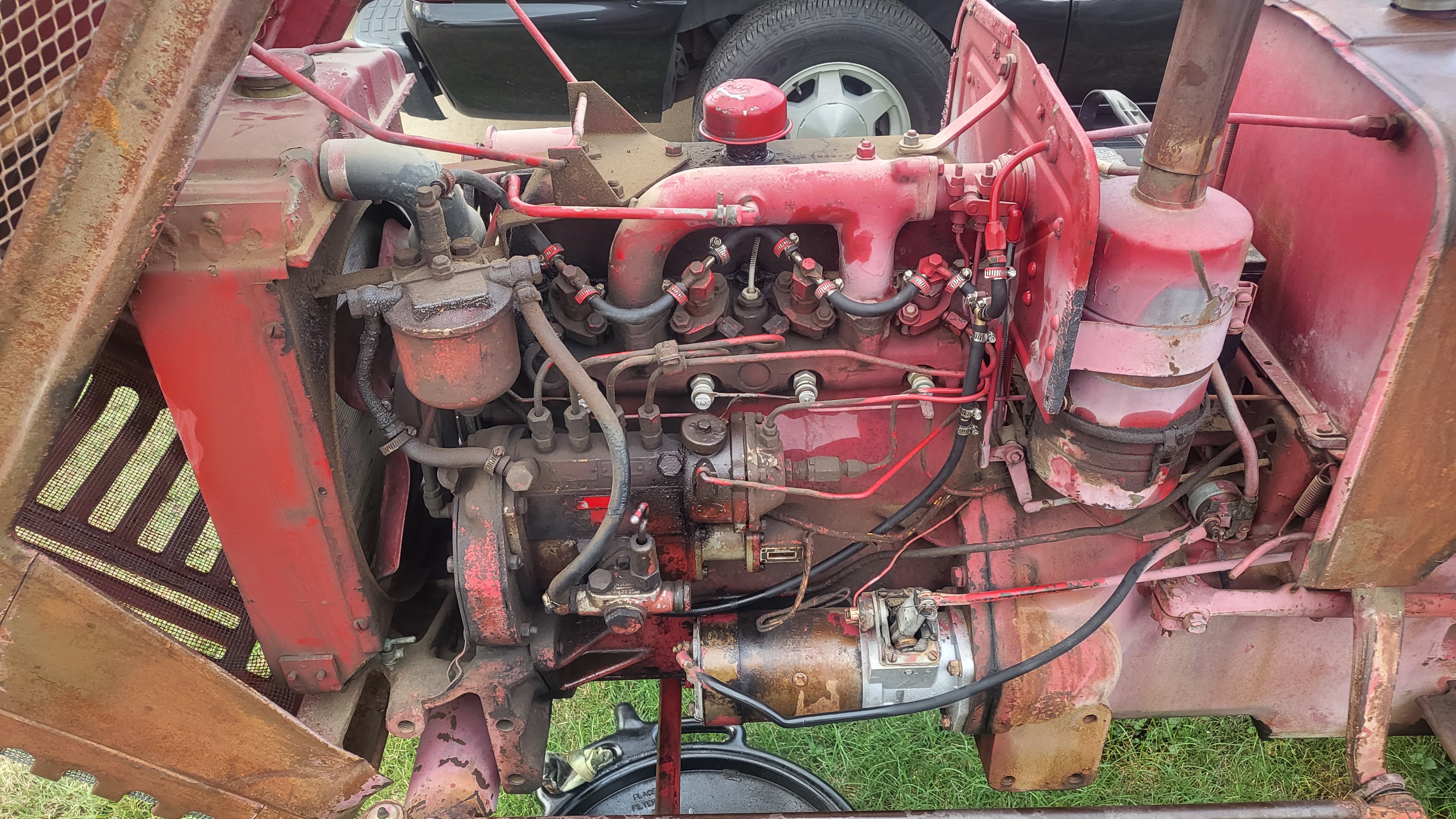

I just got a 1960 B-275 diesel. Runs pretty well but looks rough. I'll be using it around the property, and as we bond a little and trust grows, I might take it to shows and parades etc. . . . casual stuff. Somewhere along the way it's getting fixed up quite a bit. Probably not a full frame-off etc. but I definitely want it to look younger and maybe leak a little less!

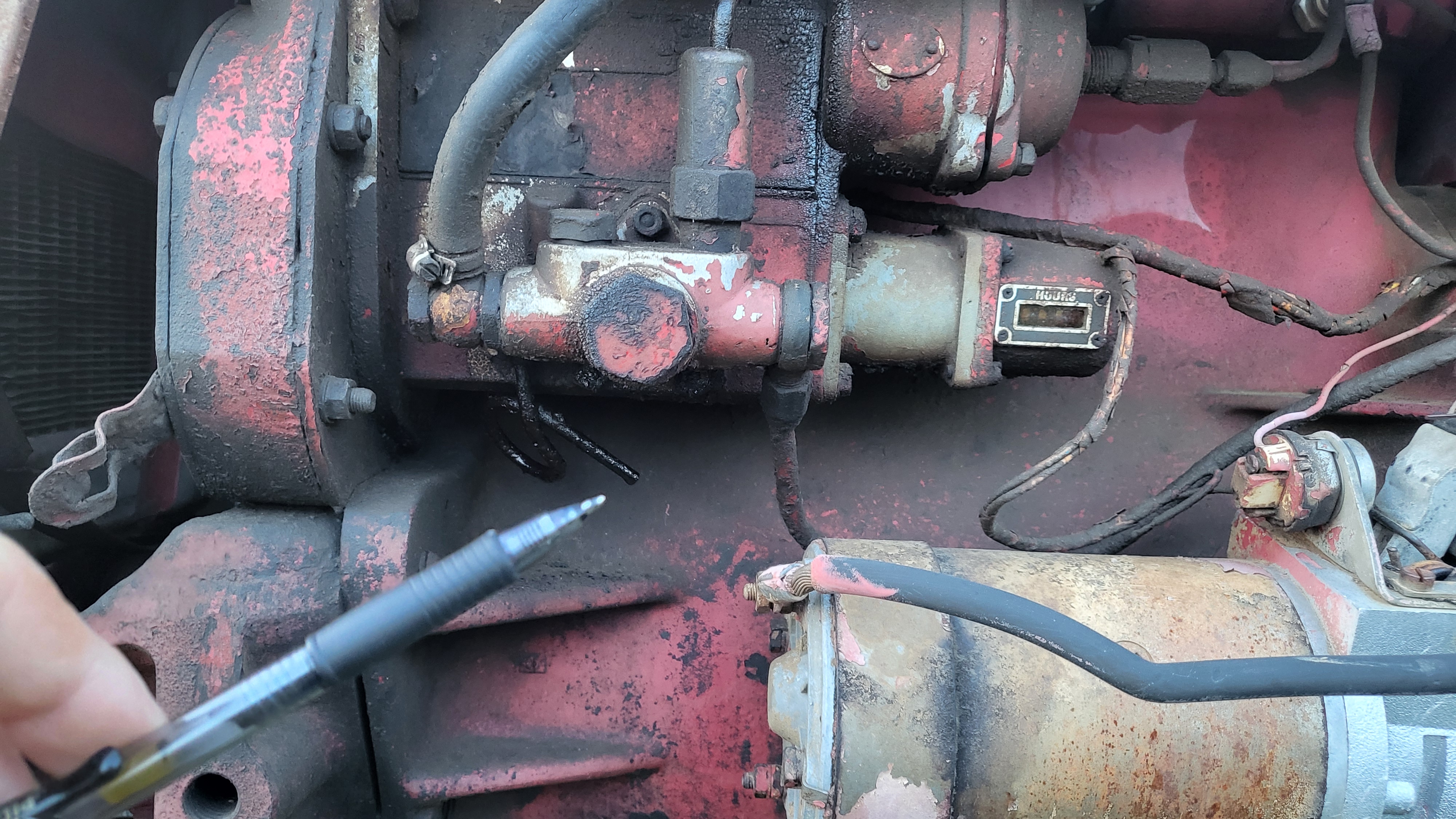

I'm sure I'll have many questions going forward, but so far I only have one: What is this little tube that my pen is pointing at?:
It produces a continuous drip of diesel whenever the engine is running. Previous owner says it has always done that.
If it is normal for some reason, I'll plan on figuring a way to filter it and return it to the tank. If not, I'd love to fix it!
Thanks for any help!
--CathedralCub

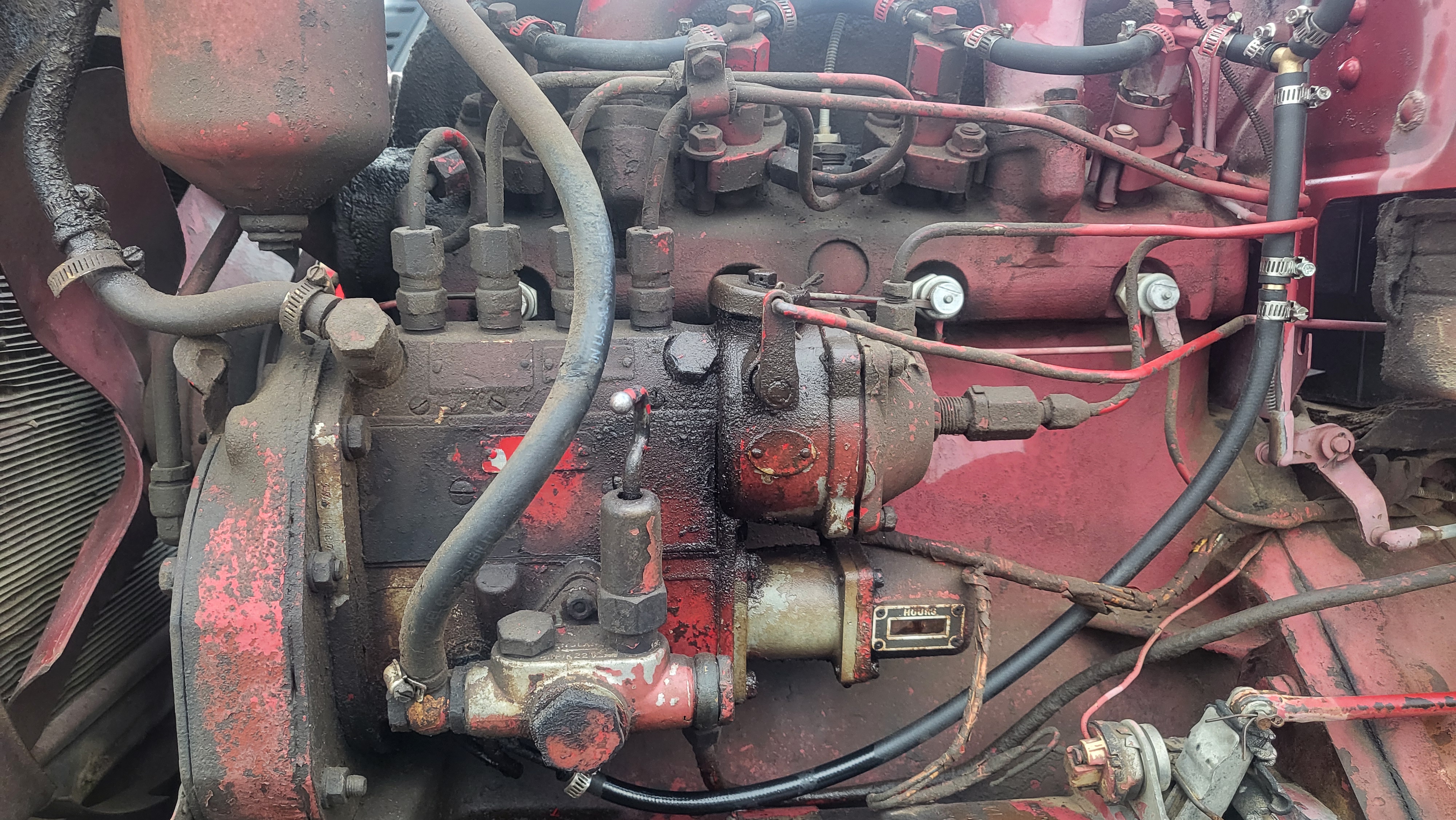

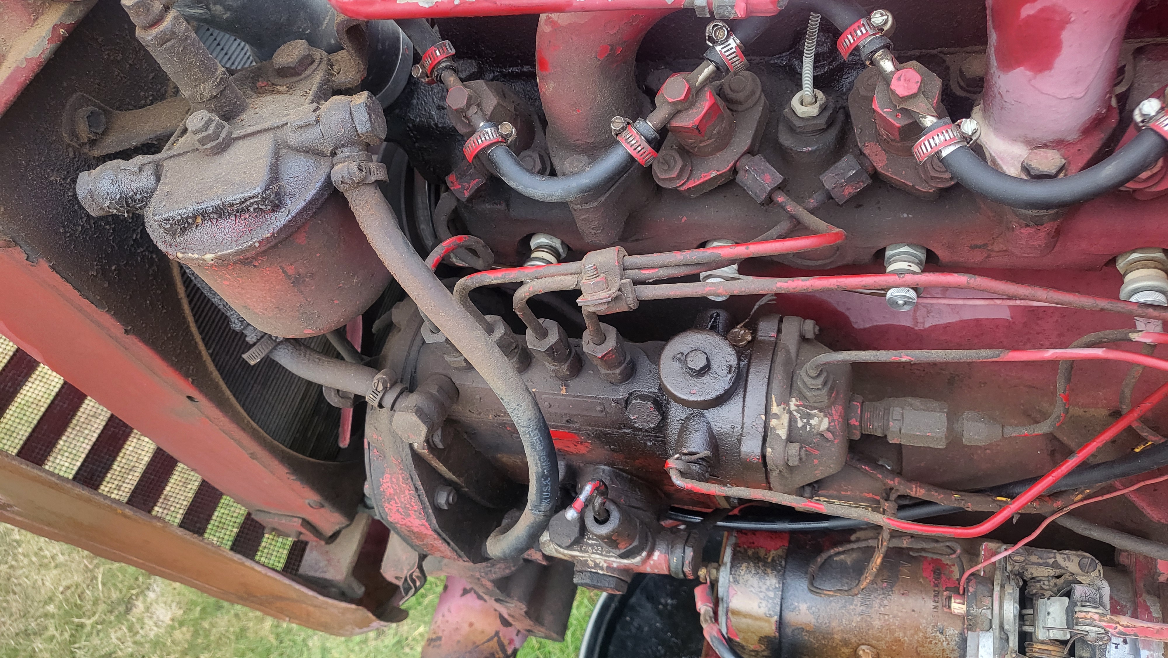

. . . so . . . I replaced all of the rubber lines in green and added the line and tee in red:
. . . and then started it up. It ran fine for about two minutes, then suddenly started gushing diesel out from under the thing circled in blue and started running rough.
I shut it off and the gushing slowly subsided.
So now I'm thinking that maybe I've added a path for the return fuel to siphon down from the injectors through the tee . . . ?
I can't find another path back into the tank for fuel return. I'm betting I don't need to add one, as there must have already been some solution for this.
Maybe a check ball inline in the red path?
What do y'all think?
Thanks!

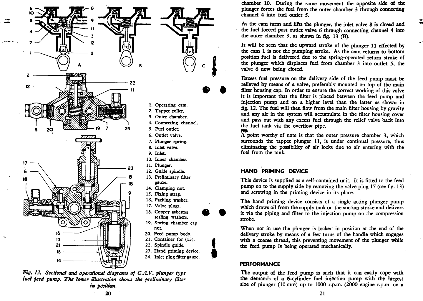

Could be causing excess back pressure on the input side of the feed pump or the valves inside the feed pump are not opening and closing properly. See photo below of similar feed pump but there is a sediment bowl on the bottom right of feed pump.
See top left of page on the feed pump action driven by the cam in the injection pump, and how it pumps the fuel.
Usually the lift pump just leaks around the hand pump lever. Neighbor had a B-250 with that style of CAV injection pump.
Never was into feed pump, only changed fuel filter for him. Drove the B-250 frequently.
Hope this helps.
your injection pump is an inline pump. that control on side of it must be a primer. I would probably bypass it with the fuel lines to eliminate the leaking. This is a different pump than the one i had. I am putting up some of my setup. Mine smoked uncrontrollable so i removed pump and sent it to Dieseltech for a rebuild. Worked good after that

His B-275 has the older CAV inline pump like the B-250 and the part that is leaking is the feed pump and the hand primer. Usually they leaked around the hand primer but his appears to be leaking around the inlet. Later B-275's had the rotary CAV pumps.
One thing I forgot to mention was to make sure the hand primer was turned down tight, it has been 60+ years since I changed the fuel filter on a B-250 but I remember having to turn the hand primer lever one direction to release it and then you could pump the plunger to prime and then you had to push the handle down and turn it to lock it in the run position.
That tube is the CAMBOX OVERFLOW DRIP TUBE. It SHOULD BE LEFT OPEN, and NOT plumbed back to the fuel tank. Ford/Simms pumps had the same tube.

That small tube is there to drain the diesel that leaks past the injection pumps; this will be minimal in the tractor’s early years but will gradually increase.
When the dripping turns into an almost constant stream of diesel, it’s time to overhaul the injection pump, install new plungers, and adjust it.
