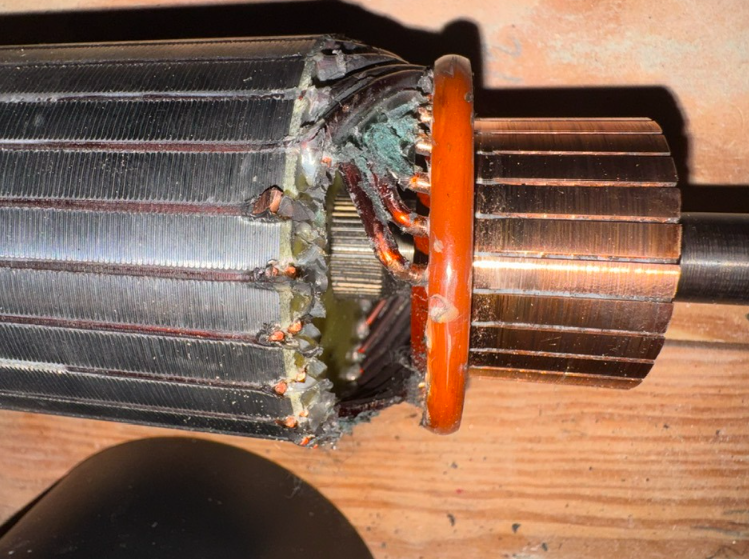

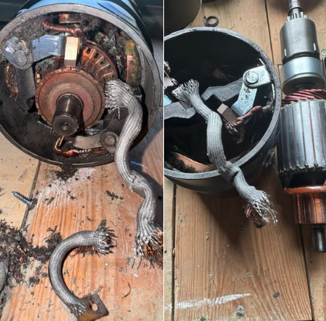

This starter on my Massey Ferguson 50 has only been on the tractor since September.
It was a fairly cheap starter but seemed to be working fine until today when it wouldn't do anything.
Upon taking the starter apart it was obvious why. The entire insides were pretty much shredded.
The only thing I can figure is maybe the gear got stuck against the flywheel the last time I ran it and it was spinning the starter the whole time I was mowing.
Funny thing is the gears look fine.
Has anybody had this happen or know why?

Did the screw come out of one of the positive brushes, or did the brush break? I can't for sure see what all is missing, but if a brush was flailing around in there I suppose it could cause damage.
It was so chewed up in there that I really can't tell. Then again I'm no expert and would have to have a new one to look at to try to put the puzzle together.
Whatever that part to the right is called is supposed to have those 1/8" copper wires around the top and bottom but that section at the bottom are all stripped off.
The electric wire you can see is chewed all up
I don't know where the screw lying on the bench came from but it was loose in there.

I'm thinking it would probably be beat into carbon dust before it did that kind of damage, but could be wrong (y)
Can't tell much from the pics, looks like a bunch of carbon dust in the bottom of the first pic.

Yeah it was pretty much full of carbon looking dust and pieces of copper wire and wire insulation off of that other wire that is ripped in half,
Plus that screw and unrecognizable stuff.

first time i have seen what looks like a sheet metal screw in a starter. so i would presume the screw came loose and the brush must have turned then fell apart . where is the other brush ? like to see that. looks like your right it is a cheap starter.

if the drive stayed engaged it would have thrown the armature windings off.

Unfortunately for you I would say Bob has you answer. My guess is the “wood screw” is a self threading screw that threads itself into the plastic positive brush holder but didn’t hold sufficiently or cracked/broke it. Very likely a “land of almost right” shortcut assembly process. That’s what I’m seeing. Someone with a little experience, with the proper replacement parts and the ability to solder could probably resurrect it.

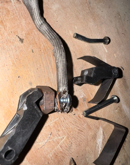

I can't remember what type of screw holds the live brush to the plastic. I don't remember if it is a machine screw or a type of self tapper. I should know because I've had plenty of them apart. But it's been 40 plus years, so I don't know. Regardless, it wouldn't be all that difficult to strip out the plastic, or force the wrong screw in there, spread and crack the plastic. It's a machine screw which holds the ground brush to the metal holder. It goes through a thin enough piece that I suppose it wouldn't be all that difficult to mess that up too.
I found a matching screw like the one that was loose. I holds a copper lug where the insulated wire attaches.
I don't know for sure it it coming loose was a cause or effect of damage.
You can also see the pin that holds that arm is badly bent.
Welcome to YT. I think it's pretty obvious that screw came loose. I've never seen brushes connected that way. I've only done Farmall and old car starters but that kind of screw for that connection seems like it couldn't last. I don't know where you got that starter from but that looks like a refund to me.
