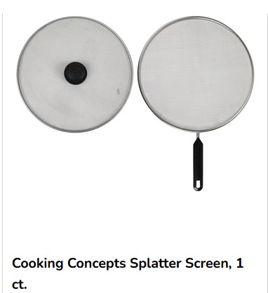

Parts, no doubt, are for specific mystery funnels. Could use a paper paint strainer or Dollar Tree's $1.25 11.5" spatter screen to strain the fuel.

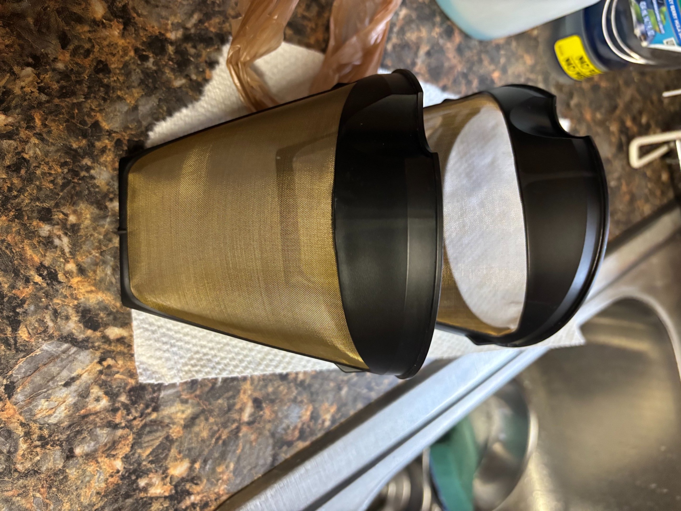

I have a lock in funnel as well. When my screen filter disappeared had to cut out a replacement and shape to fit the funnel. You're looking for 100 - 200 gauge mesh (US measurement) which is adequate for initial particulate filtering that may have found it's way into a fuel can. Or you could sacrifice an inexpensive cooking filter as circus suggested.
