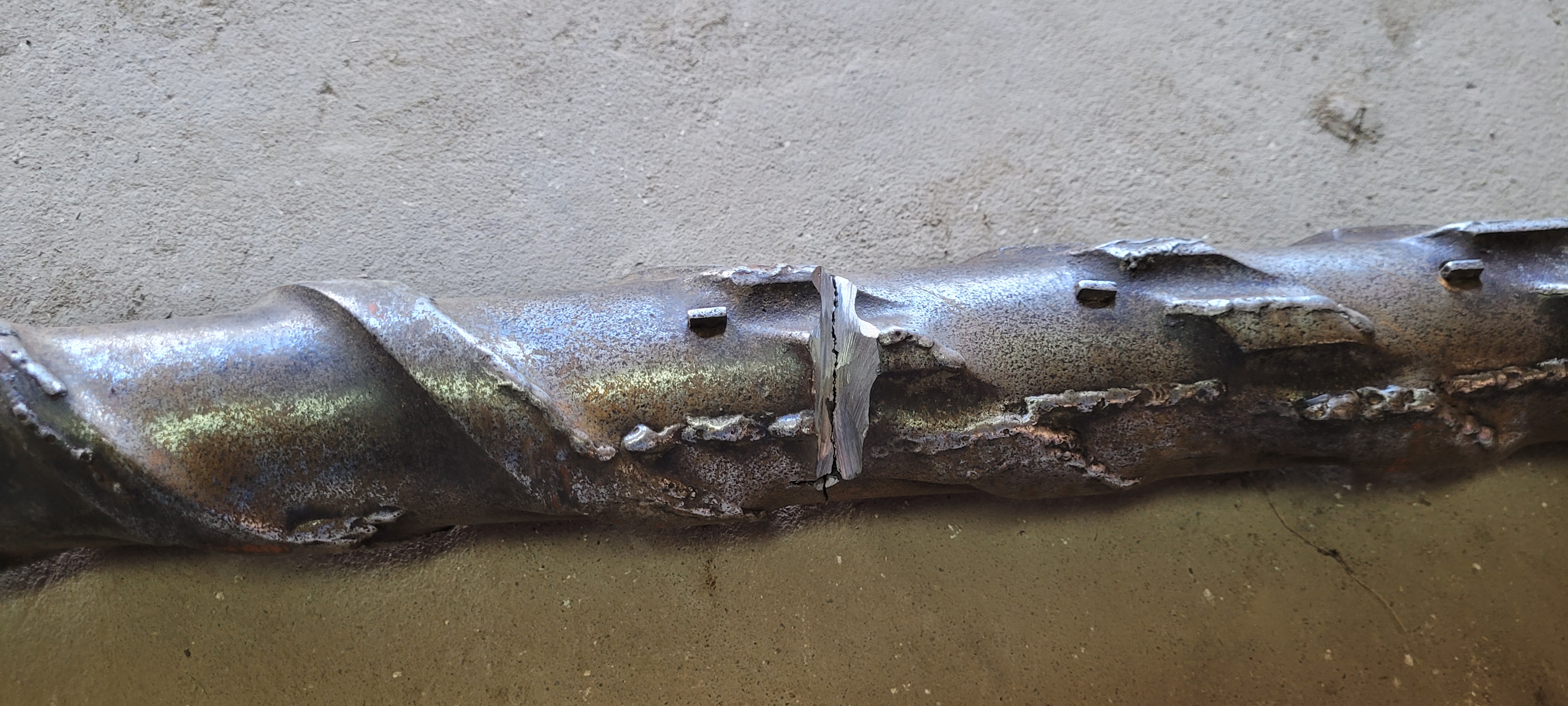

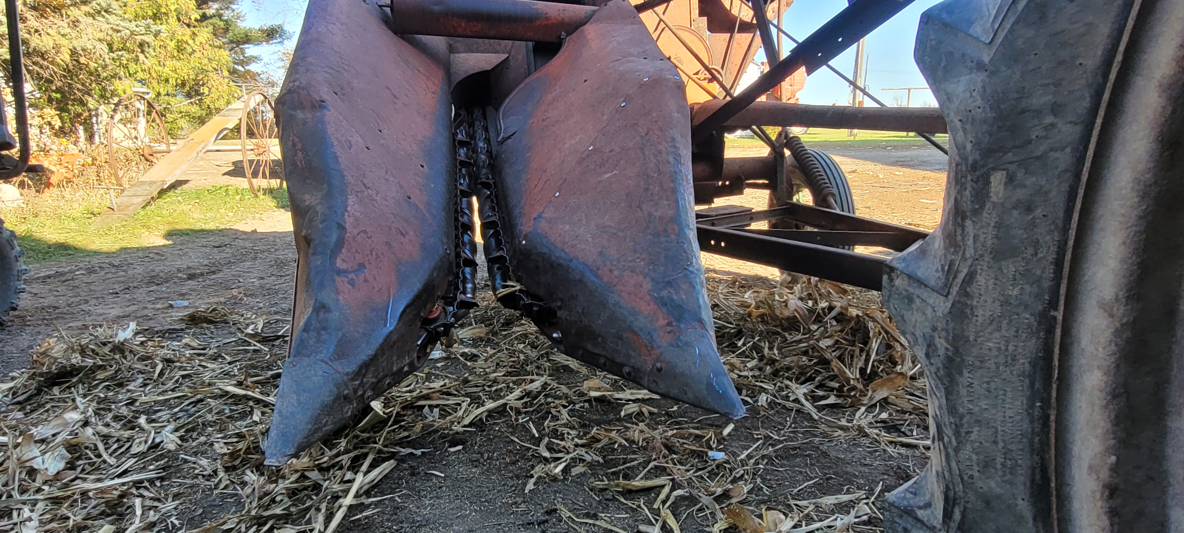

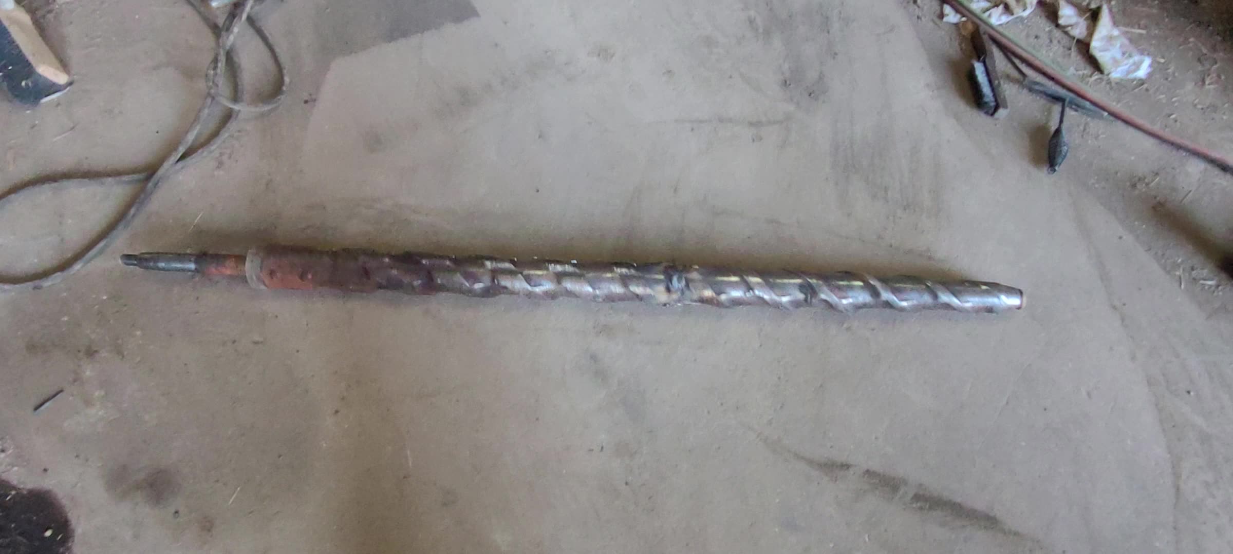

Turned too short with the corn picker and the tractor tire caught the snoot, made a big mess, including breaking the roller.
Pulled the snoot and roller off to assess the situation.

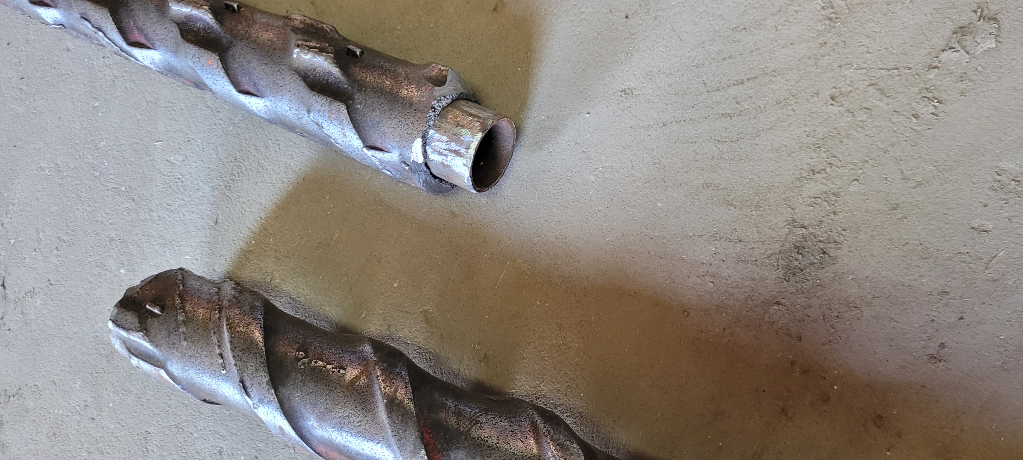

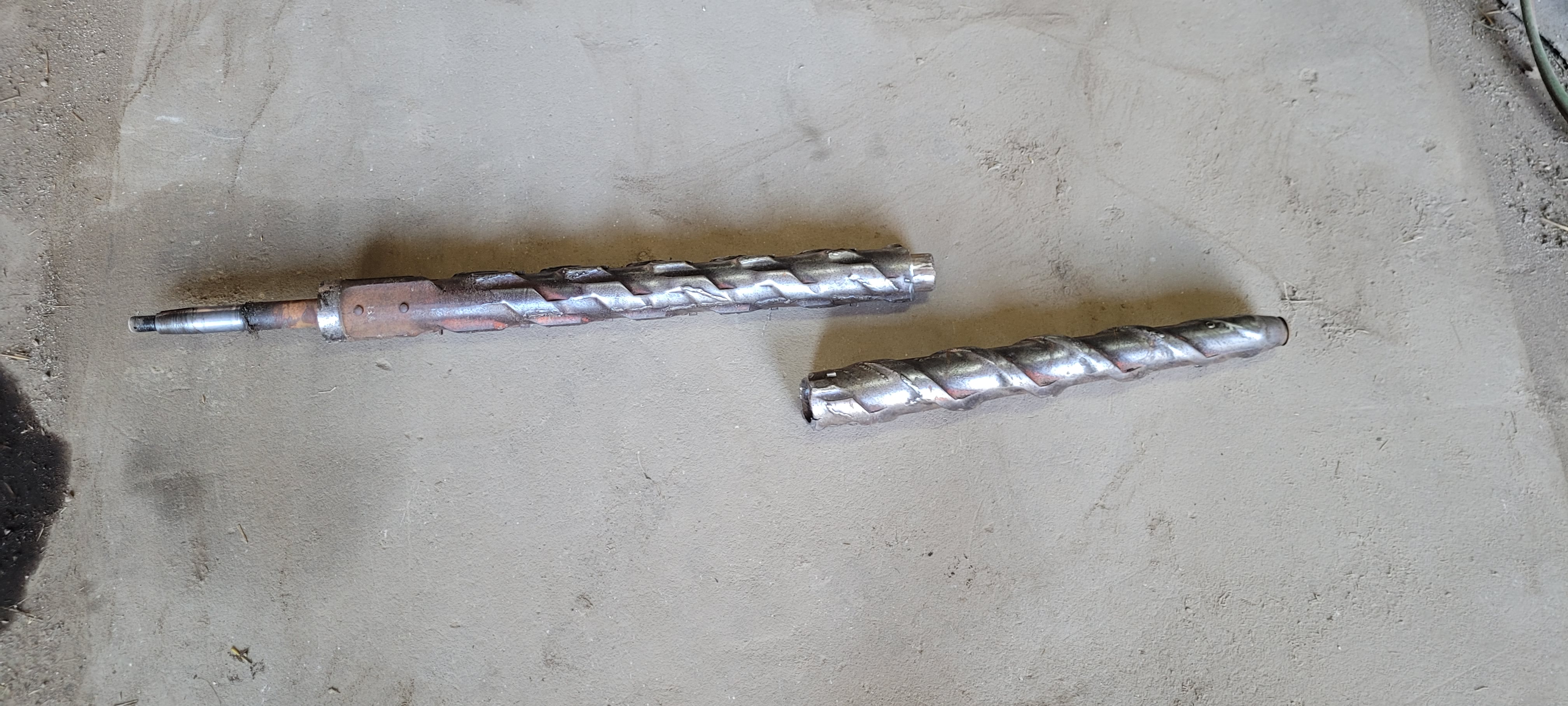

Started with the roller, cast iron of course. First I found a piece of pipe that fit tight inside. I could only get about 4" in on either side before inside structure, but that worked well.
Once it was together I ground a V on opposite sides to weld alternating sides to help prevent pulling.
Once that was welded I ground a v in the rest to get full welds all the way around. I used Nomacast rod for this because it works better with this type of cast. I does leave an uglier weld tho, but when done it was nice and straight. A video of rolling on the floor to check for straight.

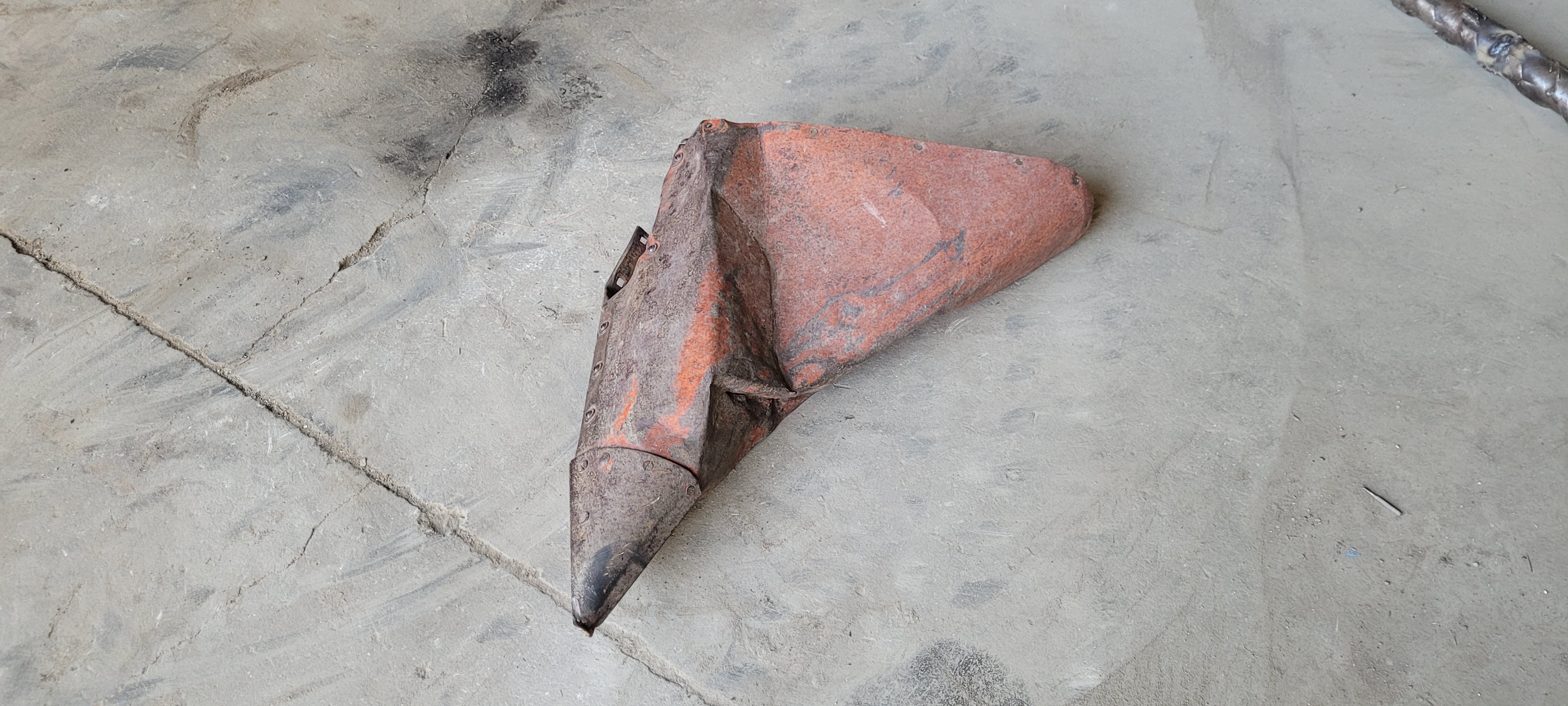

Next was the snoot, started with this.
A little time with a 6x6 block of wood and a couple hammers and it looks pretty decent.

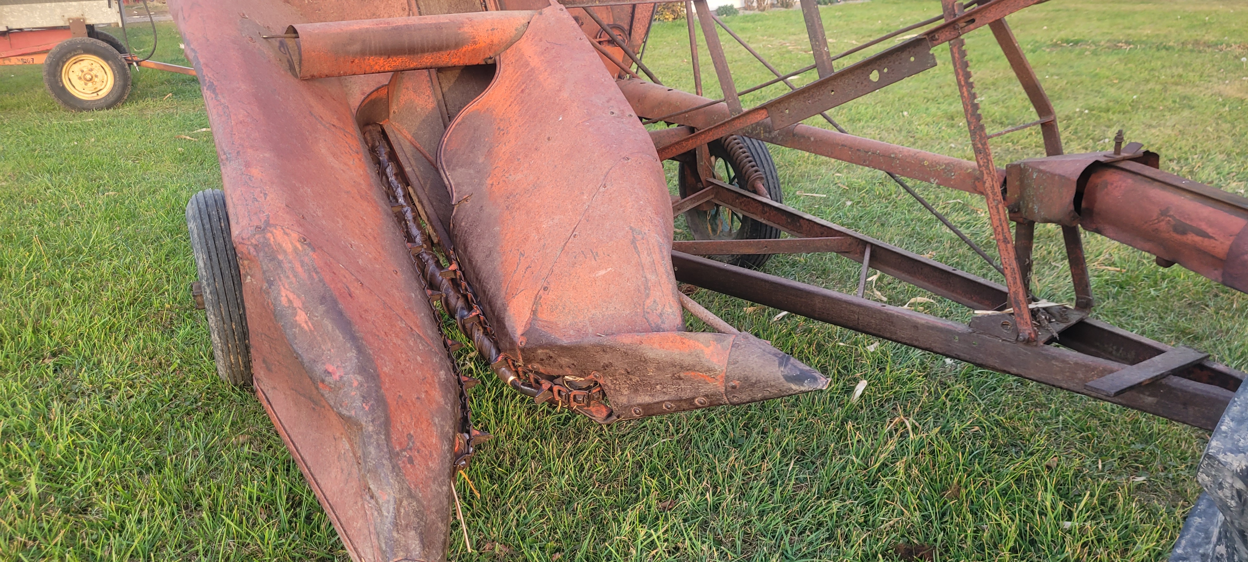

It was at this point that I figured out the main frame of the picker was also bent. That took the longest, lots of time with a high lift jack and com-a-long and I got it all together. I'll have to bring it back in and do some more work on the frame because the rollers are not tight enough yet and won't pull the stalks through like it should. That will have to be Saturday.

Like it never even happened!

Jon, that roller looks almost like it is cast steel. I'm not sure they would even make something like that out of cast iron, especially being partially hollow. I'm getting ready to use some Nomacast on a Continental timing cover, and my experimenting worked OK on a cast bellhousing ear. Hopefully it'll work as good as your repair. Nice job. Did you say some bad words? steve

Learned your lesson the hard way, just like I did. Only I did it twice, two days later. I was lucky enough to not break the roller. Good Luck and BE CAREFUL.

Can't be cast steel because that is flexible. Can't have flex in rollers like this.

Nomacast? Is that a special kind of welding rod?
Not special but for cast. Actually cheaper than nickle and woks well for lower quality cast and for where you don't need to machine.
