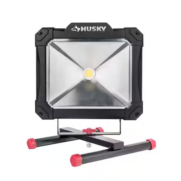

I’ve got a couple of these mounted in my 40x60 machinery shed. They work good for that where I just need to be able to see enough to not trip over something, but don’t know how many of those it would take for good shop lighting.
