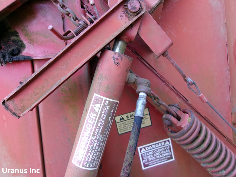

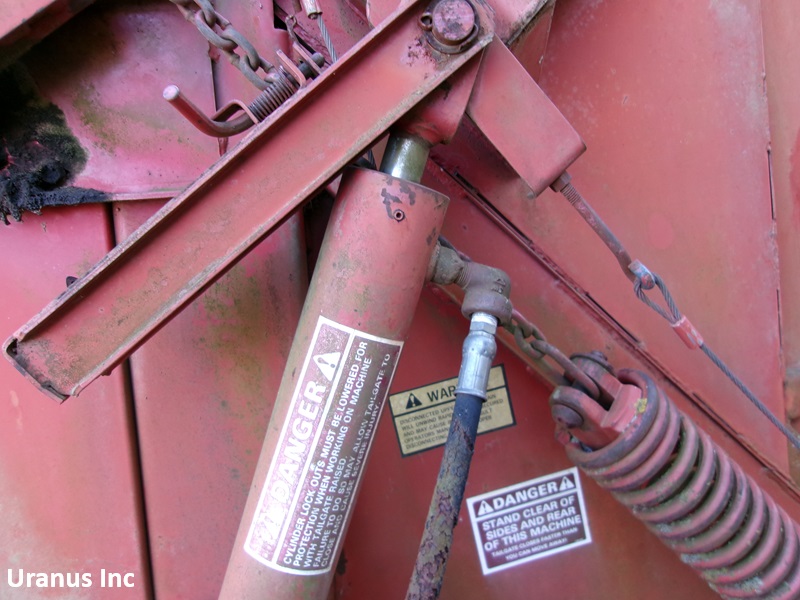

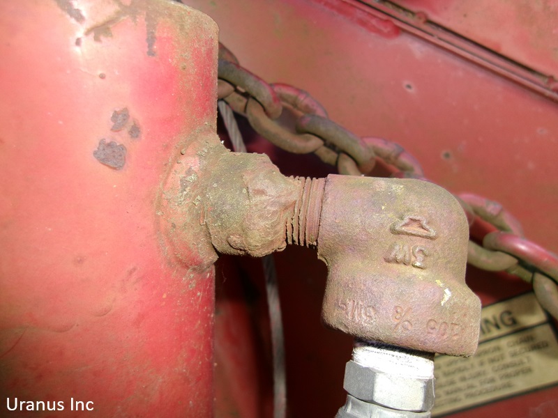

Same with fittings, if you keep the flame out of the hose area. Had to weld an elbow on the old NH846 in the wild. The elbow was attached to the tailgate cylinder with oil in the cylinder, and hose. The only problem to deal with, was porosity caused by the leaking pinhole that I was attempting to weld. Finally sealed it up, and went on about the day.

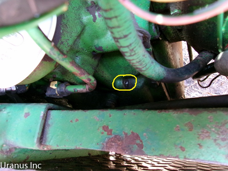

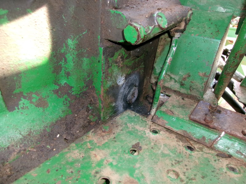

This one I refused to do. The access is miserable, so you don't know where the flame will go before you get to the spot you need to heat. Requires a bit of finagling to get a torch in such a spot. That particular plug had danger written all over it. You just have to stand back, and think it over before you proceed. This plug won't come out until the unit is pulled from the tractor, and I have proper access to heat it.

A miserable weld to make, what with the oil coming out of it. I imagine this was near on 20yrs ago when welded. The puddle tends to explode when it contacts liquid, so you have to keep shoving it in, pulling it off to cool, then repeat. Note the heavy wall elbow. I use these on hydraulic lines. They're rated at IIRC around 4000psi. You should be able to find them at any oilfield supply, if you can't find a fitting at the ag store.
But, this shows that it's possible to apply heat to fittings as long as it's safely directed, and the line is full of fluid.....no air in it.
That machine hasn't been in service for close to around 8yrs or so. I need to put some new floor chains, and an apron chain, in it. Still a good baler I imagine........................"ran well when parked" LOL
