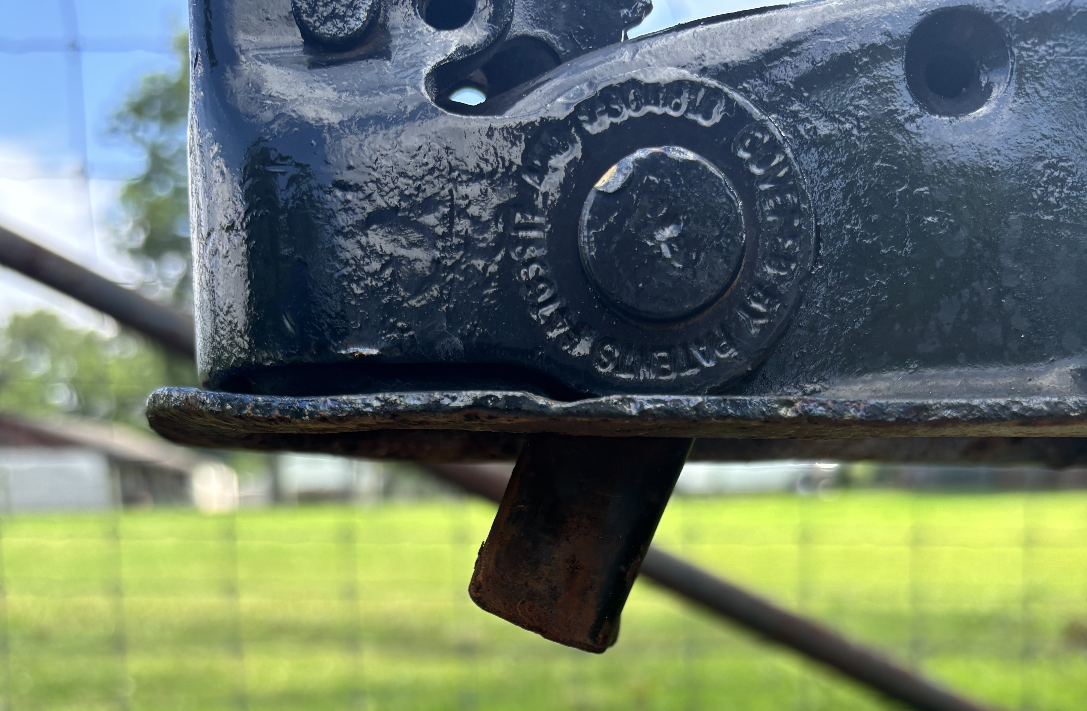

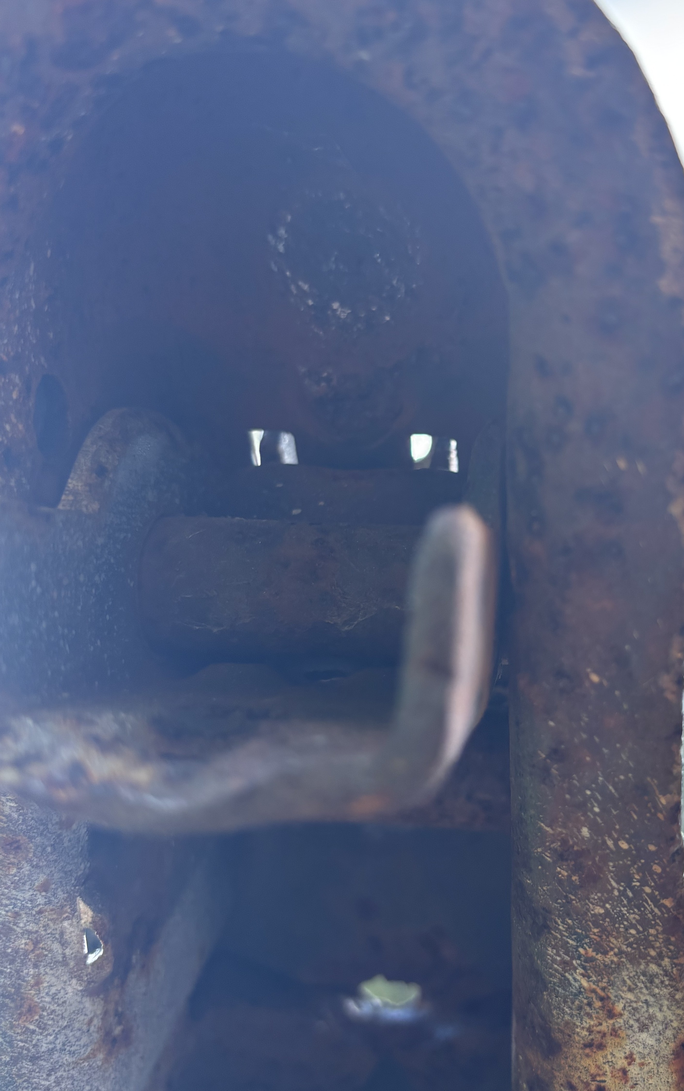

The trailer coupler on my trailer failed. The tongue locking under the ball no longer holds in position. Pic below shows it dropped down. I can push it up and down in both locked and unlocked positions. Nothing obviously broken to me when looking at it, but something's wrong. Not sure what repair options there are, but if someone can point out the issue is likely to be, I may be able to fix it.
I see that I can buy an entire replacement coupler. If that's the route I need to go, any recommendations on which style of coupler mechanism is preferred? I see that there are different options.
This is for a 16' tandem trailer with the triangular A-frame coupler.

I have a trailer that did that, the section can spread allowing the lock to drop. If you raise the latch portion and lookthere shouldbe an indentaion that holds the tongue that locks the ball. Raise the tongue and squeeze it all back where it belongs.

You can buy kits for most couplers.I still have a few different ones from when I did a lot of trailer work.Most of the problems came from hitting the latch with the vehicle hitch while backing up to it,with the latch in the open position.Not much meat in those latch pin holes,and if hit hard the pin will rip the hole wide open.Plenty strong enough to secure the latch,but not the weight of a vehicle trying to bend it backwards.You will never know when you actually do it,one day things will just drop down.
