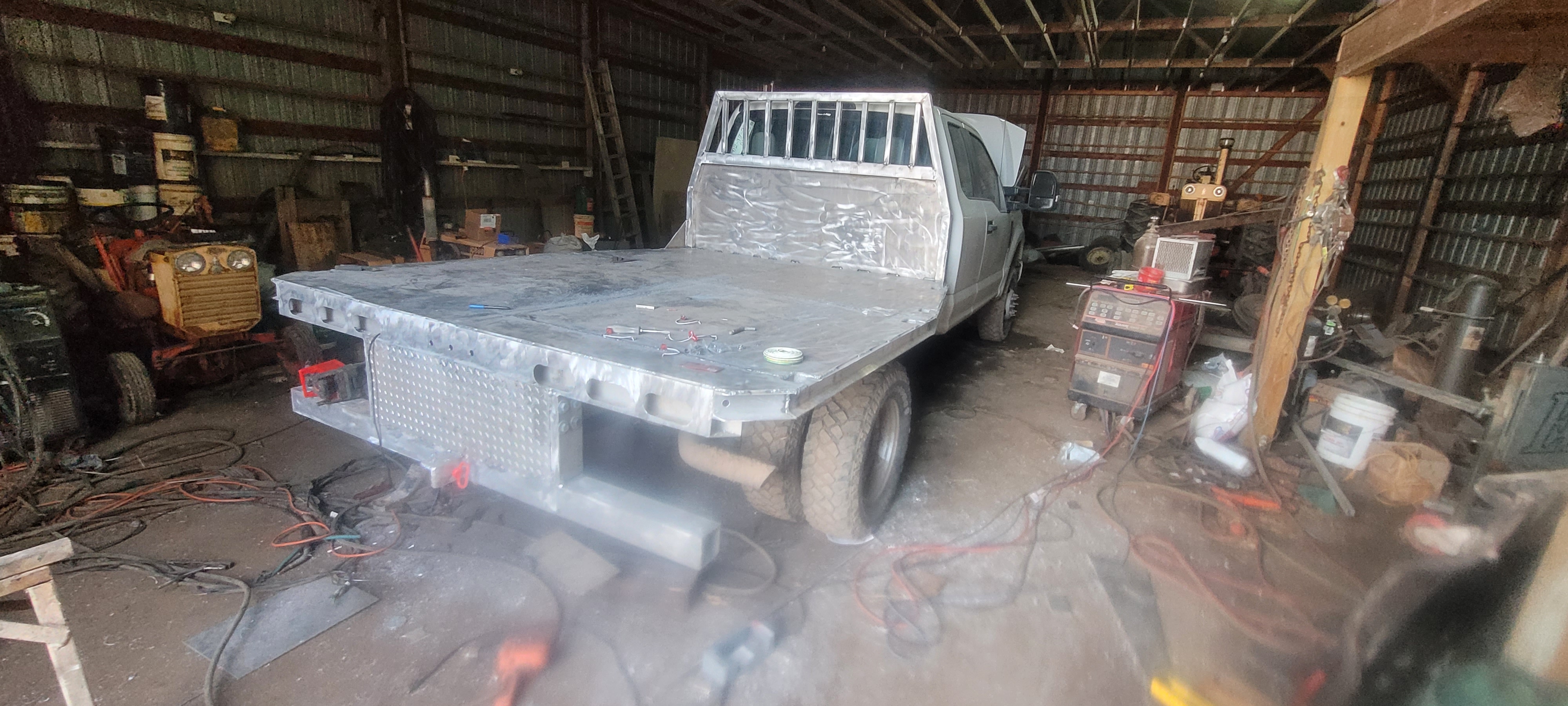

Worked on the truck bed some yesterday. Most of the day was welding, lots of feet of welding in that deck. Also made the headache rack.
Made a mistake on that tho, when I cut the below the window bar I used my measurement on the long end rather than short end so it went in too high. I didn't catch it til it was all installed. I think I'll cut it out today and redo it. I hate when I do something like that. Also started on the wiring, they had really made a mess of that when they installed the other bed. Bare wires everywhere. I may even have to pull the bed to get back further, I will see what I find.

You're just moving too fast! When I asked about what you might be placing between the aluminum and steel, I was thinking maybe a tube of silicone in a caulking gun? I have an EBY grain dump, built in Lancaster county PA. Even where the aluminum is very thick, the "rust", or I guess in this case, the corrosion jacking is amazing.

Interesting that you mentioned EBY. The angled corners on Jon's bed remind me of an EBY flatbed.
wood slat would provide the insulator needed to reduce the galvanic corrosion from steel to aluminum contact or even a plastic strip between . Most semi trailers will place a thin plastic/nylon typr of material between the suspension and frame on aluminum framed trailers to prevent that.
