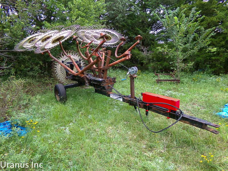

I have an ancient V rake.
Mine can't be narrowed like most modern rakes. If I narrow the front of the V, the windrow gets very wide. Some newer rakes allow you to adjust windrow width somewhat separately from gathering width, so I understand. ON MINE, THE ONLY WAY TO CUT DOWN ON GATHERED MATERIAL, IS TO REMOVE RAKE WHEELS. Something you might have to do........it's not a big deal.
When I brought my antique(sigh) Kelderman back from the dead.....along with many other modifications, I included a provision for storing unneeded rake wheels on the rake itself.
It's a crazy way to live, but I guess we all do the best we can with what we have.
These rakes don't go for much because they're not worth much. https://www.purplewave.com/auction/251001/item/EP0510/Kelderman_Mfg-Hay_Equipment-Hay_Rake-Kansas
The rake in the above auction gallery is FOLDED AS NARROW AS IT WILL GO. This is one of the biggest drawbacks to these rakes. It took the master fabricators at Uranus Incorporated to solve the problem
