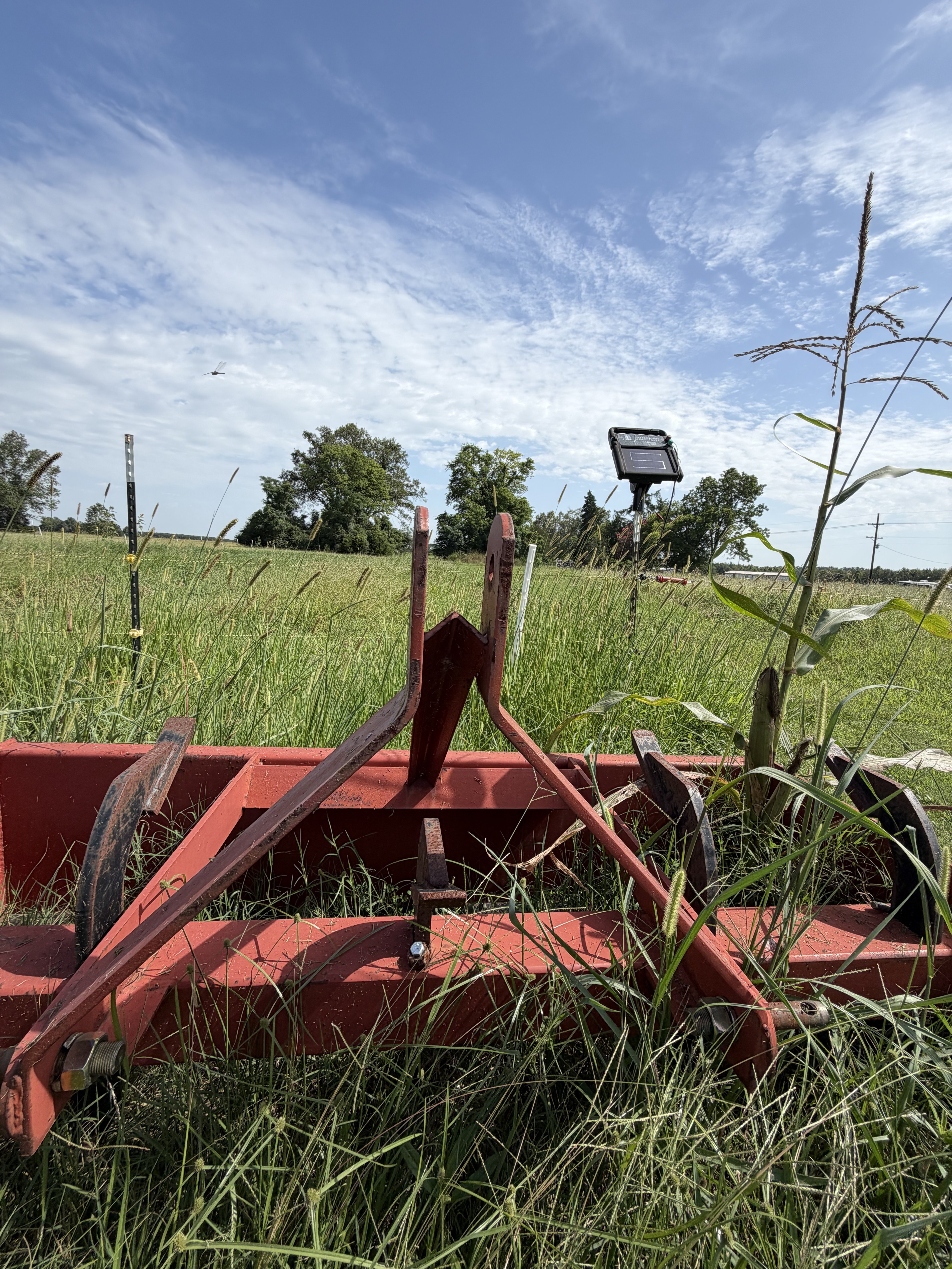

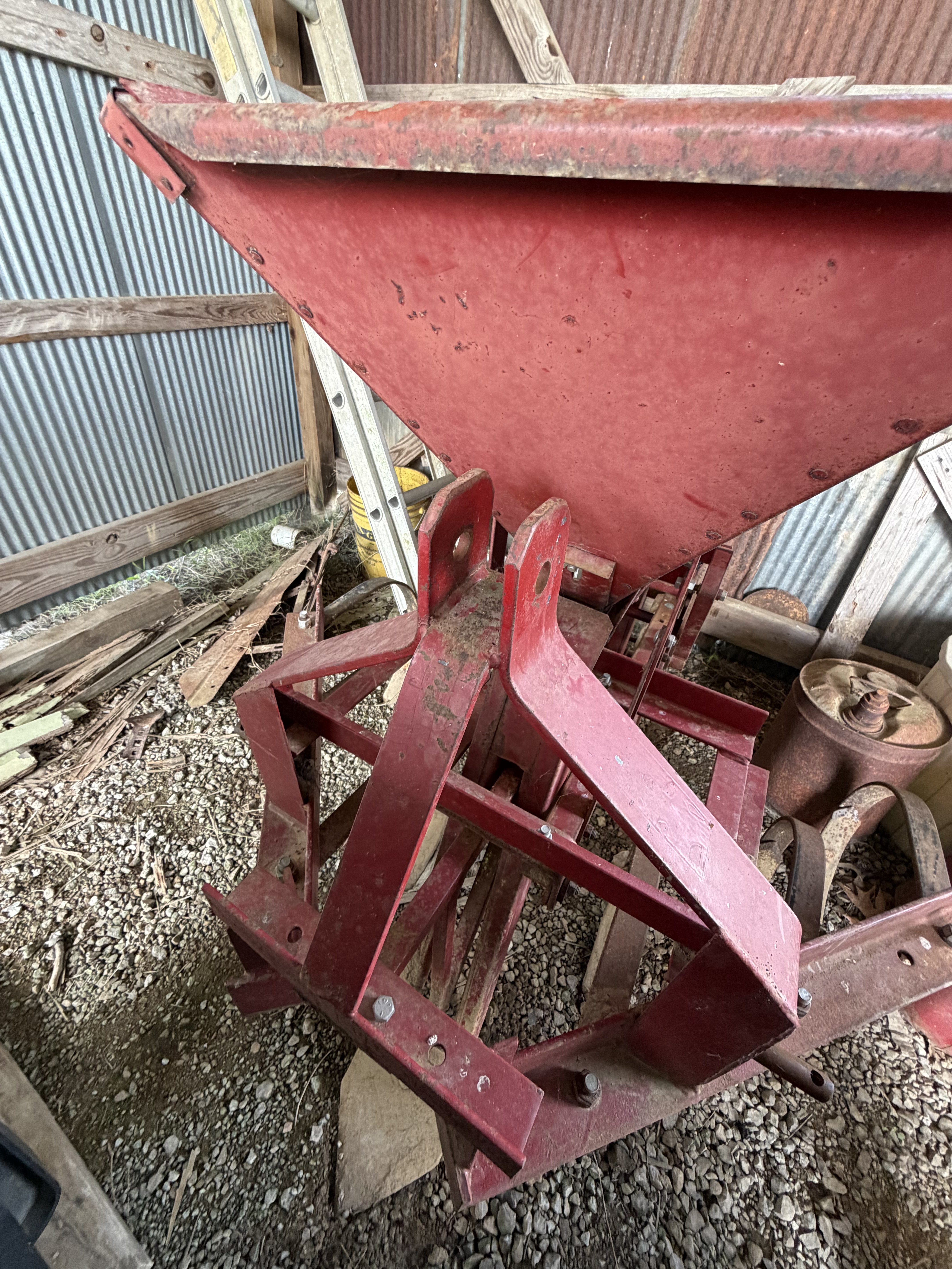

I got a quick hitch for my 530 but it doesn't work on most of my tools. My case blade has 3 pin settings so you can tilt it to the side for things like cutting ditches, since those are circular to keep pin spacing the curve prevents use of the quick hitch. My brush mower has a brace under the arm pins preventing its use. And my hay mower has a brace under the third arm pin so it wont work there either. The only thing I have that it will work on is the brillion seeder I converted to 3pt. Lol. I was very disappointed to say the least.
