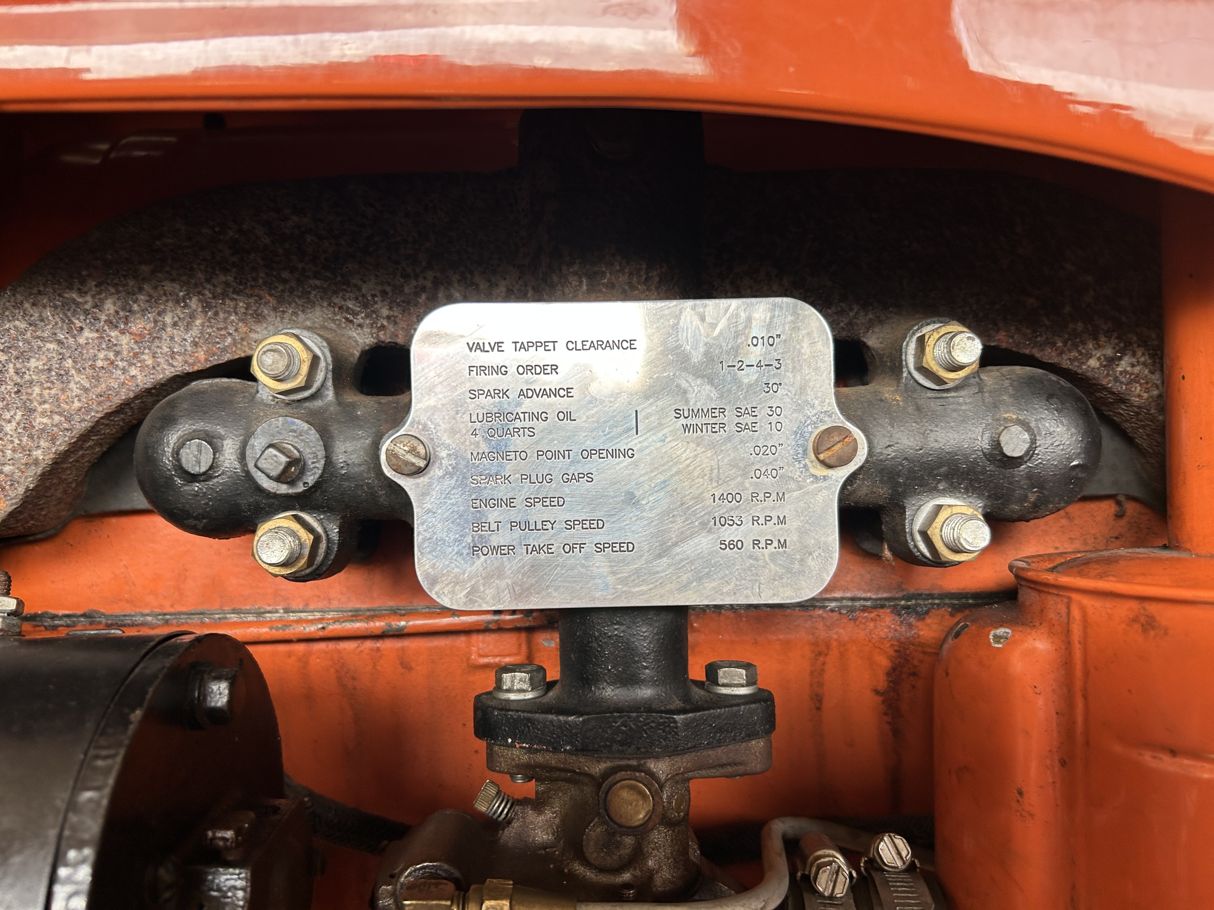

I know parts can be swapped in all sorts of ways, what would be some internal differences? This appears to be a distillate manifold on a 1943 Allis C that had the 2 bolt valve cover. The pistons are 3.250" diameter which wouldn't be right for a C?

Your engine was definitely shipped from the factory on a B. The first C's were shipped with the 3 3/8" pistons. That plate was shipped on those years on both the distillate and regular gas engines. The ability to use the tractor distillate fueled it would have a small tank under the hood to start it on gas and also have a heat box where the information plate is on yours with the plate moved to the outside of the heat box for running on distillate .

So the information plate is a factory item----I thought somebody made it to be flashy.

Factory! I have a couple somewhere.

Re thinking the heat box I think the heat box might be behind the plate. I never used the manifolds that had the plates as they were in bad condition. Look behind your plate.
