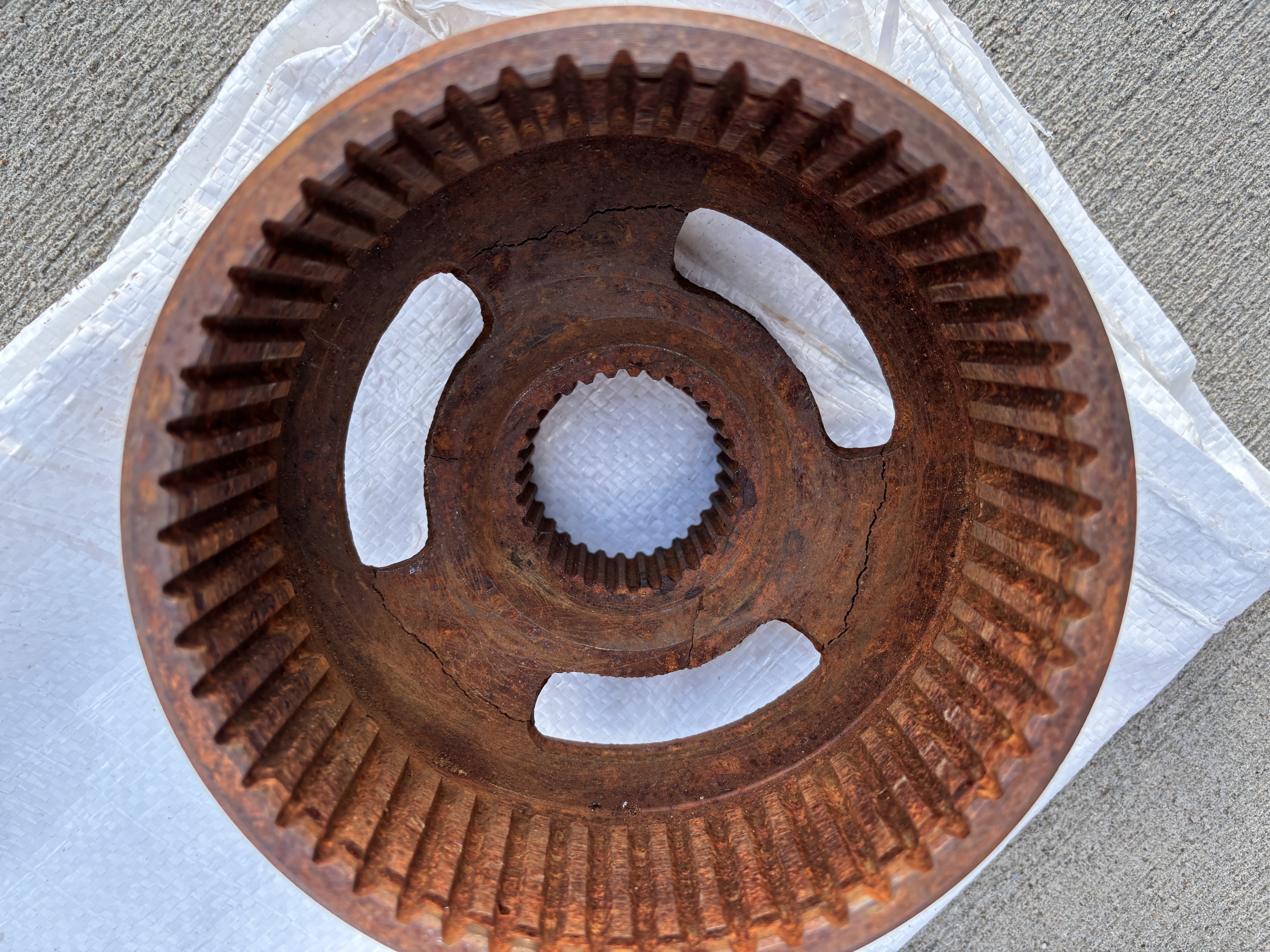

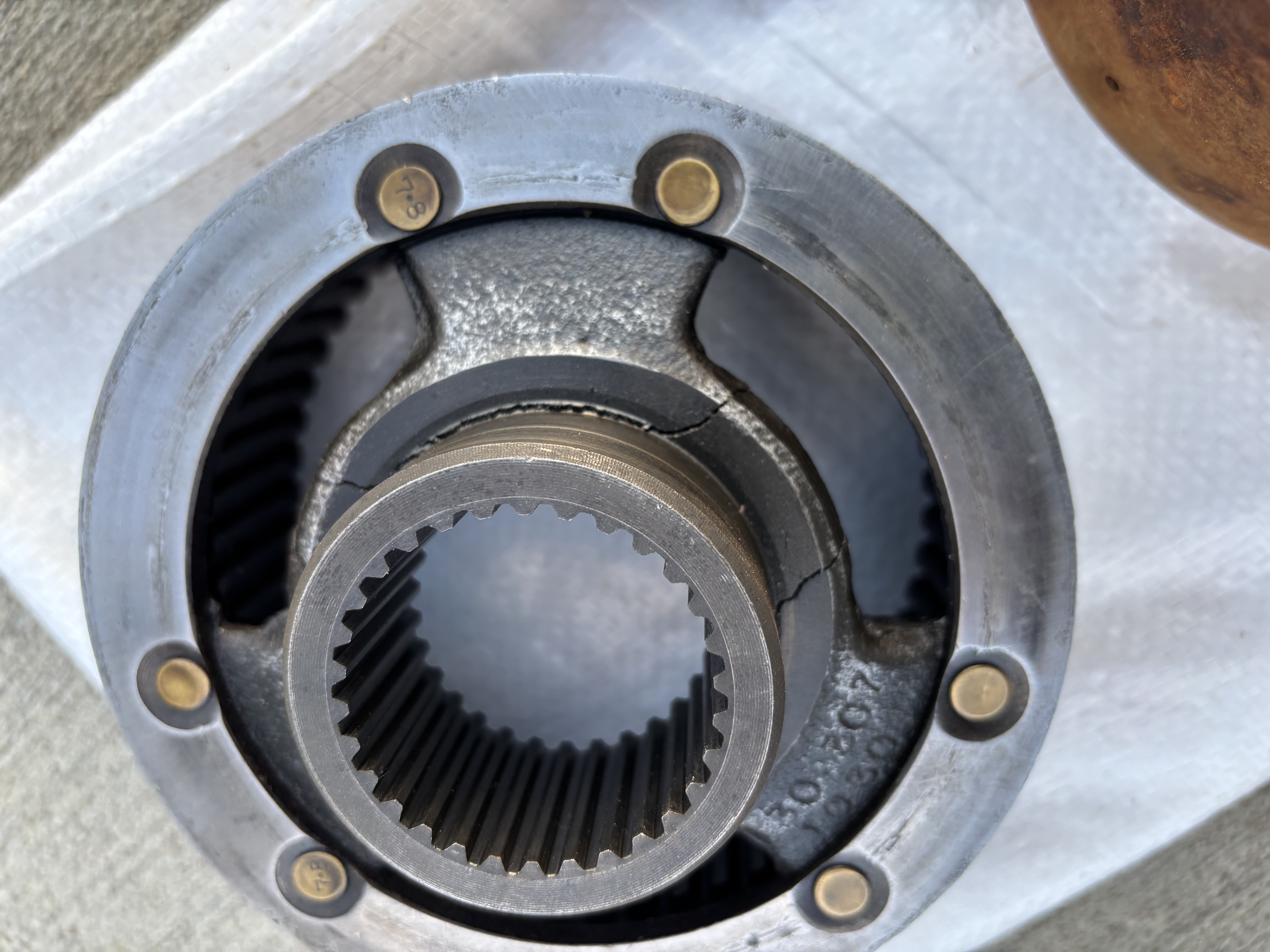

View attachment 110641Under light duty, I have cracked 2 PTO clutch housings. New housings are not available and they are getting harder to find from salvage.
What could be causing this?View attachment 110643

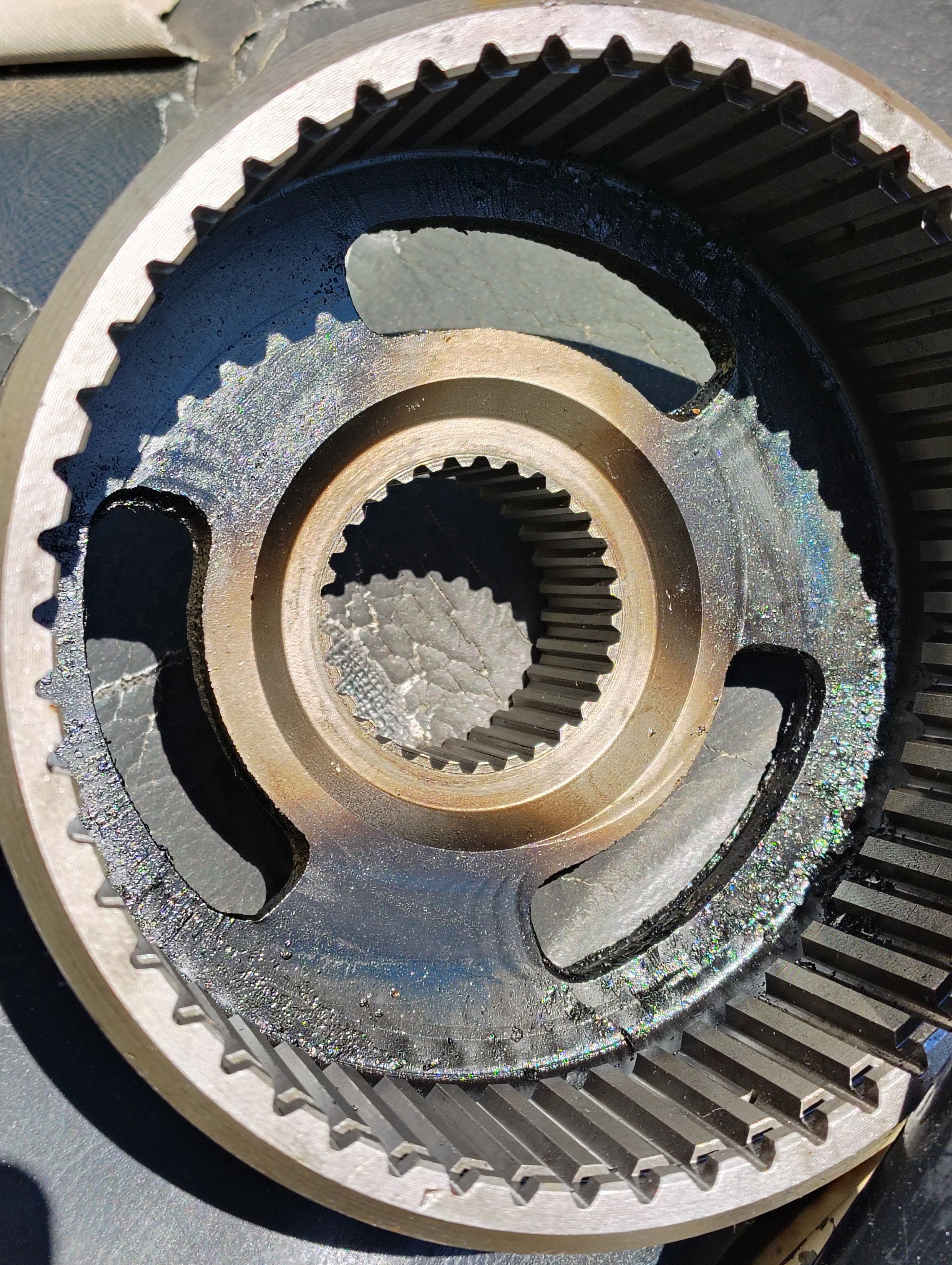

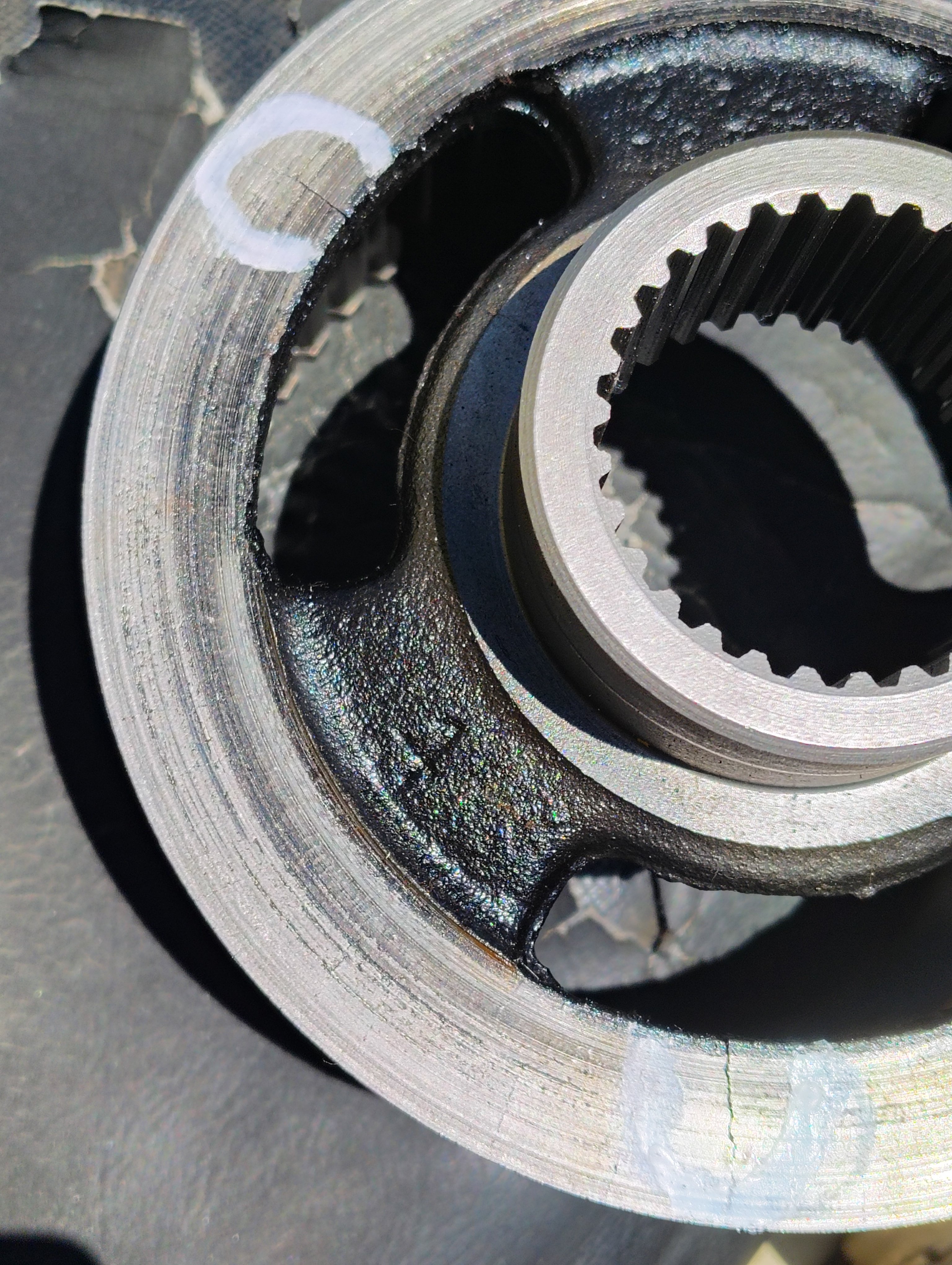

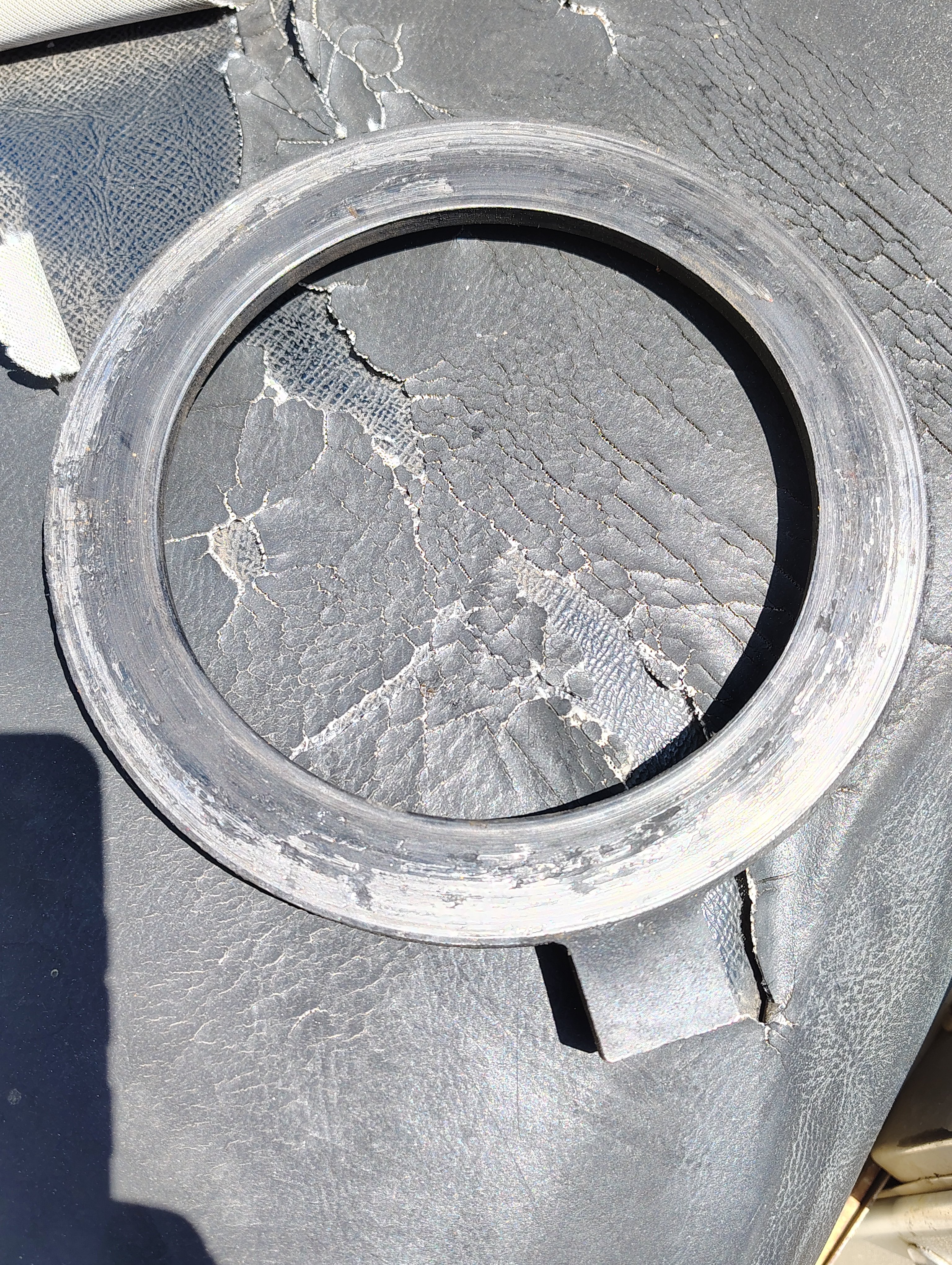

Check out these images on a pto we just rebuilt. The brake just isn't strong enough for most PTO equipment and really shouldn't be used. My old mechanic friend said to just disable the brake. Once the friction material wears, it's then metal to metal against the drum until it overheats and cracks. Yours is cracked in the normal places where they get hot. See the burning on the drum in my photo, cracks (ours were on the back side), and wear of the brake material. Lesson, just shut the tractor off when you need to change equipment.
View attachment 110712View attachment 110714View attachment 110716

What does your brake plate look like? Is there any friction material left or has it been running metal to metal?
The brake plates in both housings that cracked had no friction material at all. Friction material was an older option that we did have on a
White 2-85. It is no longer available. The second housing that we put into the 2-88 had a metal ring riveted and welded to the PTO housing
with no friction material. This housing came from salvage and lasted 1 hour running a small sprayer pump. No sign of overheating like
your picture shows. Thanks for your suggestions as to not using/disabling the brake.
What do you mean friction material was an older option on the housings? I know the earlier drum is no longer available, as the rivited drum was superceded. We too welded (improved) a rivited clutch drum/housing. But the friction material is on the brake plate, as we just ordered and installed it: https://agpartsfirstllc.mybigcommerce.com/power-take-off-brake-plate-30-3312038/
