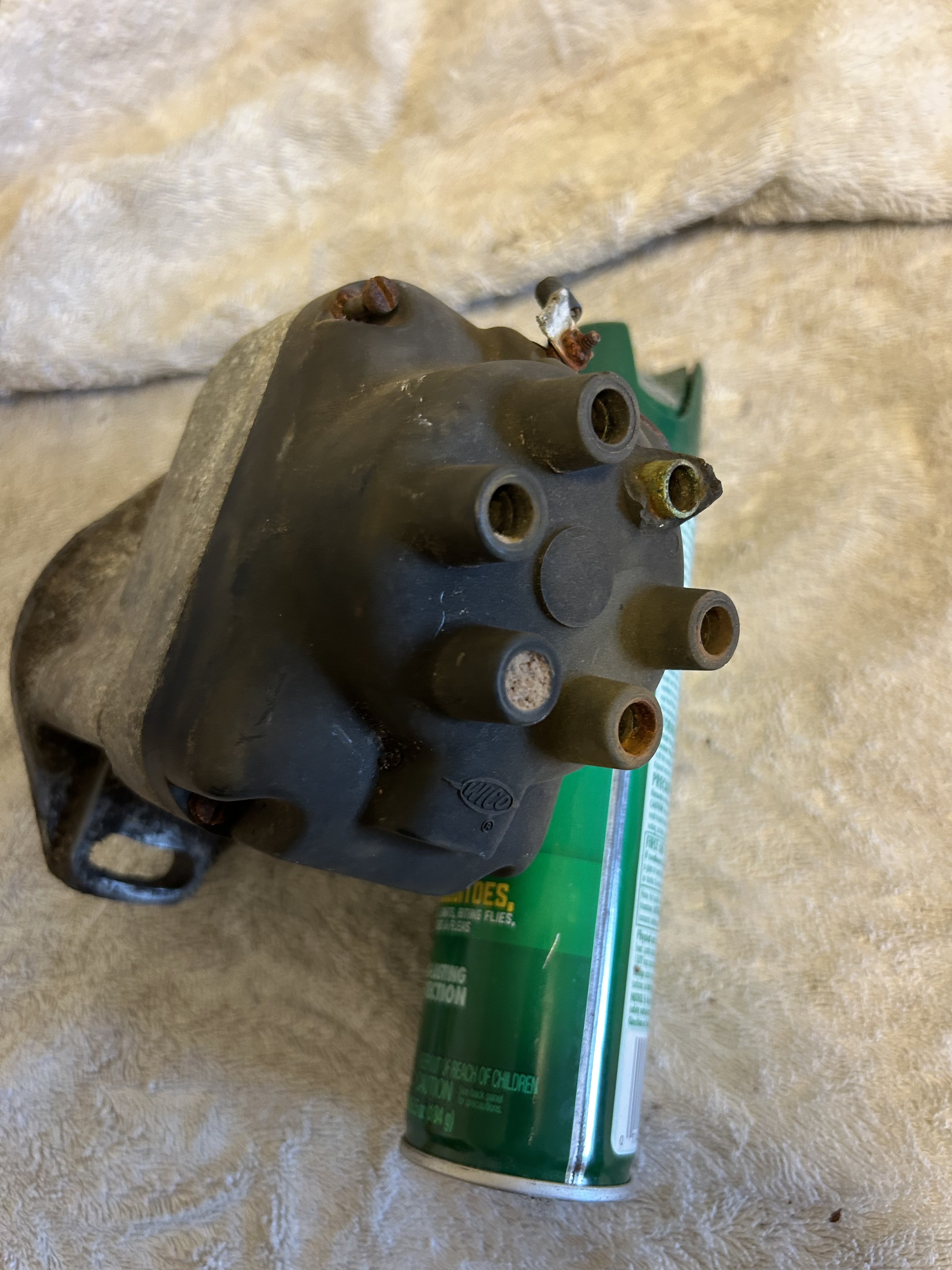

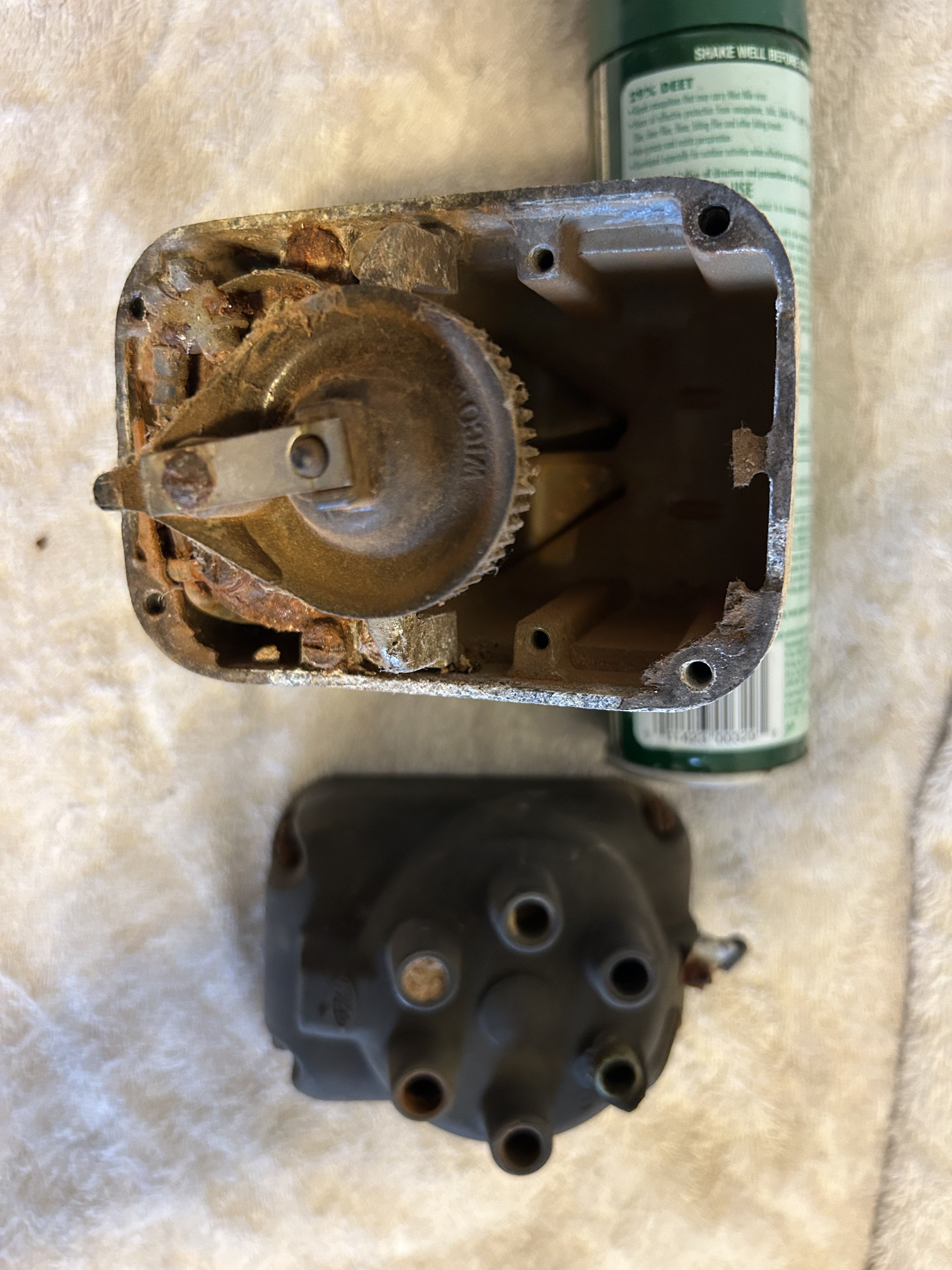

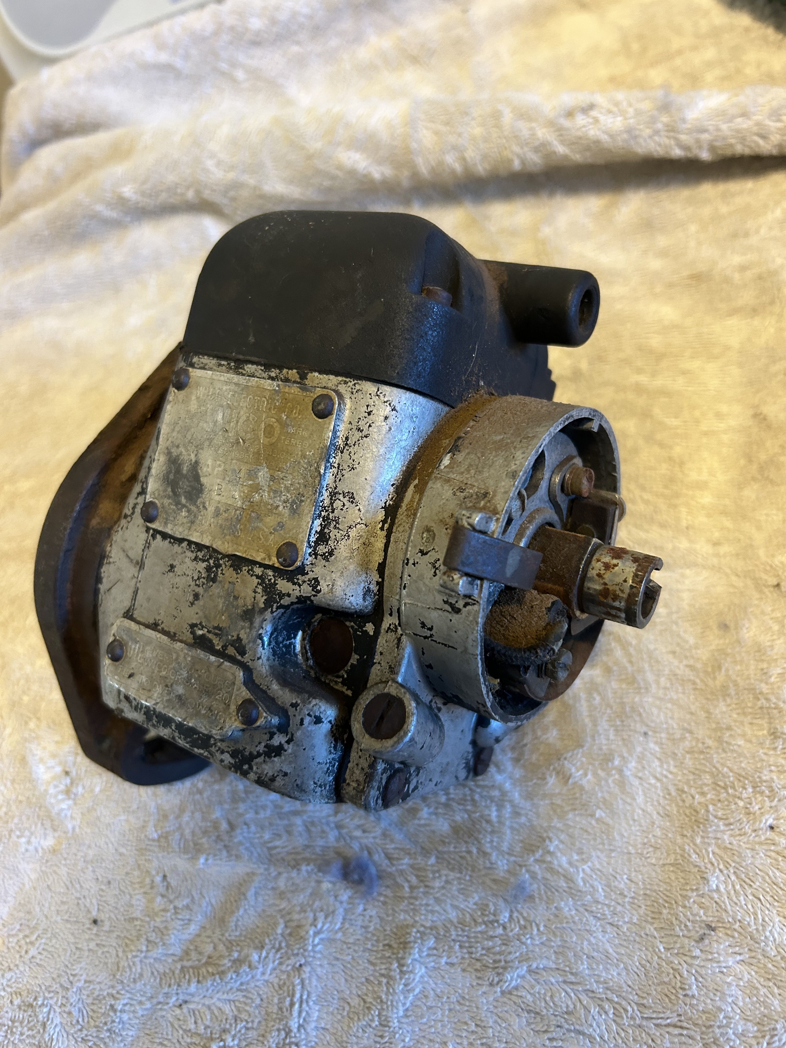

I’ve got an xb distributor for an Oliver 70 that also takes an elusive coil. Awhile back, I tried everywhere to get a coil for it. Everyone had leads to help me get one, but I couldn’t find one anywhere . A member here even told me that he was going to “make a batch”, but I haven’t heard any more from him. As you can see from my photos, there should be room in there to “farmerize” it and install a small motorcycle coil. That will be my effort this winter. Generic motorcycle coils are cheap on eBay. If I manage to get one to work, I’ll post results. Just don’t hold your breath. 😎
