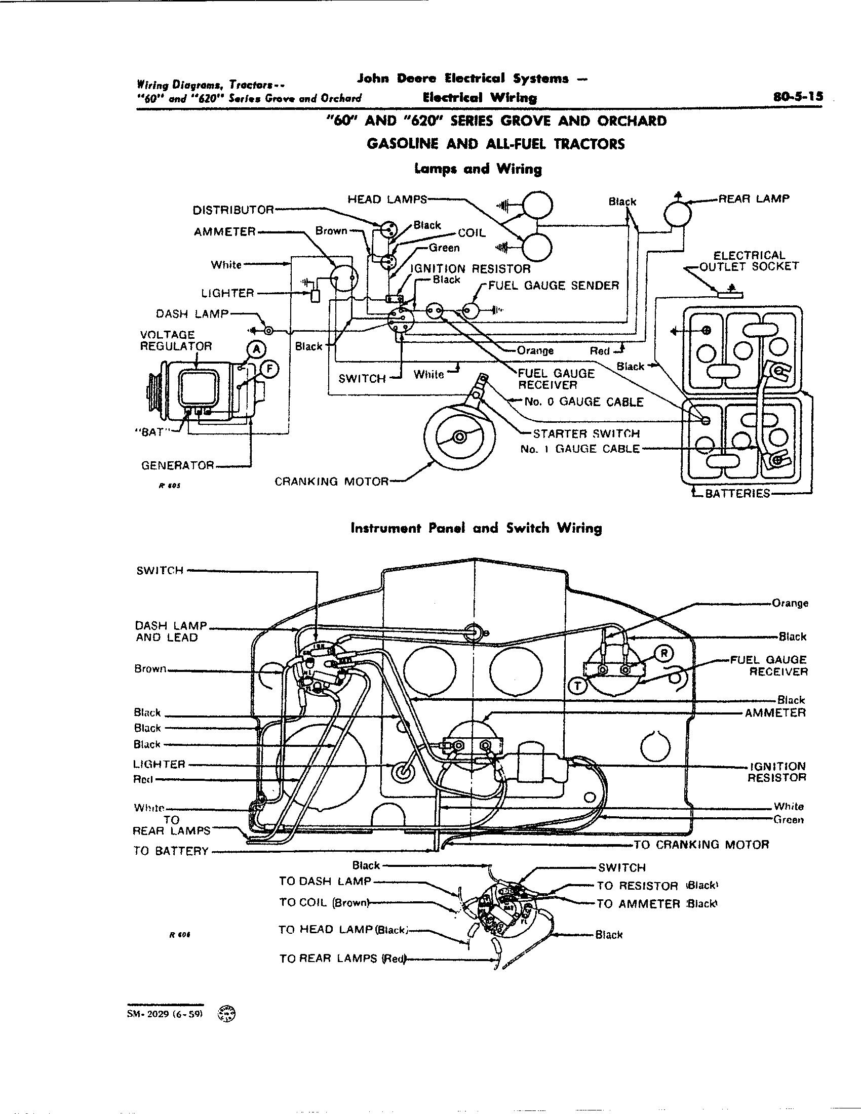

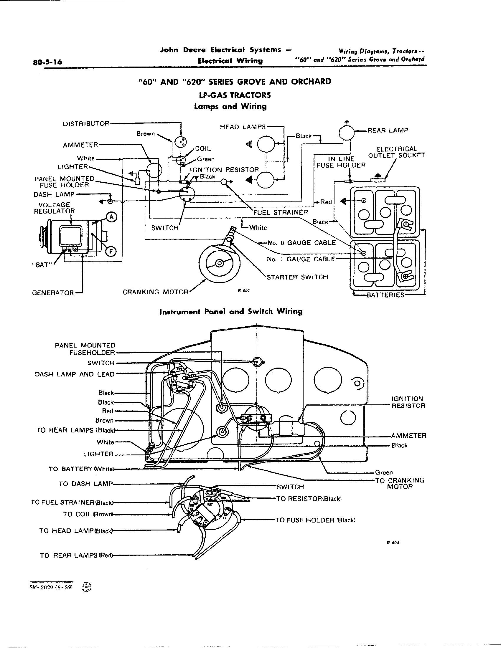

Trying to wire up a John Deere 60. Could someone make a simple diagram - positive ground showing: battery, generator, regulator, ammeter, dash switch with proper wiring runs and terminals. All the ones I find are too small with so much stuff I can't follow the wires to make sure I get them to the right posts. Hand drawn would be perfect.
Try these two that M-Man has posted on this site in his media. They are simple and if you download them you should be able to enlarge and print them.
