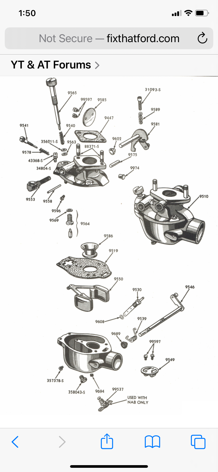

If Autolite plugs consistently would not run an engine, there would be no more Autolite plugs sold. I got a sneaky suspicion it’s your carb. Pull a couple spark plugs and dump a tablespoon of gas in each one. Screw the plugs in finger tight put the wires on and crank it. Bet she’ll run a few seconds. If so take your carb off a poke a wire in every passage, shoot carb cleaner in it and blast it with compressed air, REPEAT, maybe even do it a 3rd time. Make sure you pull out what I call the “fuel nozzle” 9530 in the picture, clean it and the passage it sets in extra carefully. See those holes along it? Air comes down and through those holes and mixes with the fuel. Then emulsified fuel is dumped into the air intake stream as it passes through the venturi #9586.
That process is nearly as important as the fuel itself getting in there. That is not as important for the initial start but highly important for it to run well at any speed above idle.
That process is nearly as important as the fuel itself getting in there. That is not as important for the initial start but highly important for it to run well at any speed above idle. View attachment 67041
Totally dismantled the carb and cleaned everything. No improvement. I know I must be missing something but I'm not smart enough to see it.
