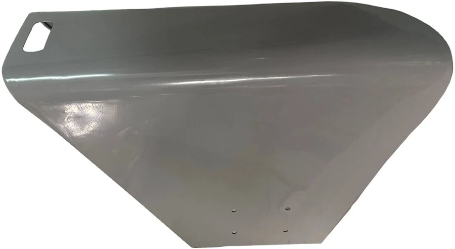

Here is a link to the aftermarket fenders PartsASAP, YT's parent company sells.
AM1843T fender

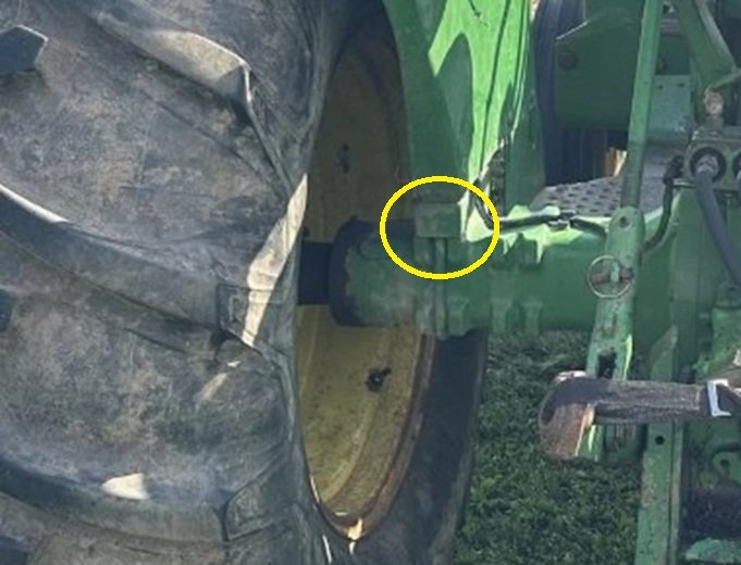

Jim you are right, I knew there was a letter "A" in the prefix somewhere and might have overlooked some parts in the past because of an extra A or the lack thereof. I went back to JD's parts page and they have both listed, just not available. The JD fenders and ASAP fender look identical and when I compare those to the few verified pics online of similar trim and year model tractors they look the same.
I will definitely do a bit more digging and try to find close ups of the mounting area as well as how the sheet metal is terminated on the edges ( I believe they are rolled over). With that information I will definitely try to make a set of my own to fit the larger rear tires that I have and put a little extra flair in the metal. I'm thinking something to the fleur-de-lis.

For some tractors they used one fender for all size tires. For later models there were spacer blocks that set on top of the axle between the axle and fender mount. Longer bolts were used based on how high they wanted to lift the fender. I don't see the blocks used on the 1010 but they could be. Some later models had fender extensions between the lower front part of the fenders and footrests, another concept you could fabricate/use if you want better protection from the tires for the operator.
Are you referring to fender extensions as in the concept used for the orchard trim models that had the wrap around fenders. As for spacer blocks, I would assume that a piece of 2" X ?? square or rectangular tubing with the ?? dimensions representing the height differential needed for clearance would suffice or would it be something different?

The fender extensions used on some models after the 1010/2010 are more just a flat bent plate about 1/8" thick. It fills between the bottom of the fender and the footrest so a foot or leg wouldn't slip off the footrest and go down between the footrest and tire.
The JD blocks are cast and about 2" in height. Square or rectangular tubing could be used to make similar. All thread rod, the same diameter as the axle mounting bolts can be used to make bolts the length needed if such riser blocks are added. The block under the fender here is on a 2030, same type arrangement as your fenders, shows how the block(s) can be used to lift the fenders for tires with larger diameters.

Lo and behold I found the fenders behind the shed in my parts pile. Here's pictures and an attempt at measurements. Hope this helps.
Measurements, in order of pictures, are:
W - 33 1/4"
H - 26 1/2"
Curve depth - 5 1/4"
Bottom Plate - 2"
