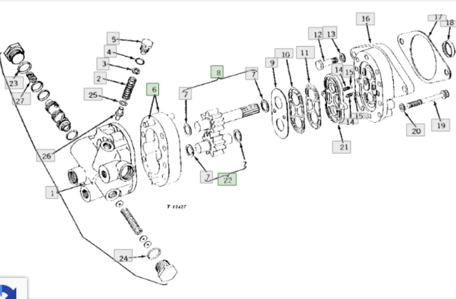

Hi all, I have a '63 1010 RU with single Hydraulics and power steering. My hydraulics including power steering are currently unresponsive. I came across a paragraph in the service manual that states that if you have low pressure it could be an improperly set relief valve. I know where the valve is. Would the "adjustment" just be either adding or subtracting shims?
I have started the tractor to see if the PTO still spins. I figured if the original pump is toast I might be able to use a PTO pump for the loader that is on the tractor. The PTO does spin. The pump feels like its spinning too. I put my hand on the side of the pump housing while the tractor was running and you can feel that the pump is spinning. I can hear a faint whirring noise. The hydraulic fluid is full. I know I shouldnt run the tractor until I know whats up with that pump. I just needed to know what else was working to see if it was going to be worth dealing with the hydraulics. The tractor runs great and has forward and reverse. No strange noises while moving forward or back.
Anyone else have any experience dealing with these pumps? Are there any specific tools I will need? Are there any pitfalls I should avoid? The tractor runs great and is in decent shape. It was also free to me so I'd really love to get some use out of it.

I've spent more time than I would like to admit in the transmission and hydraulic system on 1010s and a couple things I'd encourage you to consider:
1. The hydraulic pump is live and only runs the power steering and the hydraulics on the back. It doesn't have anything to do with your forward/reverse or PTO so unfortunately that isn't any indication of the issue (except ruling out a complete disconnection between engine and transmission).
2. While you should check the screen, don't expect it to be there. Both of the machines I've worked on the screen had long since disintegrated. Deere (or anyone else) doesn't make it anymore, and I've had no luck finding any on parts machines. I have since modified my tractor with a third party screen setup.
3. I use a really large wrench (1-3/8" I think?) to get the nut off on my return line, but I have an RS with the dual hydraulic system and there is room for me to get the wrench onto the nut from under the tractor; it doesn't look like you have that option so I don't have any good suggestions for you.
4. I would recommend you pull the pump after checking the screen. It's only the lines and then 2 bolts and it should lift right out. You can split the pump open to check the gears inside, or even easier just put some fluid in the return line fitting and turn it by hand to see if it does anything. The pump is driven by what I'll call an 'adapter block' that converts gear power 90 degrees up from an input shaft in the engine. (I'm sure there's a technical name/description for this but I'm not a technical person). That block uses 4 hex head bolts to hold it to the clutch housing. If your pump is pumping you can remove that block and inspect it to see if the gear on the end is chipped or damaged in some way, and can also see down into the clutch housing to look for any damage there.
5. If you decide to go with the PTO driven pump, I would recommend you leave the original pump off the tractor and fabricate a cover plate to bolt over that adapter block.

If your S/N is 39237 then that's an early model and it may have a different style pump based on the part diagrams. I'm afraid I don't know anything about the hydraulic flow question, but I might can provide steps for repairing or replacing the pump depending on what you find. If it was my machine I would try and get the pump fixed or get another one before going with a PTO drive pump, but to each their own. Again I'd make sure that something is broken on your existing pump before going through the trouble of setting up the PTO style pump
So I have the service manual for all of the 1000 series tractors so it's every serial number for the 1010s it does have a section specifically for the type of pump that I have. I've been trying to find a replacement pump for years I have not been able to find a machine with these specifications so if this pump is toast I have no other option than a crank or a PTO driven pump.
I just double checked, and it turns out you do have a later style pump. The changeover was at SN 24695. I have the same service manual; it covers all 1010 Serial Numbers.
Here's a picture of that 'block' I was referring to earlier. Your machine will have the style I circled in orange. It gears off of shaft 11A in the image and is worth checking. I'm also attaching a breakdown of the hydraulic pump. If you determine the pump is bad, you could try ordering P/N AT12116 (no. 6 in the diagram), P/N AT15512 (no. 8 in the diagram), and P/N AT31214 (no. 22 in the diagram) if Deere still has any left.
