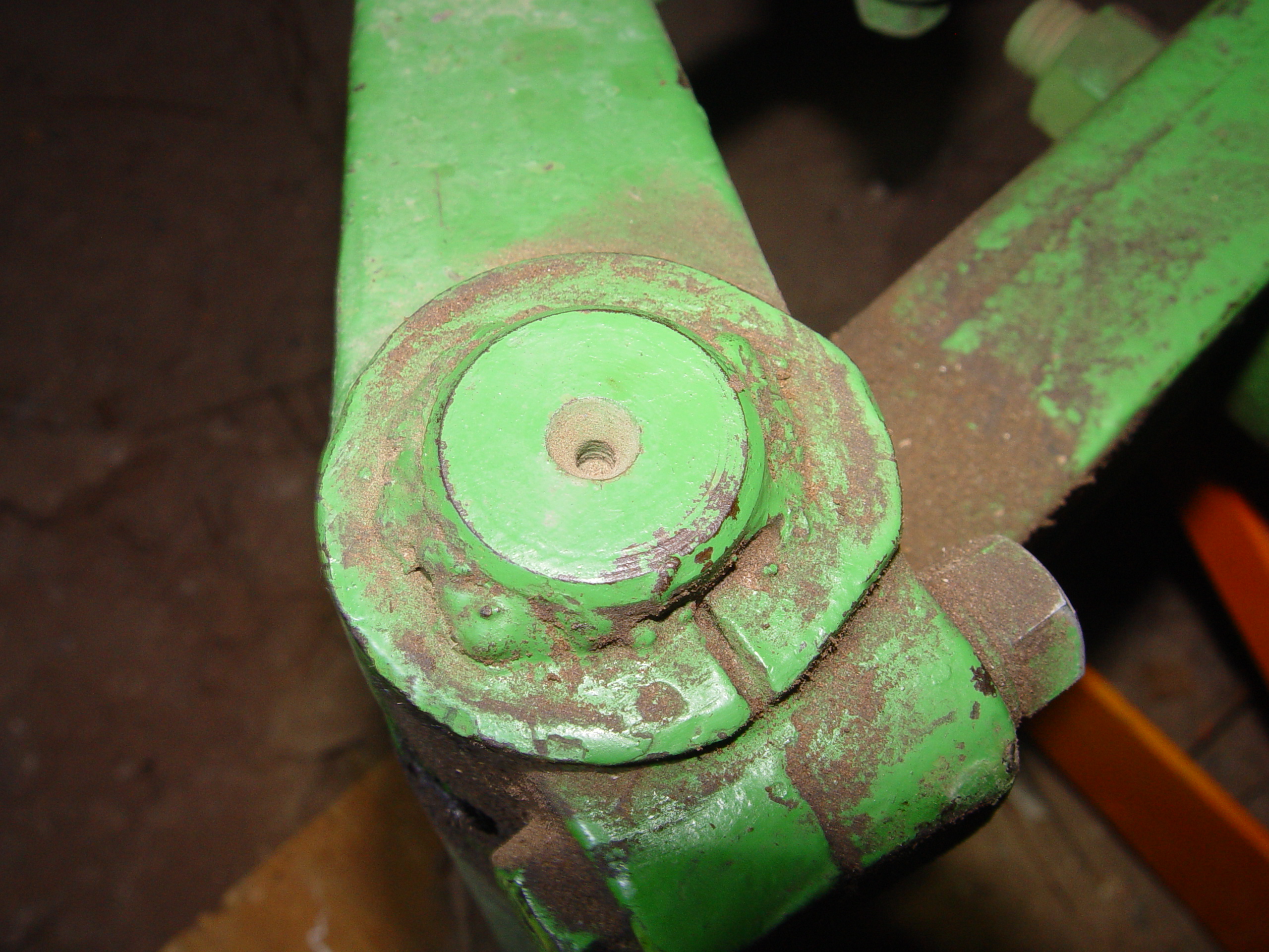

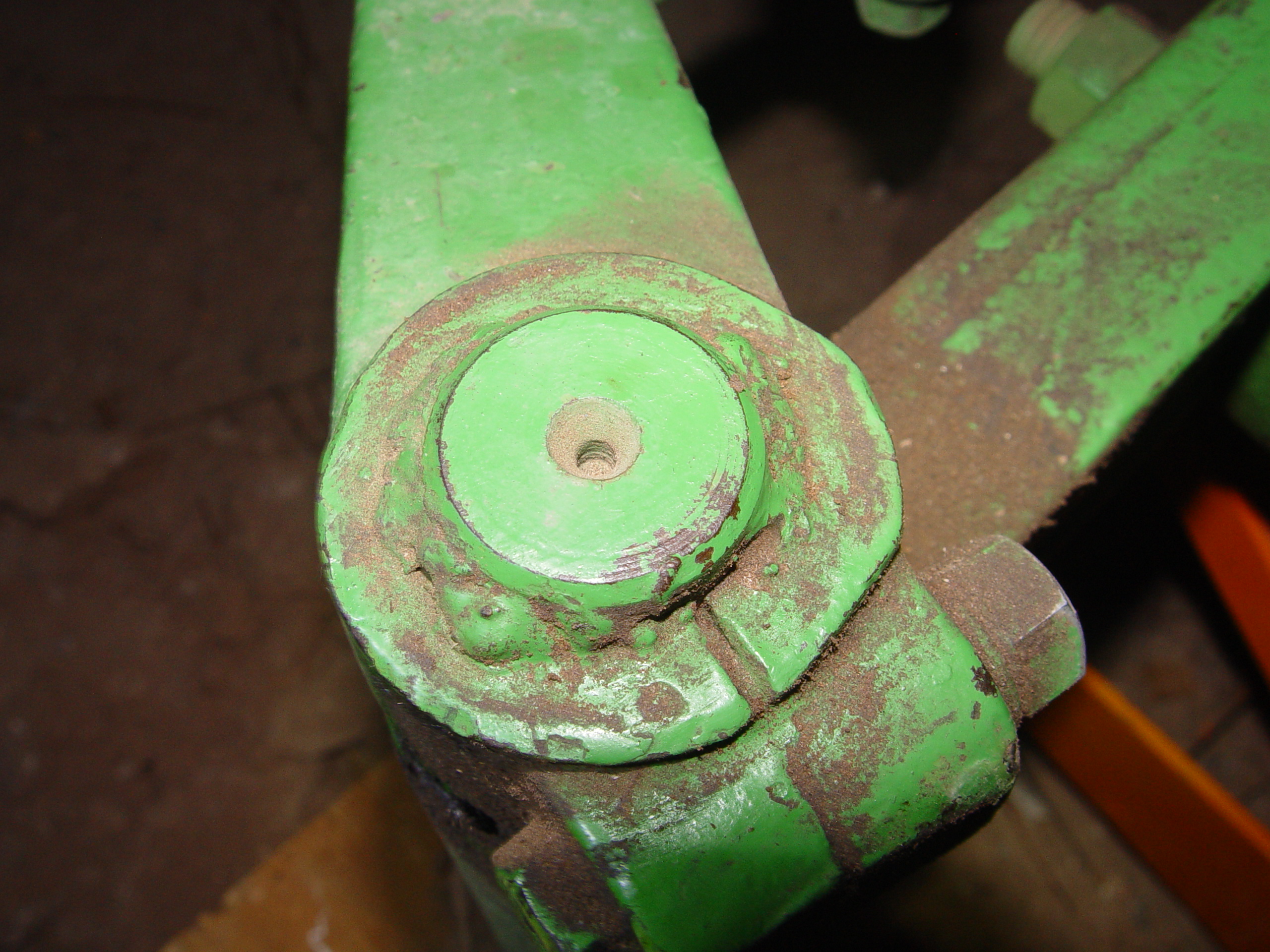

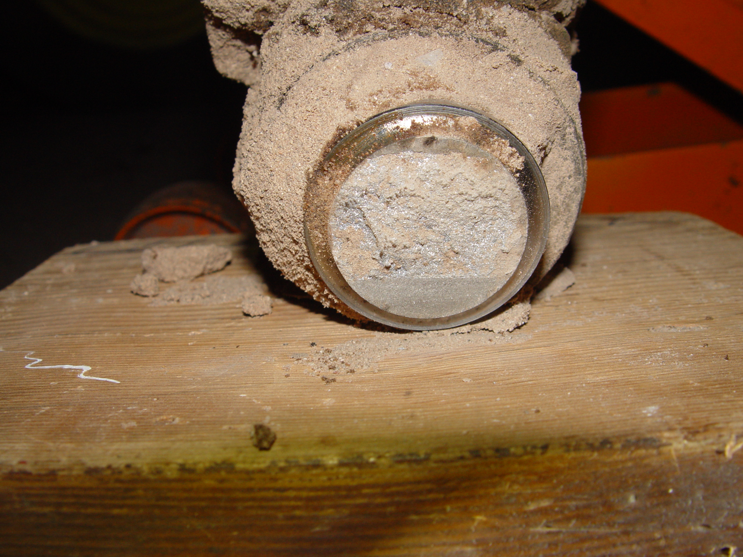

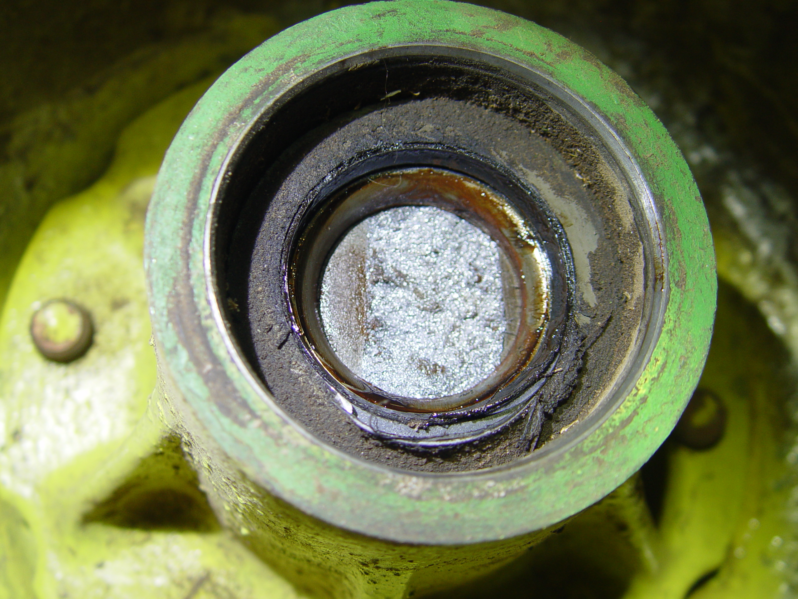

In the middle of pecan harvest the right front spindle snapped off!
I have the 48 front end loader and have added a larger pecan box to the existing bucket to enable transport of pecans from tarp to trailer.
To me there is fairly clear evidence of some existing damage to the spindle prior to this catastrophic failure.
See pics of the end view of what was left on the tractor after the spindle sheared off and the tire rolled away, and the other side of the fractured spindle that remained in the wheel bearing.
Also the steering arm has been welded to the top of the king pin (pic attached)
I have the JD OEM Service Manual but I'll be darned if i can find where removal of the king pin is detailed.
My questions:
1. It seems reasonable evident that the weld of the steering arm to the top of the king pin will be need to be ground off to remove the front spindle.
Among the required parts i think will be needed:
Front spindle
Steering Arm
Bearing seal
ASAP shows 7 spindles for a 1020 w/ a huge price range from $140 to $250
Quality often requires paying for same.
I want to be sure i get a GOOD quality spindle so this won't happen again, at the same time not pay more than i need to.
Any recommendations on manufacturers/vendors that provide quality parts?
2. Any cautions, tips or recommendations on accomplishing this repair?
3. From the pics it can be seen what to me appears to be 2 areas of the spindle that look like the spindle had been partially cut through at two locations that are diametrically opposed. Leaving something around a 20 to 30 % reduction in shear area PLUS the stress concentrations that would produce. Which would easily explain why the spindle failed. Hard to imagine that such a defective part would be used ?! Any thoughts on what the pics of the spindle failure area might reveal?

Breaking a spindle (knuckle) on a farm tractor with a loader is not uncommon, the loader adds stress to the front-end components, and you say you have added an oversize box (bucket). I would not say it was cut; it looks like fatigue over time to me. The lever (which is keyed and clamped to the knuckle) being welded to the knuckle, says it has had some hard use. You are lucky, it looks like the hub is salvageable, many break chunks out of the hub when the axle drops so you get to replace it as well.
Here is a link to the 1020 parts catalog (guessing you have the 1965 - 1973 vintage 1020).
PC 970
Using section 80 Wheels, Front Axles, Sheet Metal, you need to identify which axle you have. From your pictures I would start by looking at the page titled: "FRONT AXLE KNEE, SPINDLE AND KNUCKLE ASSEMBLY (SWEPT BACK ADJUSTABLE FRONT AXLE) 1118-1676MM (44"-66") (LU, RU) 1219-1981MM (48"-78") (RU) (STRAIGHT ADJUSTABLE FRONT AXLE) 1219-2032MM (48"-80") (RU, HU) 1473-2350MM (58"-92-1/2") (RU) 1524-2235MM (60"-88") [03F18] - 80-10e". It doesn't appear you have the heavy duty axle.
The part that broke is called a knuckle by JD. I think you can save the lever the tie rod hooks to with a bit of work using a grinder. Grind the weld off, remove the clamp bolt, spread the ears a bit with a wedge and remove it. Remove the 1/4" key from the knuckle shaft that indexed the lever then the knuckle will slide down out of the knee. There are bushings in the knee, however you will likely want to just slide the new knuckle in to get going. You should replace the seals, washers, and thrust bearing used with the knuckle in the axle knee. You will want to look the wheel bearings over, the inner one in praticular, for damage and replace the wheel seal. You can Identify which knuckle you have by using the vertical measurements they give.
As far as which one of the aftermarket ones is best, your guess is as good as any. Many are likely made in the same place anyway. JD owns A&I so some might say that is the best aftermarket one. I have used a number of different ones based on what is available, as you generally have to get something quick to get back in operation. I did a similar one last week. JD wants about $700 for an OEM Knuckle, $175 for the A&I one from them. You might check your dealer, they might have an A&I one in stock, one of the local dealers here had one. A bit more than you can find one on line but may be worth it if you need the tractor going.
It would appear you can measure the length on ASAP and get the right one. Regardless where you go I wouldn’t take a chance on a used spindle buy new from here or elsewhere if there’s a loader on it a lot bigger tractors have broken knees from that size loader. The wish for it not to happen again is a good wish but this is a failure point and always has been. They make the loader more than capable enough to handle its rated capacity but the tractor isn’t. Go drive to the coop scale with a bucket fullest you ever do and see what it says then look at the original weight of your tractor. The weight of your loaded bucket is over 1/3 of the tractor it means your stressing those spindles. In your case your tractor weighs 4210 bare. So 1400 lbs is where you need to quit and if you are bouncing across the field with it much sooner. That loader can probably pick up over a ton with some effort and ballast my 146 does

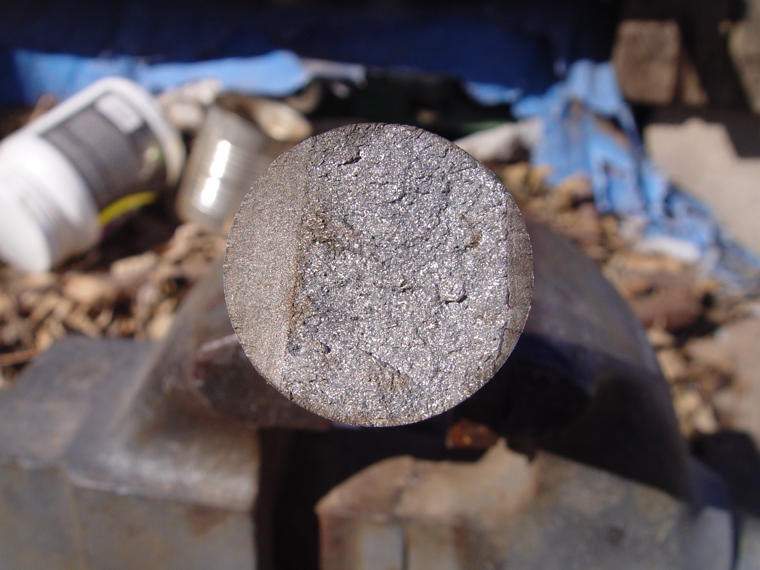

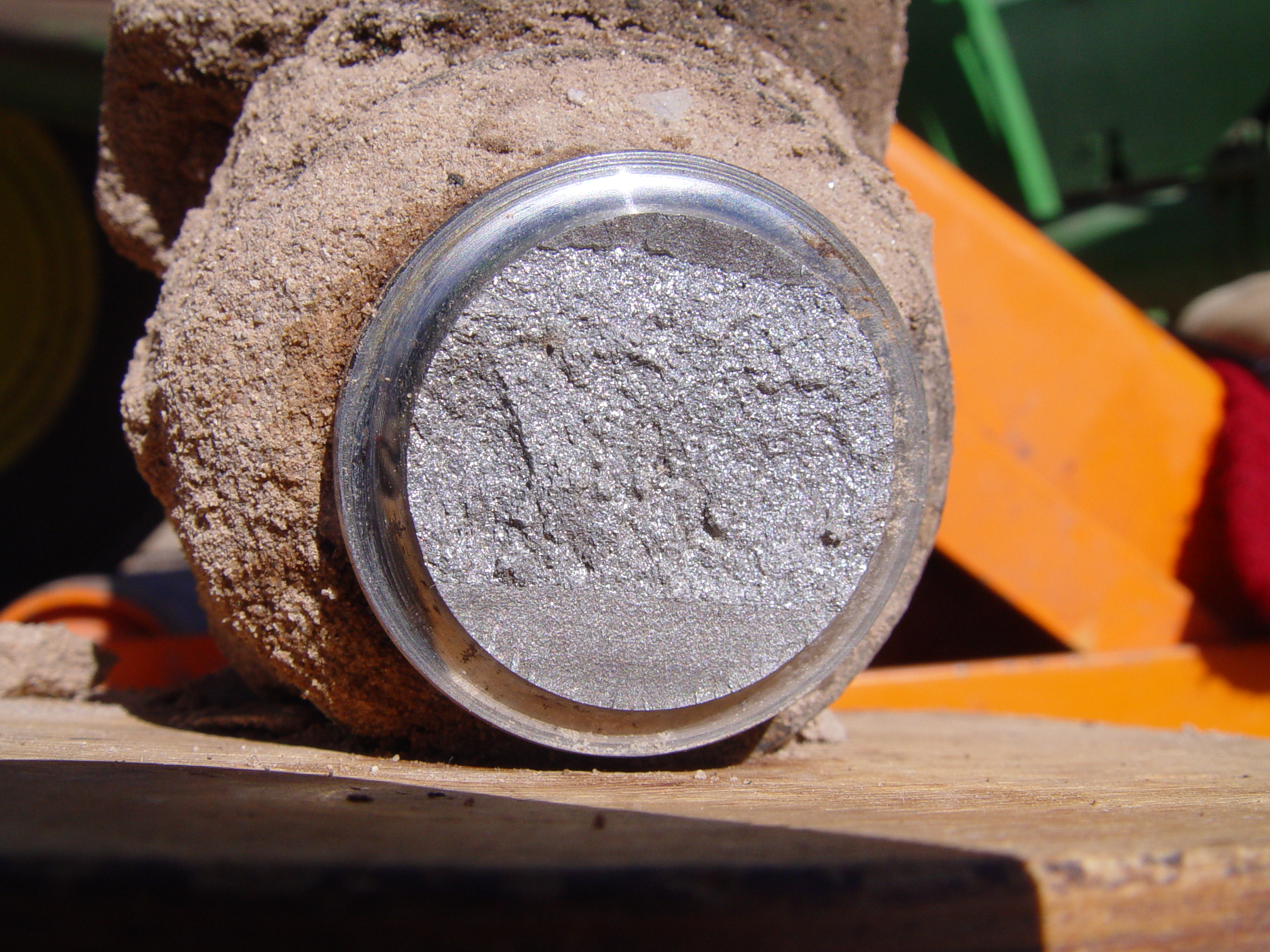

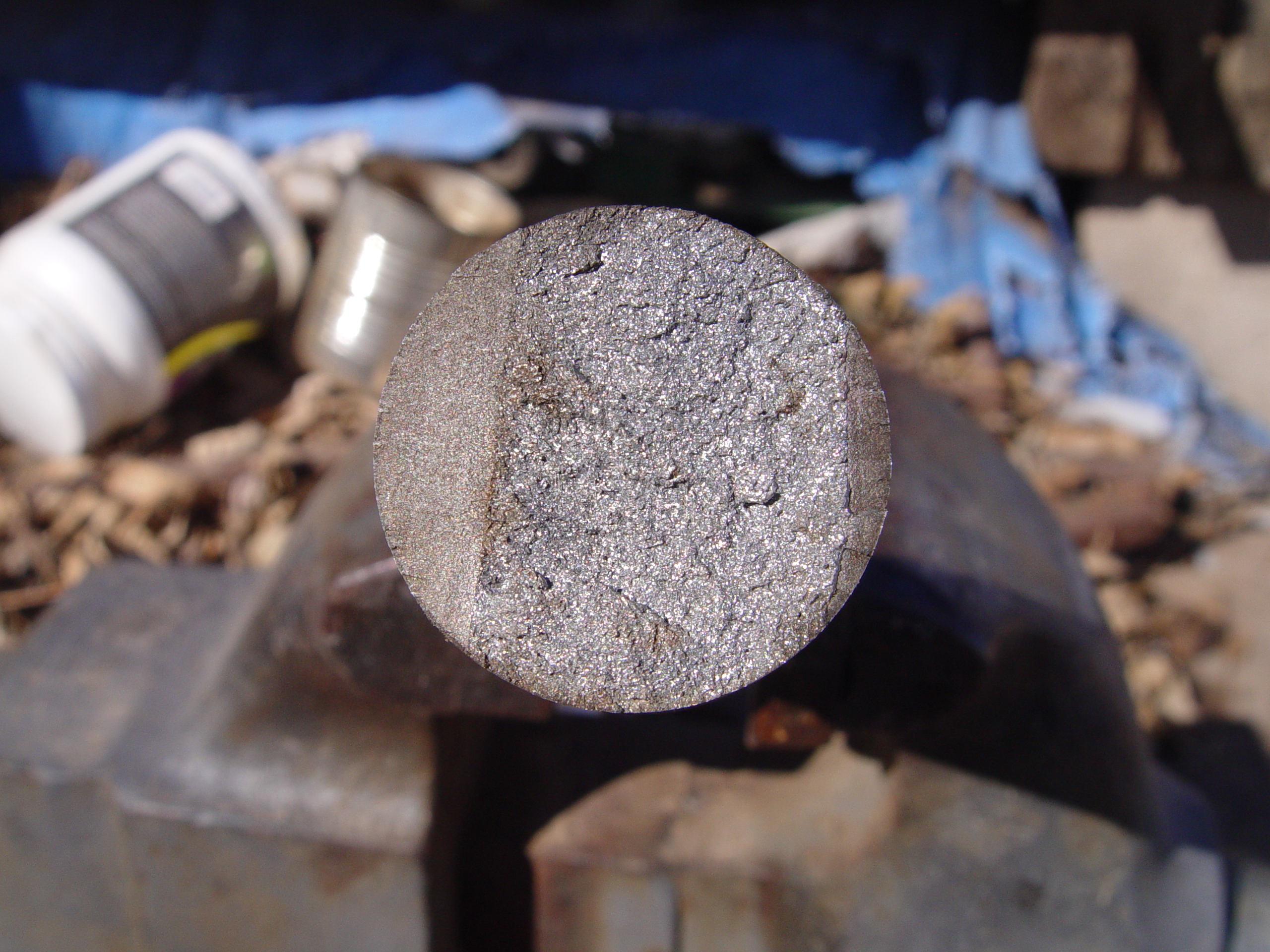

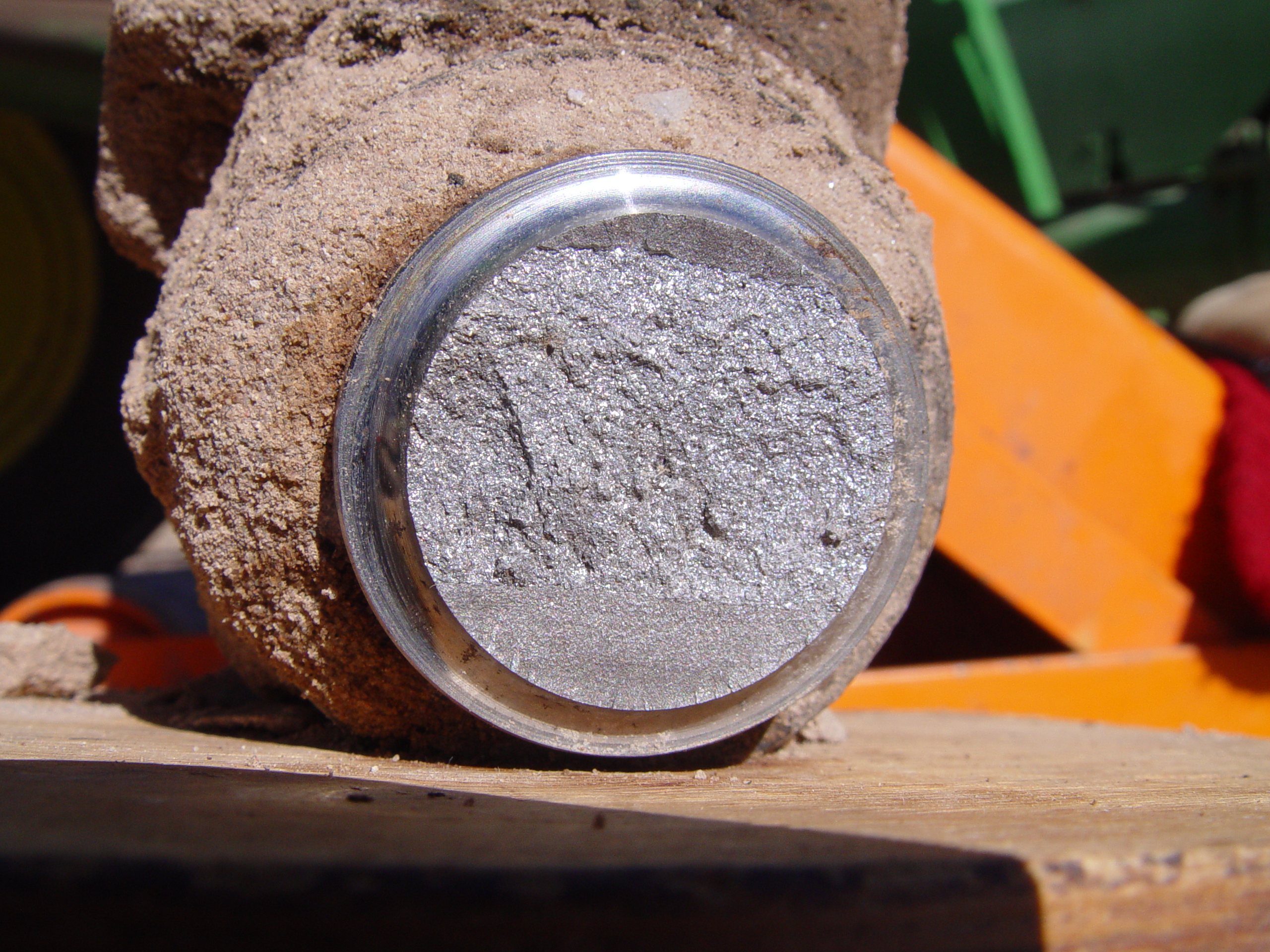

Attached are some better closeup pics of both sides of the spindle failure.
The spindle part that remained in the wheel was removed and i fit it against the other part that remained in the knee, and and although it wouldn't fit perfectly due to the interference of the wood block it was sitting on, my theory of a 'cut' is clearly wrong, as it seemed to fit almost perfectly with NO gap that a cut would have produced. Will check further when i get it out of the tractor.
I guess i don't know what vendor A&I you are refer to above? Is this A&I you are referring to:
The spindle part that remained in the wheel was removed and i fit it against the other part that remained in the knee, and and although it wouldn't fit perfectly due to the interference of the wood block it was sitting on, my theory of a 'cut' is clearly wrong, as it seemed to fit almost perfectly with NO gap that a cut would have produced. Will check further when i get it out of the tractor.View attachment 1709View attachment 1710

The break in your spindle is from stress or fatigue. Perhaps there was a weak spot in the material when it was made and that was the starting point, I seen a number of spindles, knuckles, and other parts with similar breaks. Without the added forces put on it by your loader use, it might have lasted for a lot more years. It is not a cut, a cut would show smoothsides or kerf lines not the texture of the metal seen in your pictures.

Thanks for your reply and your info on URLs of competitors.
Do you believe there is any evidence that substantiates the parts from A&I are better?
Your point on the kerf marks left by a saw, and the lack of any kerf space visible when i put the parts together is the reason i changed my thoughts on the spindle being sawed, or ground.
Thanks

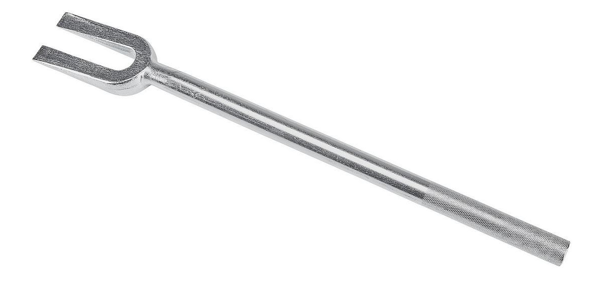

I have everything removed from the knuckle except the tie rod end and would like some clarification on how to remove it from the steering arm.
The OEM service manual says "unscrew retaining nuts part way and use a tie rod tool to pry ball joints loose from steering bell crank and steering arm...".
Is this what the manual is referring to?
If so it seems like inserting it between the ball joint and the steering arm might damage some of the ball joint, or is that wrong? I have a tool like this if that is what is needed.
Also a video for a JD 2030 @ 9:17 min shows a different method of hitting the side of the steering arm while prying down on the tie rod. That seems kind of brute force technique, or is that acceptable?
attached is a pic of the steering arm.
A little remedial instruction would be appreciated.
A little bit of both of those techniques is often used I just have a harbor freight set of those for a hammer. There’s a similar device for an air hammer that costs more. That also works well. It’s best to have a ball joint around if you are this far anyway but sometimes if it’s tight you can save it. Vibration from air hammer with fat flat end somewhere not visible on the part of the spindle. In this case that’s broke so have at it
View attachment 1615View attachment 1616View attachment 1617
Regards,
d page
Unless your married to that tractor, and if you say failure of spindle could result in injury or death, I would get a construction type tractor with heavy duty front end.
Yes that knee will probably come out with some work. One thing to add is if you think you will be taking both the tie rod and the arm off the spindle do it while it’s somewhat together at least knock it loose. As in separate tie rod separate arm. Pull knee remove spindle in that order. If you hit tie rod much in any manner including with nut on it consider a new one.
