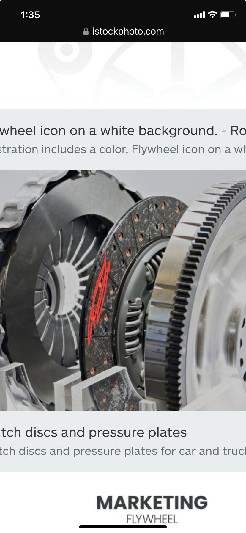

Thanks for the additional description and details. Maybe Bob will be back give more information about his method. Likely under the tractor at the back of the engine which is right behind the oil pan that you drain the oil out to change it there may be a cover there or just a thin opening as he described it. It sounds like what he has done is to force a thin blade like a putty knife in there to release the stuck clutch. The middle part I put the red on in the “generic” clutch photo is the “lined” clutch plate. You are going to try to separate it from the metal plates or surfaces each sides of it. When doing this you will want the clutch pedal blocked or held pushed down by some method. Work one area and then bump the starter to turn the engine to another position to work it loose there repeat. Also just FYI, in technical terms which we like to use here a lot, when a clutch pedal is pushed down that disengages the clutch. The action of the part is used for the terminology, when you push the pedal the clutch stops or disengages rotary drive motion to the transmission. Thus clutch pushed down is disengaged.
