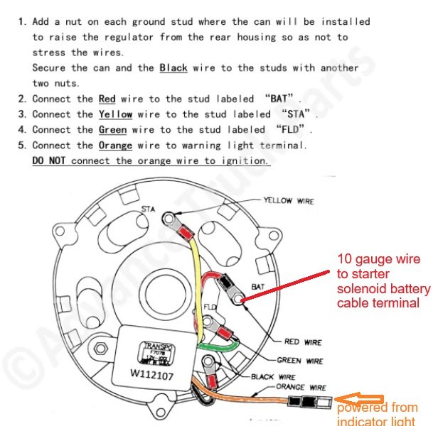

It has a Ford three wire alternator with a Transpo f7078 voltage regulator/one wire converter. The regulator is hooked up properly, BK to ground, RD to BAT, GN to FLD, and YW to STA. The alternator will not charge unless I spark FLD to BAT. Then it charges fine - 14V at the battery terminals. When I turn the tractor off, it returns to not charging - the polarization does not stay.
I added an indicator light by wiring + to switch, to light (26 ohms), to the OR wire on the regulator. When the switch is turned on, the light illuminates. When the tractor is started, it stays on, the alternator is not charging. With the light on I have zero volts from FLD to ground. When I spark FLD to BAT the light goes out and charging begins.

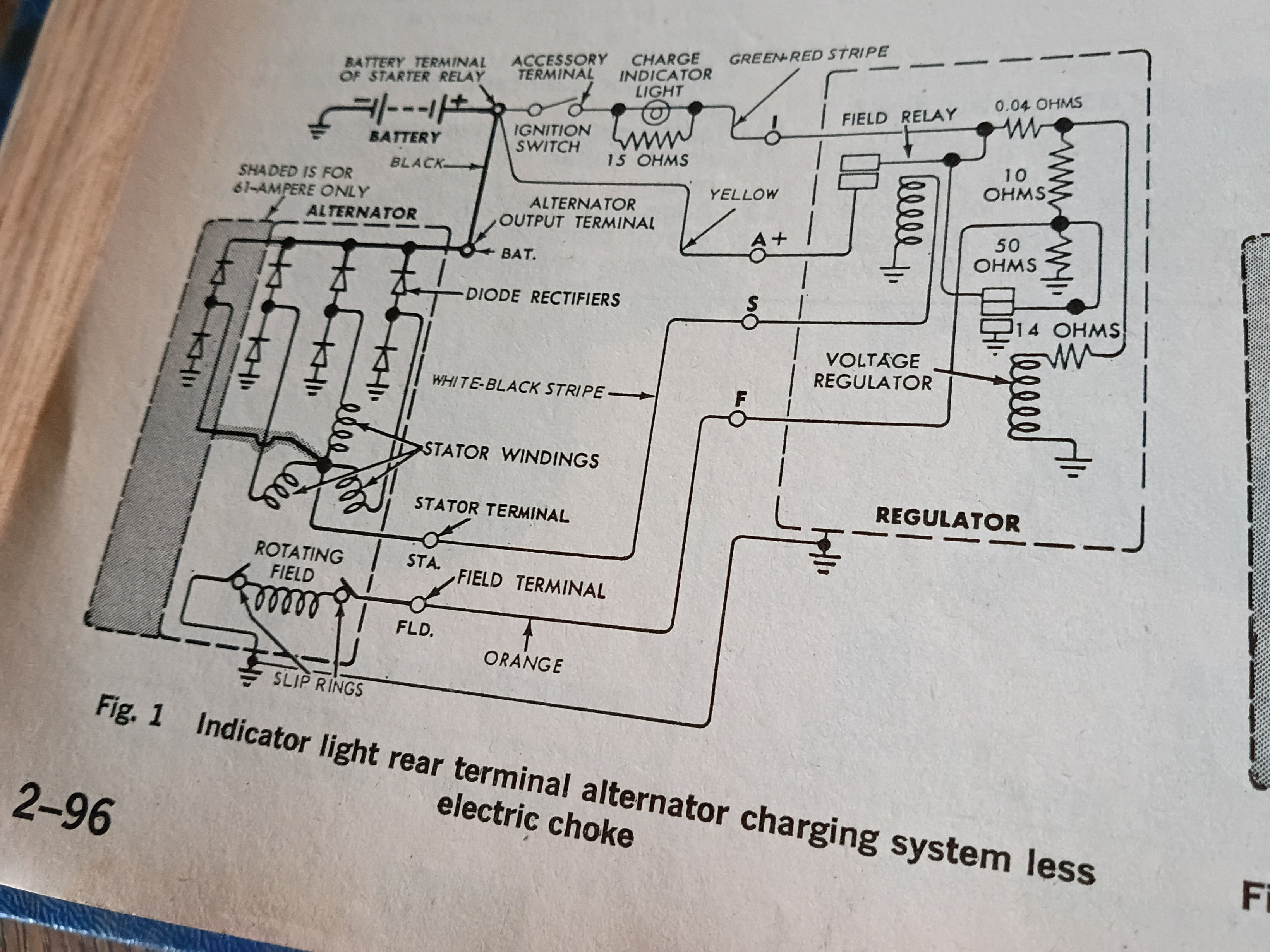

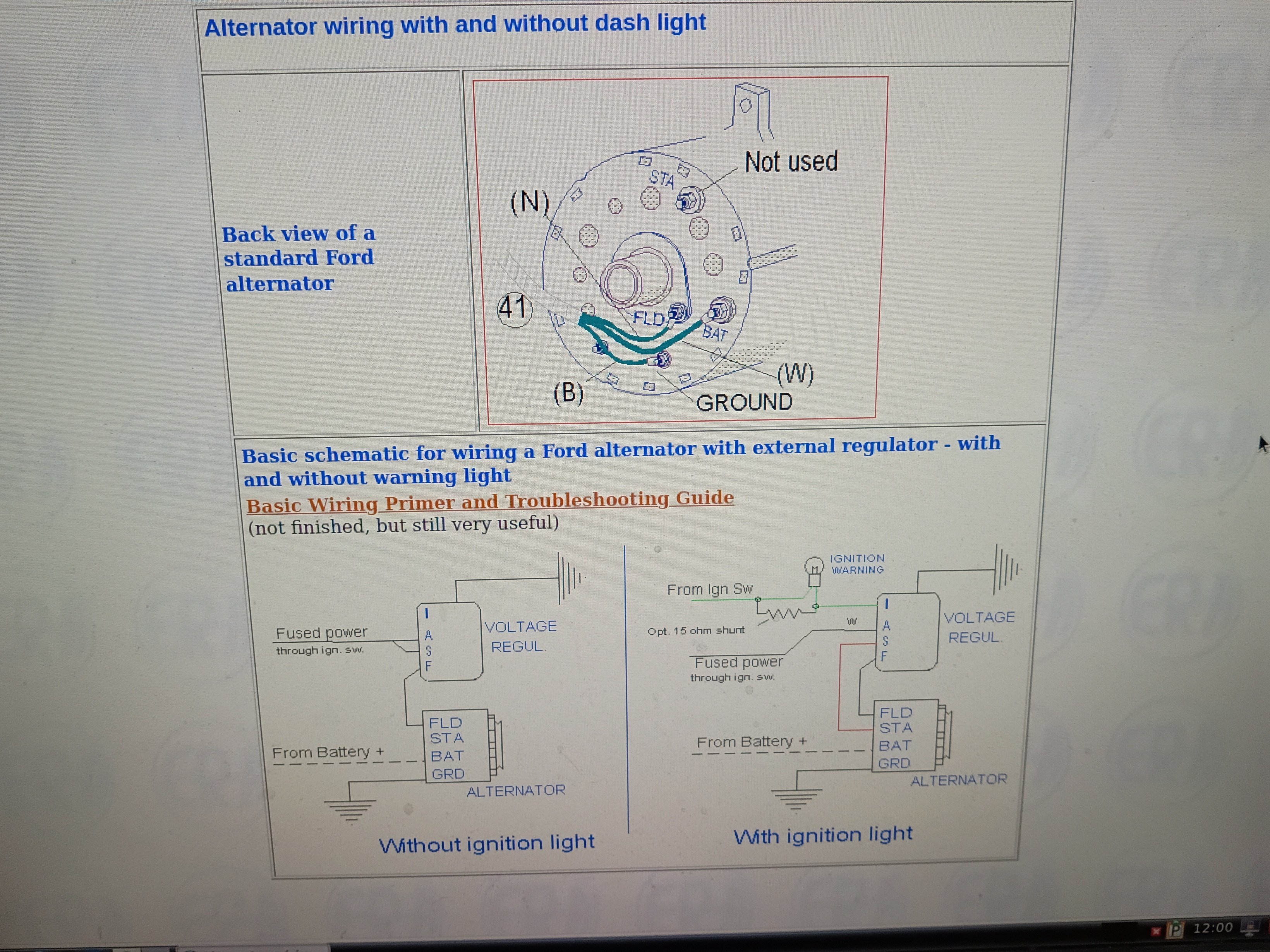

This drawing should match how you have the alternator wired currently as I read your post.
Good point. He should tell us what the bulb in his indicator light is. If he used an LED it won't work, at least I have not had any luck using an LED indicator light for such applications.
It is an incandescent lamp, sealed unit so not sure of the wattage but it measures 26 ohms, I thought about needing more resistance so I tried it with two lamps in series. Is it possible that even 52 ohms is not enough?

Two should have provide enough resistance. You may have a bad regulator/one wire converter.
My personal choice would be to replace it with a Delco 10SI, three wire (or one wire). Easily found replacements if there are issues. With the 1G "Ford" you are always going to be dealing with an external regulator as well as the alternator. Again, just my choice, others are free to choose for themselves.
Have you tried over 2000RPM. If nothing else works a Ford electronic voltage regulator would be easy enough for me to figure out.
Warning light, no warning light , Too small an amp draw and warning light bulb may not be a factor in getting Transpo F7078 to excite to start charging.
I would try a quick blip to at least 2000 RPM and see if it kicks in.

Pigtail for regulator, Wells #1P1131. If F7078 doesn't work out in the end. The yellow A+ wire connects near the battery to battery +. This is remote sense wire. Connecting near the battery gives best results over long term. To excite alternator 194 bulb or equivalent .Do you really need want the idiot light ? There are other ways to excite alternator. Post back if you get F7078 working and how . Thanks
