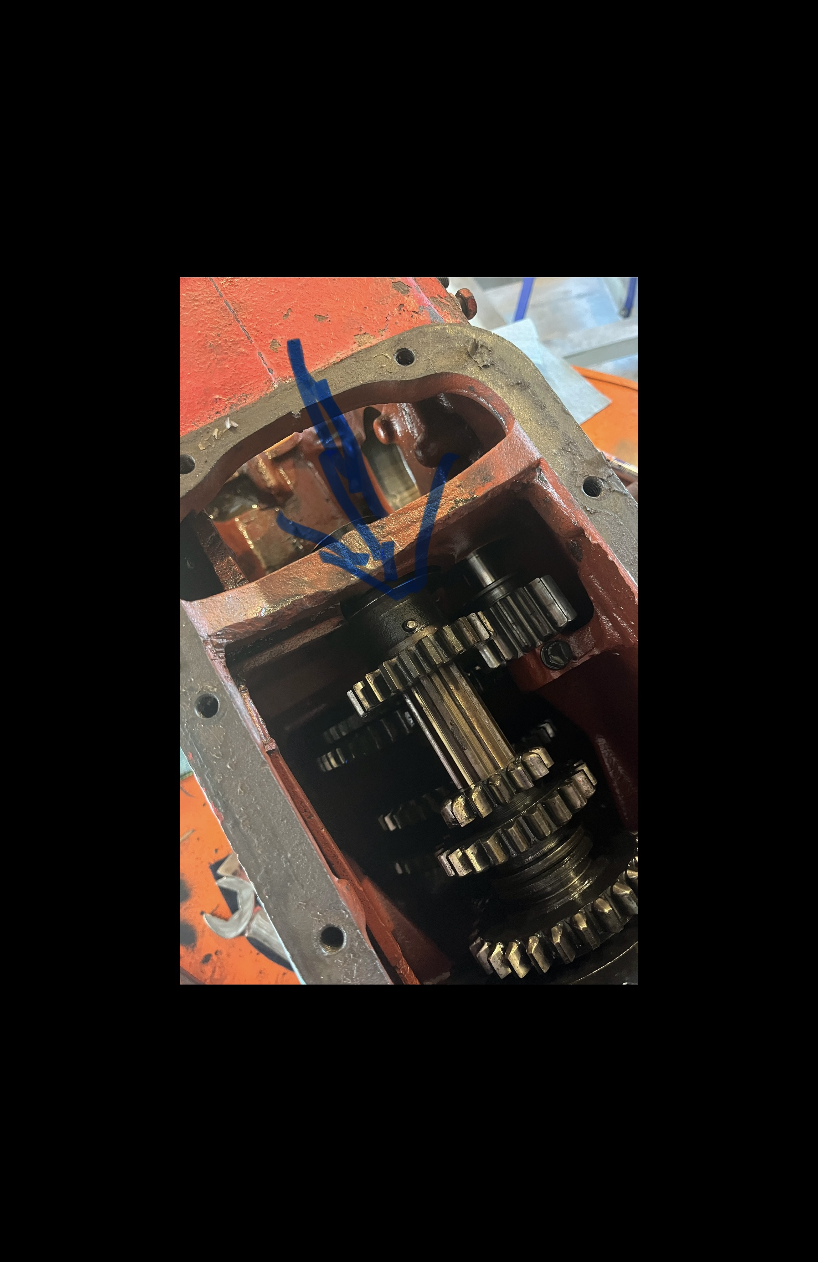

I got the reverse pin out I ground the top off and drove it through now I am ready to reassemble the transmission. Are those pins available if not what would be good to put back there Thanks for the help
I got the reverse pin out I ground the top off and drove it through now I am ready to reassemble the transmission. Are those pins available if not what would be good to put back there Thanks for the helpView attachment 64564
the Pin.
I found the real rivet at Bates, see link. If not there, measure the pin and duplicate it from McMasters Carr, or a hardware store. Fit to pin bore is critical, so small is not good.
