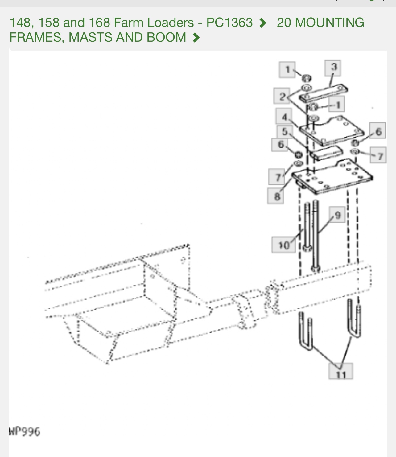

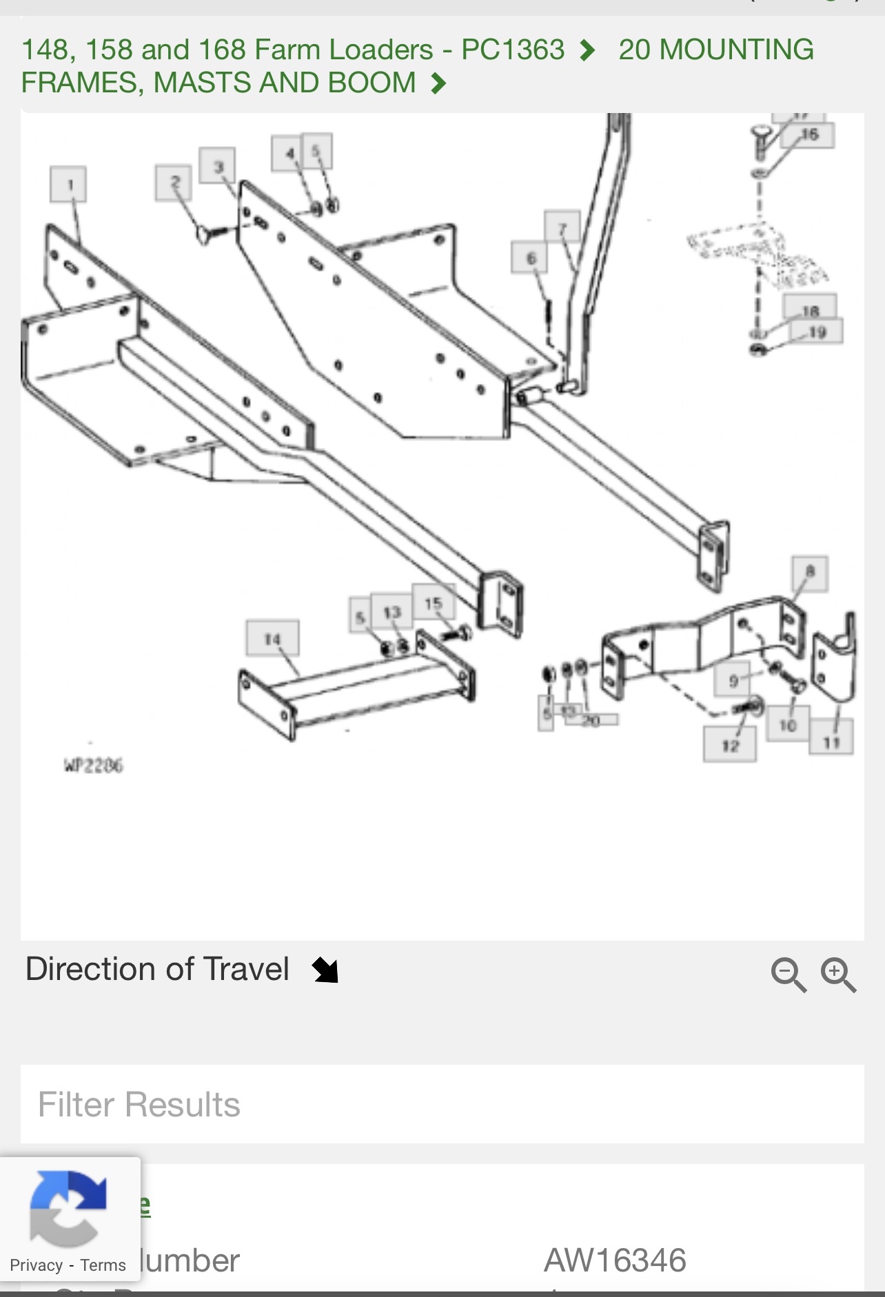

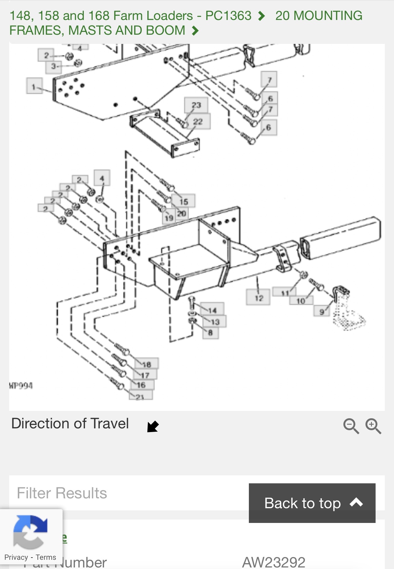

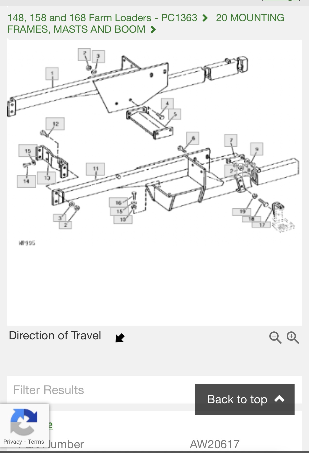

I recently purchased a 148 loader for my 2955. The loader came with the shorter frame to mount it on a row crop tractor. Trying to find a utility tractor mount or if anyone has modified a mount to attach to the rear axle. Any help is appreciated!

Make sure the loader mounts go back to the rear axle these models with 6 cylinders must have full length loader mounts or you take a big chance of breaking the frame of the tractor in the bell hsg. area
I’m trying to locate a set now. Hard to find! If I don’t find a set I’ll modify the short set I have now to make them connectors the rear axle.
Thanks!
