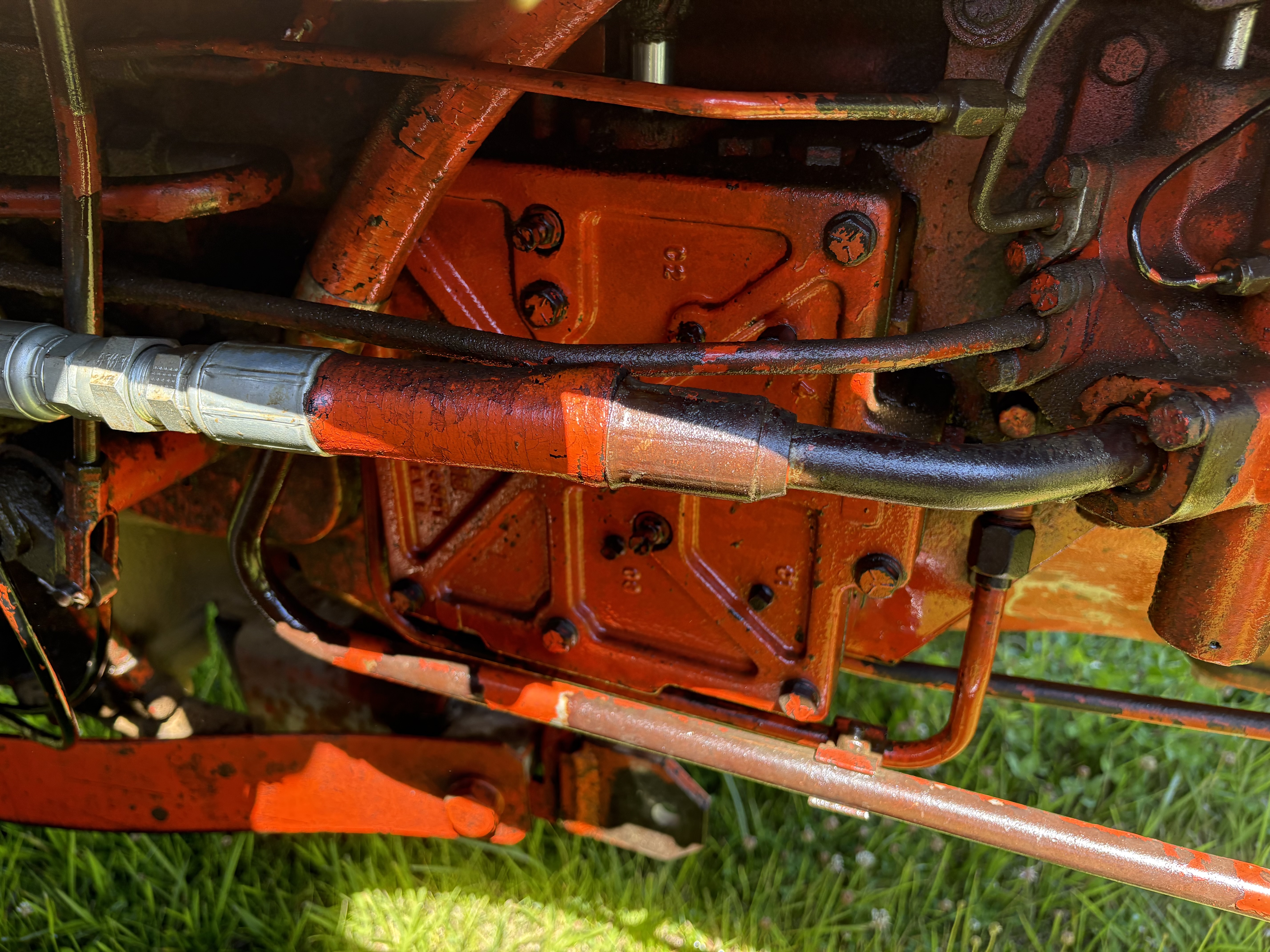

Halfway during planting my 1570 blew the main charge line under platform, left side of tractor. Case says the line is no longer supported and no aftermarket. See if someone here has one. It’s the line with the 2 bolt flange and flat face with o ring.Thanks and post back if you do.

The Case dealer should have mentioned to use a compression fitting for that line. It will be close but cut the steel line as far back as you can and make a new short hose. If you have an industrial hose fitting place they might have a two bolt flat face end also if the compression one doesn't work. Is any of the steel pipe behind the oring flange straight, or does it all curve? Can't quite tell by the photo. Found out about the compression fitting years ago by the CaseIH dealer that also couldn't get an old hose. But just recently seen our industrial place had them and has for quite a while. If all else fails, you could braze a fitting to the two bolt flange end, Farmall guys have been doing that for a while, slide the cutoff tube down inside of a male JIC and braze together.
Here is how I would repair the hose. I would identify the hose size and then look for a ferrule that would fit a replacement hose and the steel line. I would then VERY carefully grind off the ferrule on the steel line making certain I do not cut or damage the steel line in any way; other than removing the ferrule part of the original steel line assembly.
I would then be able to make a new hose using the original steel line, a ferrule, a piece of new hose and a new fitting on the other end; which in this case looks like a JIC fitting.
