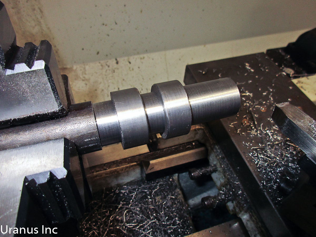

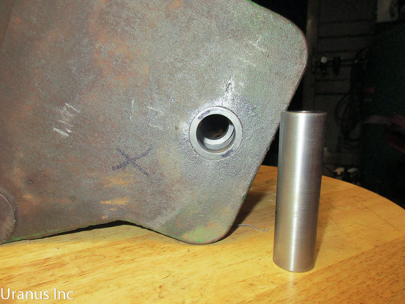

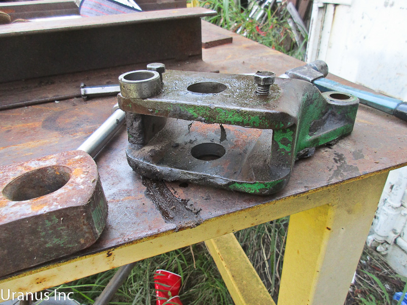

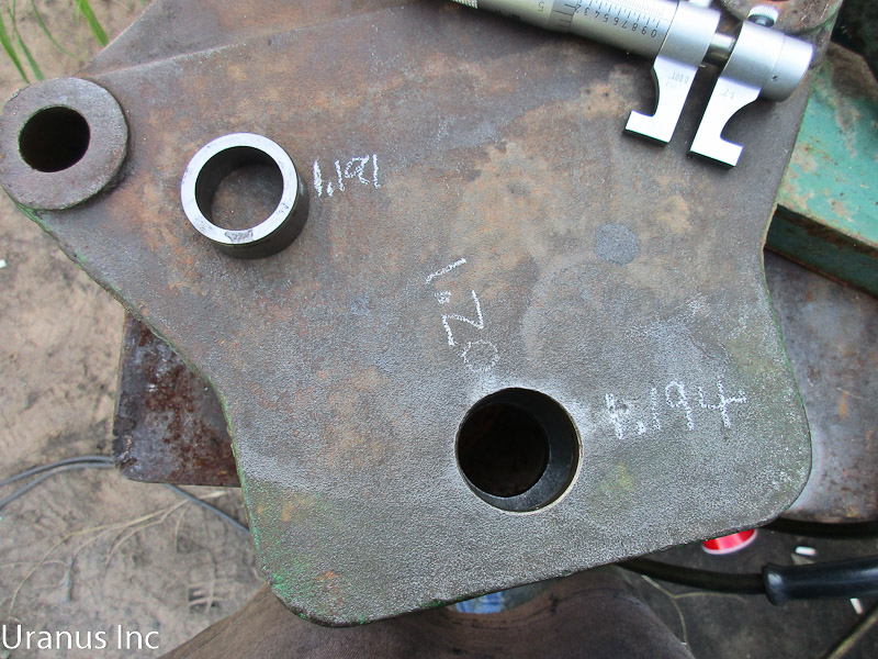

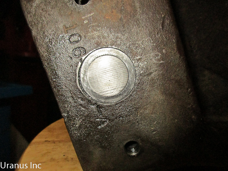

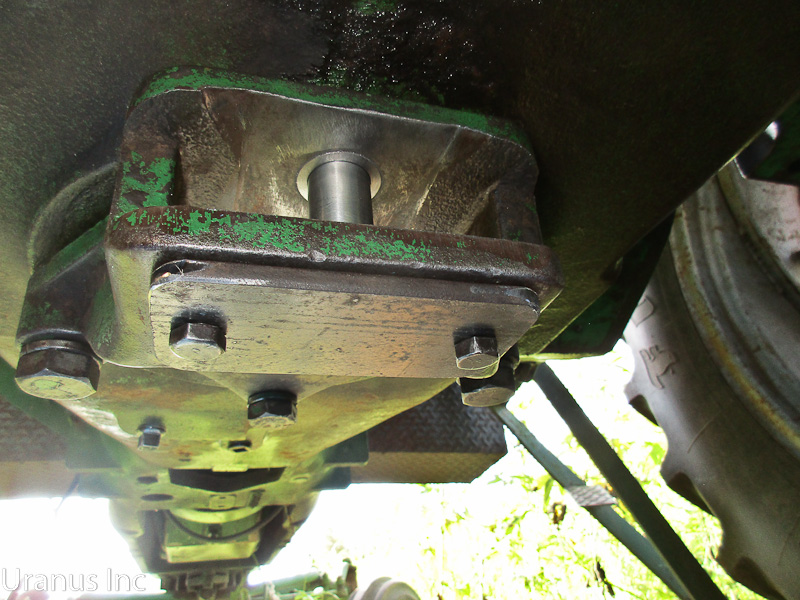

I had to rebuild the drawbar pin underneath the transmission. The one that the drawbar attaches to in front.
The hole was slightly egg shaped, but I couldn't get a boring bar completely through it to line bore it on the mill.
The pin sits in the sleeves/bushings you see here.
Luckily, the bores weren't too far out.
I like Loctite Retaining Compounds. I was able to fill in the few thou with Loctite 660. Very good stuff for large gaps.
Made a new retainer plate, and installed it. Been quite a few years without any problems.

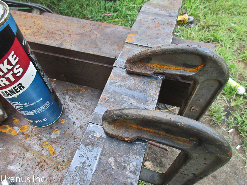

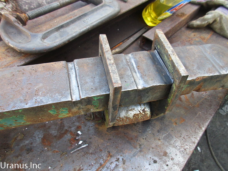

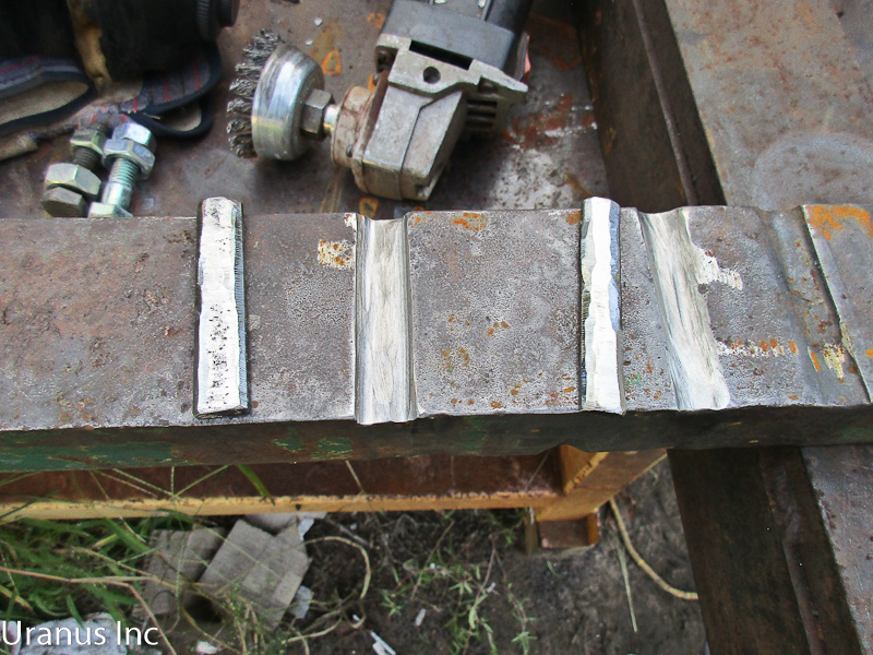

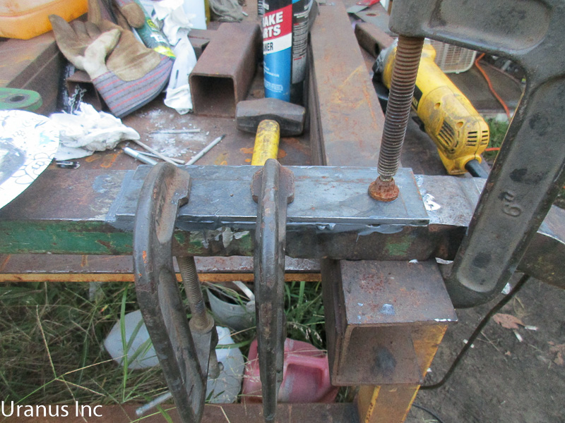

NOW TO THE DRAWBAR.........................
These drawbars hang on a bracket. The bracket cut grooves in the bar over 50 some years.
Rather than fill the grooves with weld, I cut them square, and filled them with matching mild steel pieces.
Standard 2 part epoxy. The tops were then ground flush.
And, a cover plate epoxied over the fillers.
All of this was done to avoid welding on the drawbar. I have the full procedure for making a new hangar if you need it, or are interested.
