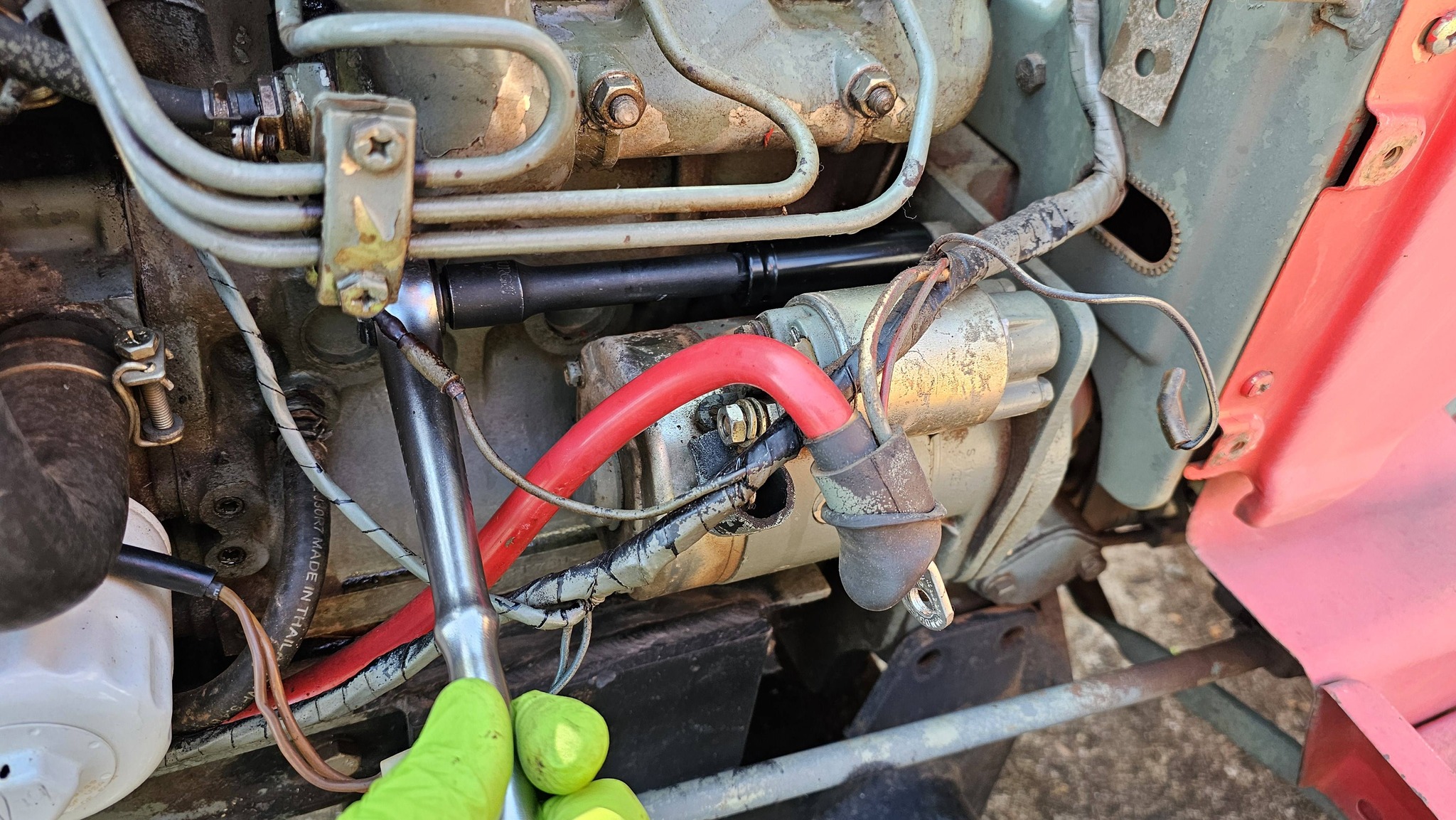

My tractor has unusual starting issues. With a brand new 700 CCA battery, and thouroughlly cleaned (sandpaper) terminals and mounting surfaces, it just won't even try to bump over most of the time. Sometimes it will turn over and starts, though it sounds like soemthing is maybe lightly rubbing maybe in the starter. It's a faint noise so I'm not 100% sure what I'm hearing.
It has 1/0 battery cable with high quality terminals that were lead-soldered then shrinkwrapped.
What could that almost mechanical sounding noise be.. do starters ever go bad in these old 3 cyl diesels?

If the YM1601D has the original starter, think about it, the starter is over 40 years old. Nothing lasts forever.
Lucky me, I found a new replacement starter in my box of spares, bought it in 2019, $321 per receipt. I used to buy up common parts like that just to have on hand.

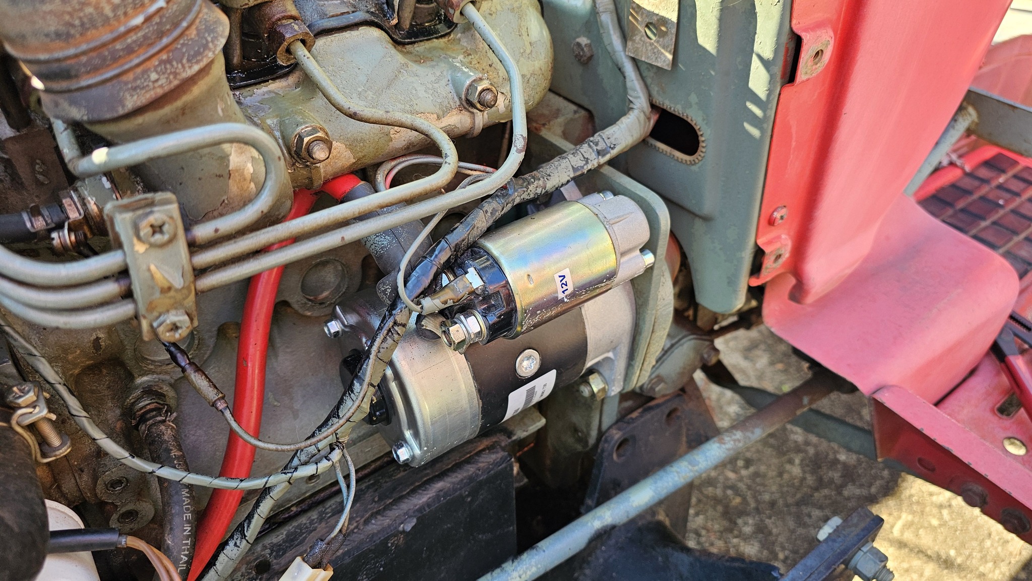

The new starter helped a bit. Still have a remaining issue of when engaging the stater at the keyswitch, sometimes nothing happens. If I re-engage the switch a couple times it eventually bumps off (much faster now with the new starter)

The mystery deepens.
I used the tractor for a couple hours yesterday moving mulch. Turned it off at least a half dozen times, it started okay, sometimes iwth the "turn switch twice" technique mentioned abouve.
Today I start it up to let it get warm for an oil change.
Changed oil. Did not touch a single electric part or wire.
got new oil and filter in place and started the tractor to get it flowing, and then turned it off to check oil level
added a touch more
started again
and the starter motor would not stop. The gear wasn't engaged to it was just spinning freely. It startled me a little. Quickly disconnected battery positive.
The blade connector on top tells the gear to engage the flywheel, so disconnecting it didn't do anything
I then removed the access panel to check for vermin or any frayed wires, found none. Documented where each wire goes on my switch, then removed the switch.
Put termal back to battery, and immediately the starter motor starts to spin again.
Never seen this happen before. It's a brand new starter. No wire damage or corrosion anywhere that I can see.
Any ideas on what could cause this?

OK, I would assume you still have the original starter.
Swap the original starter back in and see if it runs-on as well.
If not, then the new starter is faulty.
If it does spin non-stop like the newer one, there is a possible short in the ignition or the VR.

Wait, in the video you have the terminal connections removed from the ignition switch? Then the VR will not flow the circuit and the starter will run-on.
Also, those terminals look corroded to me.
The old starter does not have the same behavior. Even off the tractor the new starter spins when I apply power to the positive lug.

It sounds like the contacts, inside the solenoid, for the motor welded themselves together. The pull in coil moves the drive into the ring gear and pushes a disc into the contacts for the battery cable and starter motor studs inside the solenoid. Since the drive is dropping out of the ring gear, it appears the pull in coil is releasing, so it is unlikely to be the switch.
A new solenoid may fix it.
