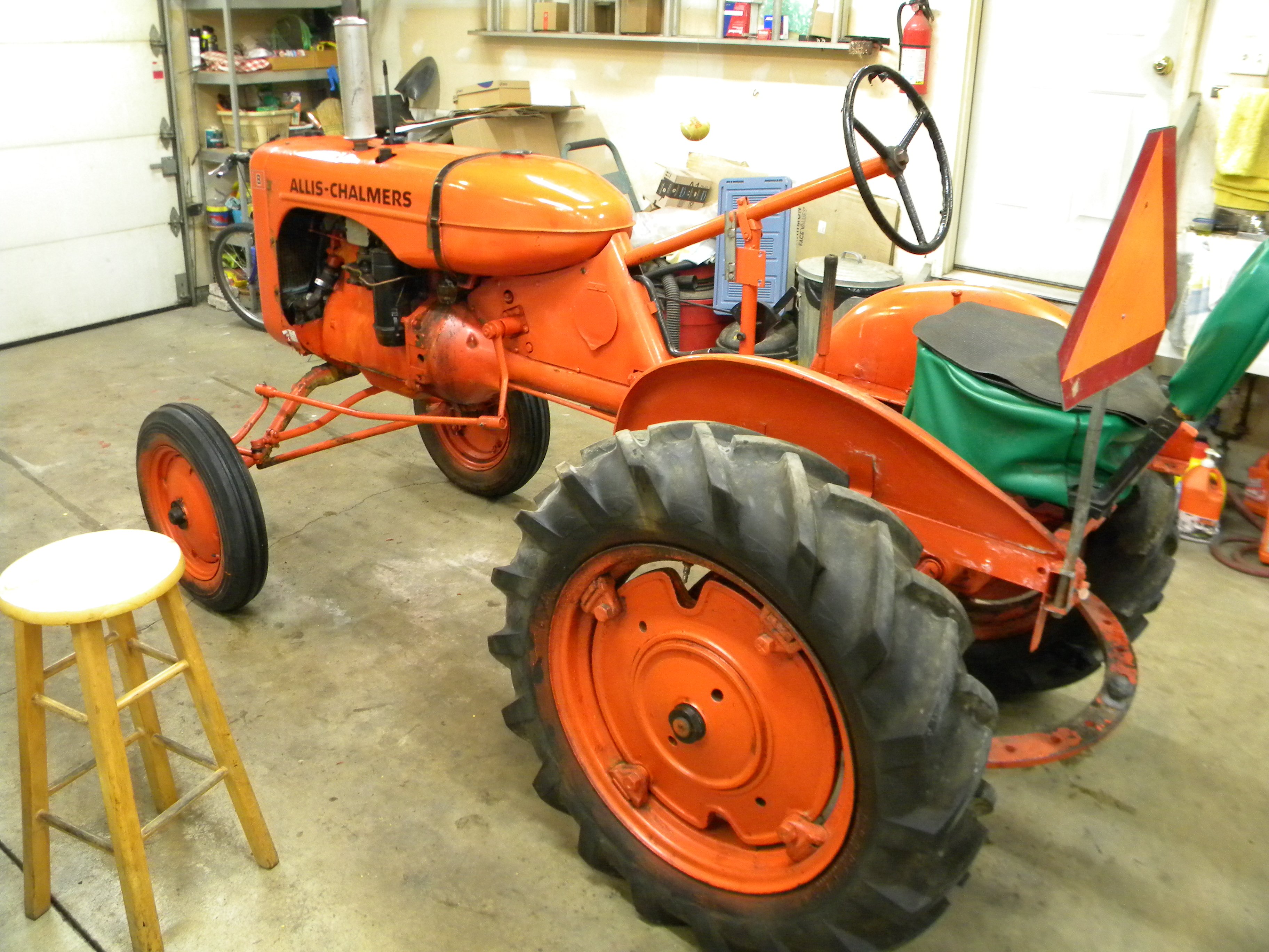

Motor not stuck, got motor to turn over. @ what time do I need or do not need compression test & what number should I have.
Thanks for Your time !
get it running then check the compression. checking it on a sitting engine is not real accurate but still tells you if you have enough to start it, or will show if valves are stuck with next to 0 zero compression. should have at least 100 psi. warm engine at cranking speed with 5 puff's per cylinder. readings should be within 10 percent difference. did you find the engine serial number ?

I am still in la-la land for the hunt of engine #. I would like an exact pic. of where it might be! Like a copy that shows #s
Thanks
Did you read through the old thread I linked for you the other day? It has some pictures.

100 PSI seems exceptionally high for an engine that is hand-cranked like my '38 was. Further, the advertised compression ratio for the BE engine was 4.92:1 when new. Presuming that there is absolutely NO ring or valve leakage, no valve timing irregularities, and a perfect 14.696 PSIA at sea level, the theoretical maximum would be 72.3 PSI.
Mine was S/N 2527, with a crank and a Fairbanks FMJ mag. Whether bent stick or battery, the compression ratio was the same.

Found the # 20 on top of sterring gear box.
Got a allis B Book today!
Got carb & semiat old small bowl off & cleaning.

Did not check yet, still cleaning carb, sediment bowl, gas line & gas tank.
Next week hope & pray we get started & running. Then check compression. Hope were above #70.
